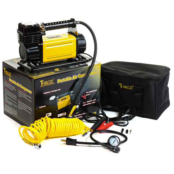

This is what I have, https://www.jgs4x4.co.uk/t-max-12v-air-compressor-heavy-duty-portable-tyre-inflator-adventurer/
The main reason I have it is to pump up Clark SCAM (self contained army mast) telescopic masts in about 1.5 - 2 minutes the ciggy lighter toys take 20-30 minutes and die

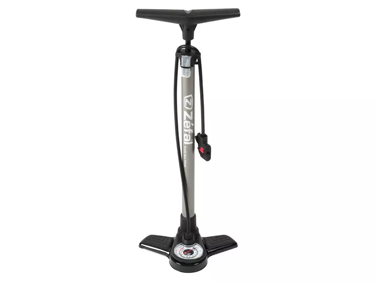

I agree, it only takes a minute with a hand pump. Out of curiosity, a few weeks ago I tried one of those bike pumps where you stand on the base and operate with two hands - to blow up a car tyre. It was perfectly doable.
Sounds like a track pump
Yes I have a couple and generally use one to check the cars tyres. They are every bit as good as a footpump as long as your back can cope.
Good grief! My car one claims to be 6A (at 12V) and I think all the car ones are designed to be plugged into the ciggy socket, which is usually/often fused at 10A. How do you power your 45A one?
Kind Regards, John
Leisure battery or the circuit I've installed in the boot.
EDIT: The 'proper' compressor for the SCAM mast from Clark is a low pressure (25PSI) 2 cylinger V compressor belt driven by a 450W motor, either 12V or 240V versions. but it takes twice as long to inflate a mast. Not only that; it's about 4-6 times the size and ****ng heavy, definitely a 2 hand lift and for some a 2 man lift as opposed to carrying a T-Max in one hand and 80AH leisure battery in the other.
That's the one, surprising quick to pump a tyre up - not that I needed to use it, I have a mains compressor in the garage :cool:

I have never owned a ciggy lighter powered inflator, I find the track pump from earlier or a foot pump is less hassle and quicker, For once-in-a-blue-moon pumping up of one car tyre I've not yet worked out why one would bother with an electric device. My T-Max is just inside the door at the end of the drive, as is a track pump and I automatically go for the track pump.

Getting back to my comment, many of the ciggy lighter inflators are more than the 10A rating of the sockets and the usual size of fuse.

Yeah but have you measured it?
No, I haven't measured it. However, I have run it for quite long periods (for purposes other than pumping up a car tyre) from my car's ciggie socket without it having blown the fuse (which I now to be 10A).
My experience is they are sometimes higher than spec'd.
