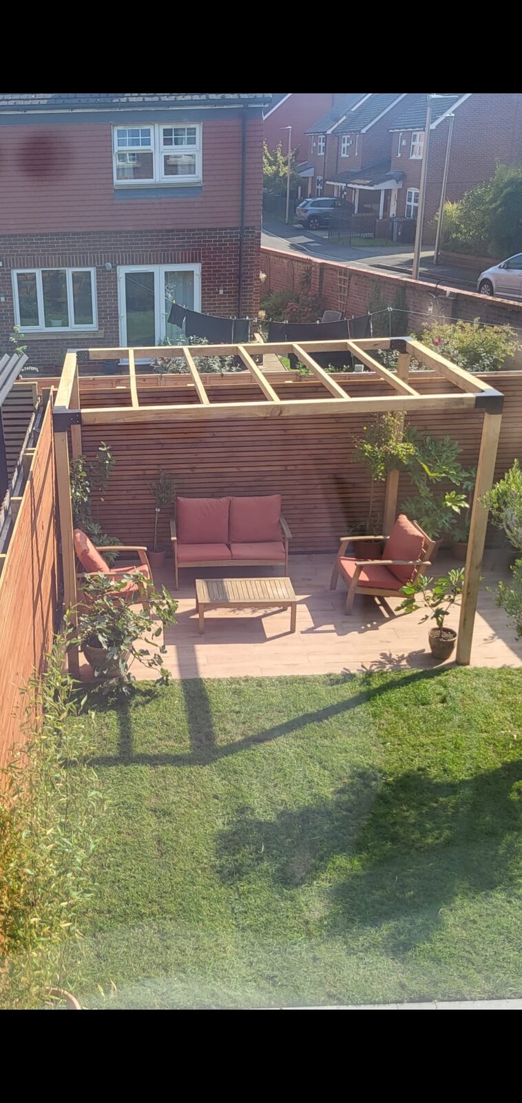

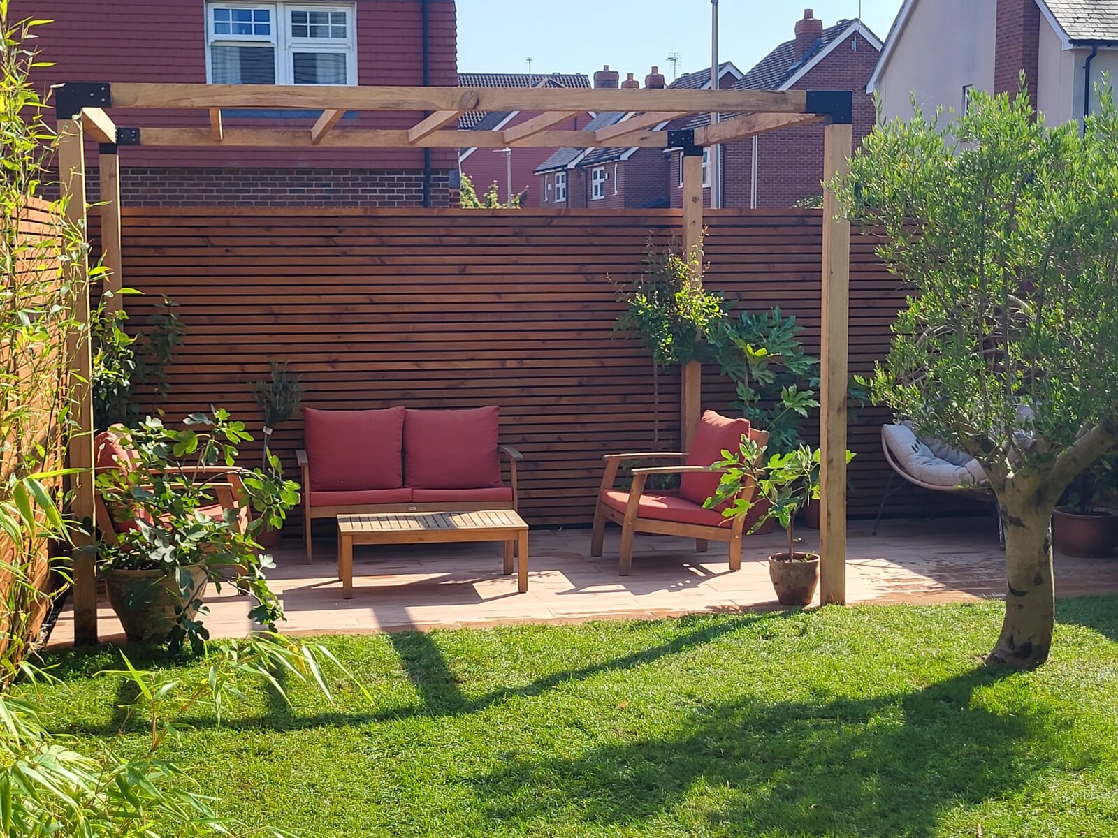

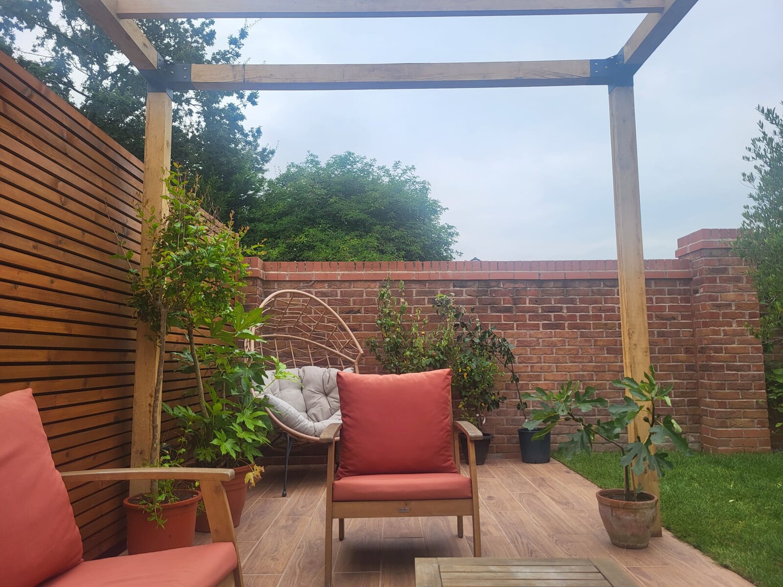

Hi, I am hoping someone can advise. I've put a patio and pergola at the bottom of our garden and wanted to install a glass roof. We've spoken to our local glass supplier and they've advised using aluminium glazing rafters. But I'm not sure this will look that great from the front or from the sides, if we use the end profile straps. I can't find any company that will provide/install a seamless/frameless solution. Does anyone else have any ideas how we could install a glass roof whilst keeping the look seamless and modern?
I did think about using stainless balustrade brackets, but I would have to adapt these to suit, and my Wife isn't keen on that option either.
Would be great to hear anyone else's recommendations or if there's a company that provide a solution. I've attached some pics, for a visual.
The pergola is Oak and the outside is 100mm x 100mm and rafters are 75mm x 50mm.
Cheers
Rich

if you use 40mm capex, it will only be the width of the rafters so you wont see it from below
you dont need the end caps, just fill the end with silicone and cut off flush after
seamless solutions involve structural silicone glazing, not a realistic option on a timber structure
Does it even have a fall on it, doesn't look like you've designed a fall into it because glazing it was an after thought but water will pool in the middle with the bow of the glass, laminated glass assuming that's what your thinking off(I would) will be quite heavy

fair point, I guess it could have some firrings added....

Hey Notch, I think this is what we may go for. Appreciate the reply. Thanks.
Yeah, the glazing was an after thought, but we've not secured the corner brackets yet, so fall can be incorporated.
You can put a wooden frame round the perimeter. Fascia board?
Pergolas are usually timber so this will be in keeping.
Where are you putting the gutters and downpipes?
How will you clean off the dead leaves and dirt?
Clear polycarbonate roof is much lighter and easier to fit .?
Yeah, we did think about poly carb, the only thought was it wouldn't look as good as glass so to speak. But you are right, it would be much easier to fit. I tell you what though, that stuffs as expensive as glass. Literally £50 difference in it.
