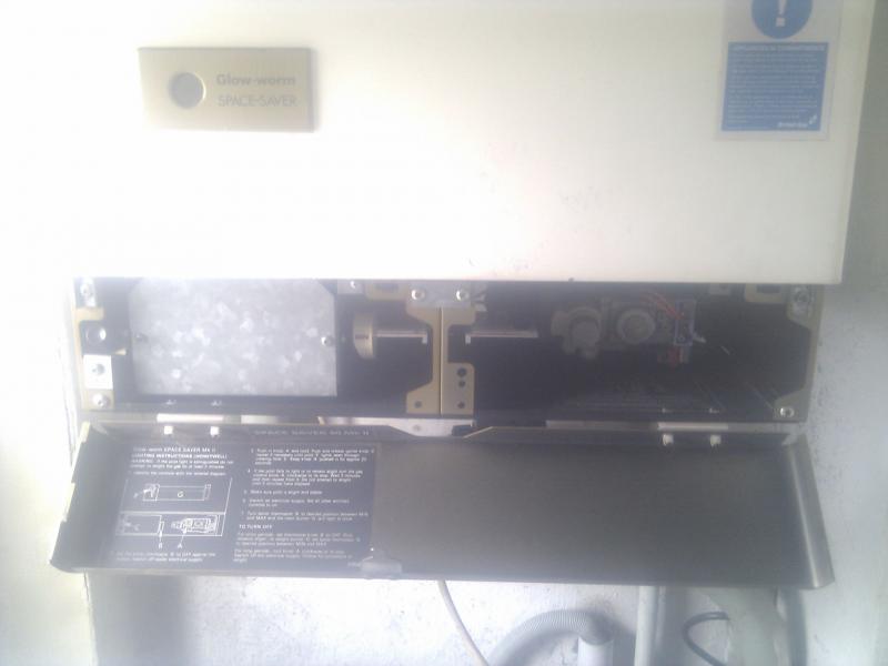

Glow Worm boiler fires up but no heating

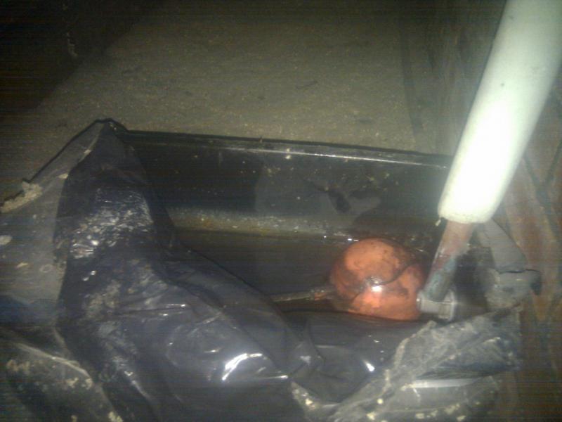

Nothing much to report from the loft. Small tank with float valve. I couldn't spot anything which may be causing the problem.
regarding the tank in loft the vent pipe is right on top of overflow pipe outlet
and judging by the tide mark on the ball the water was going up the vent and splashing on the overflow pipe
Depending on type of valve and problem and your skill level it could be DIY able. May be possible to override the valve motor to get heating as a temporary measure. Is the hot water heating up ok using the boiler? (Not an immersion!)
Hot water is a separate boiler so no problems there. The Glow Worm boiler is central heating only.
are you sure your not mistaking the hot water cylinder for the hot water boiler take a photo for us
