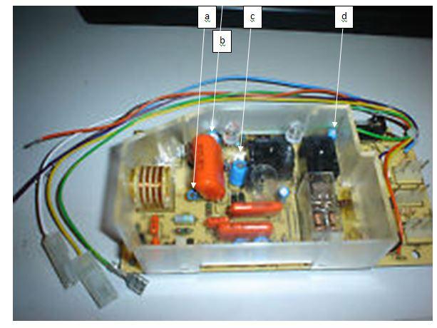

Hi All,
I have been experiencing strange behaviour of my boiler.
After few hours of idle it starts buzzing.

Identical symptoms in my 50FF pcb.
Saw a couple of capacitors looking a bit "old". One with bulge, one discoloured. Replaced both to no effect on the buzz. Then replaced the relay with identical one. For three days, the boiler worked without any buzz and I felt very pleased. Whilst putting it all back I may have accidentally turned the thermostat down slightly. I recalled that the boilermate tank I have requires the thermostat to be on full, so I turned it up to max. Within the hour the buzz returned and I'm back to turning off at night.
Now I might just replace the relay again, hoping, but if anyone knows what else might damage the relay I'd be very interested.
Did you replace the smoothing capacitor on the PCB?

I replaced any suspect capacitors. If the smoothing capacitor is the one nearest the relay then no I didn't replace it as it looks OK. However I will do it as well. I take it the smoothing capacitor is the nearest?

It would usually be larger and probably over 300 uF.
But the capacity needs to be measured! You cannot decide if a cap is OK without measuring the capacity.
They have a rated life of only about 2000 hours in most cases!

Agile, you say "Without seeing the PCB I don't know!"
Any chance you can see it in the pic? a,b,c, or d or another?. The biggest Barrel Capac is 100uF.

Has the 100 uF cap been changed?
But it may not be the main smoothing cap. If we knew what was buzzing then that would help to identify the fault!
The relay next to cap d in the pic is the one buzzing. It only buzzes when the boiler has been idle for a while e.g. during night. I haven't replaced the 100uF caps (3 of them) yet, though have ordered some. In fact when they arrive and I fit these three I will have replaced all the caps. It'll be 5 days or so before I know if it was the capacitor! Sods Law says it'll be the last capacitor that is faulty.
The 100uF caps arrived today. Relay buzzing merrily away when I got in from work.
Replaced all 3, turned the power back on, and not even a single buzz.
Eerie silence! It's golden!
Poincare is back to his maths now until the boiler strikes again. Agile - thanks, I reckon you were right-go for the large caps first.
Its not a matter of going for big caps but with buzzing its likely to be the main smoothing cap or a cap which has a similar function in respect of the buzzing relay!
