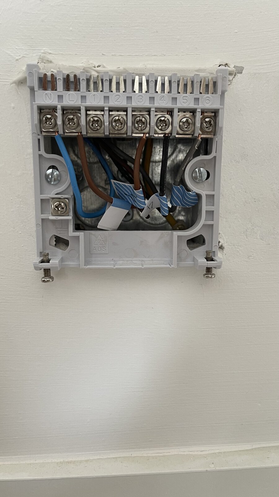

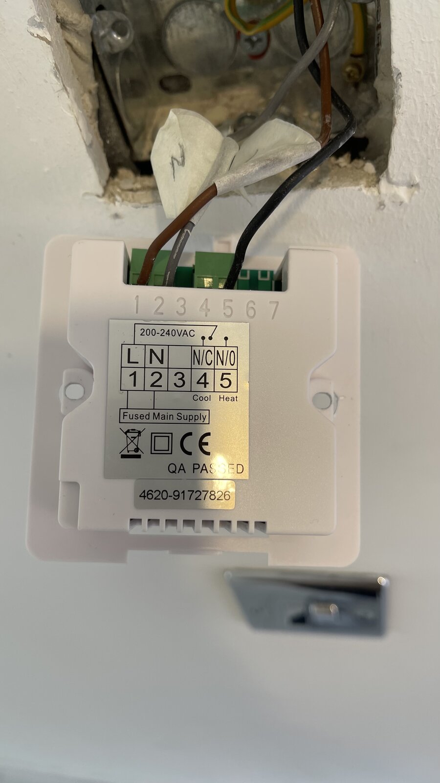

I have just moved into a new build and have the current setup.
1x wired thermostat in master bed (1st floor)
1x wired thermostat in hallway (ground floor)
1x 3 channel programmer ESI ES3247b (utility room)
the programmer controls hot water, zone 1, zone 2.
I used to have a tado in my old house but after some research, seems like it is not compatible with my current setup.
I tried to check nest out but seems like they can’t use the live wires from old system as they are low voltage only.
And finally I found Drayton wiser? I believe I’ll need to remove the old thermostat wiring to install this.
Is there a system you would recommend that does not need an electrician to come by and re-wire? I’ve added the wiring the thermostats and programmer has. Thanks in advance!

Tado would be compatible, but you would need the extension kit and an additional wireless thermostat.
You could then use the extension to control HW and one zone wirelessly via the thermostat, then hard wire the other thermostat.

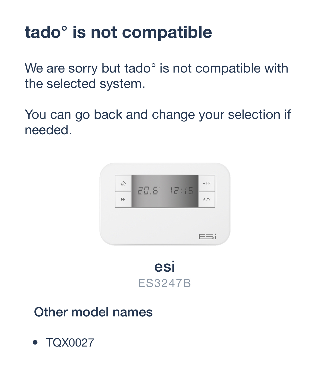

That’s weird because when I go to tado and check compatibility it says the extension is not compatible with tado…

Drayton Wiser should be a decent swap, with minimal, if any wiring changes.

That is the user checker not the pro installation tool - which using the hidden menus can set this up to work.
Tado says it's not compatible because for age their extension did not have 3 channels (it has 2 relays). All you would be doing is using a wired thermostat as an additional relay hard wired to that additional zone.

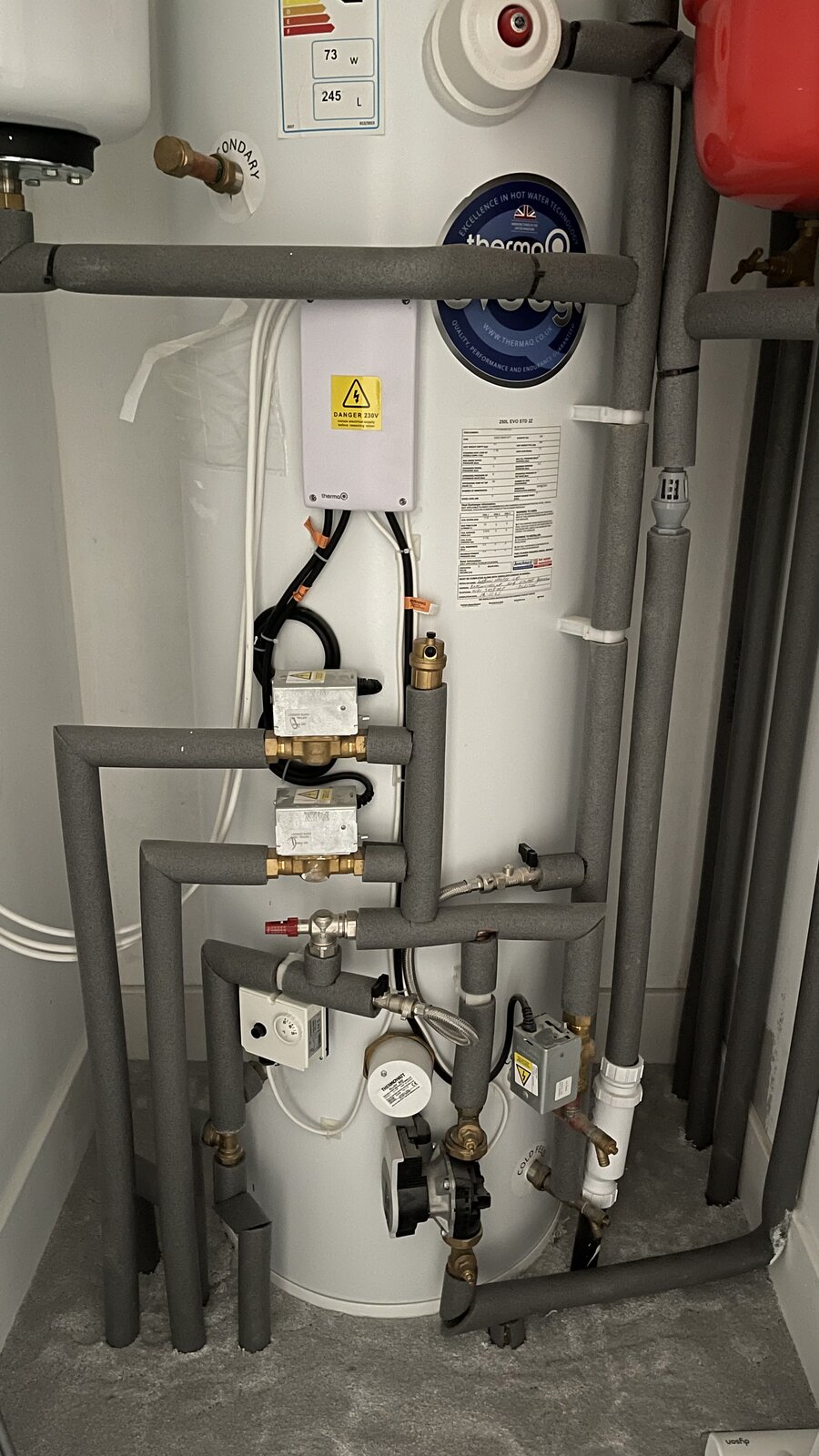

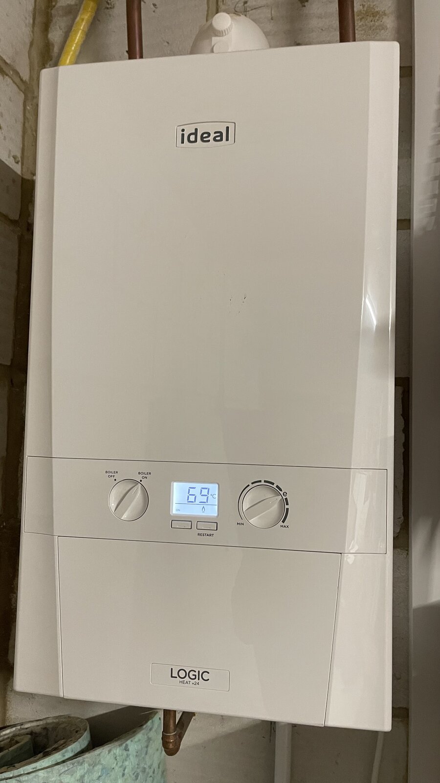

not sure where I can check the size of the boiler but the flow temp i can set it up to maximum 80. Uploaded a picture of it and the cylinder tank for hot water.

I can't see any isolation valve or drain point on the expansion vessel, so it's likely it will never get serviced; this should be addressed.
Also its not clear but Possibly the primary pipework out of the boiler is not of the correct size, this will depend on your property and the heating design if it's important or not - but it is a noticeable detail, as is the admitted tiny price of insulation on the capped secondary return on the hot water cylinder.
24kwh is a pretty massive boiler for a 2022 newbuild, how big is the property (how many floors and bedrooms?) Also how many radiators is it serving?
The issue is these heat only logics can't modulate very low. So it's likely the heat demand for your house most of the year will be well below the minimum this boiler can do.
It's also possible that your flow temperature is too high for this boiler to ever condensate.
You should consider getting this entire setup checked by a pro and look into weather compensation if it isn't already installed (looks like it isn't).

Yes that sounds right.
You could also get it wired in parallel with all existing controls to ensure it works without disrupting your original installation.
The tado install will not be simple, you will either need to have an installer do it, access the pro menus or email tado to set it up how you want. (They typically will do this within 48 hours).
