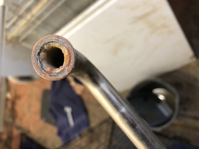

Blending valve all clear, it’s not that, the valve delivery pipe where it meets the heat exchanger is scaled up but you can blow through it (hopefully see pic)

I sadly think my problem is another scaled up heat exchanger
any other suggestions gratefully received
Has anyone any experience in using chemicals to descale a plate heat exchanger
Or is this a waste of time?
Descaling is hit and miss. Ideally you need to circulate the solution but someone will come along and tell you otherwise.
I use Kamco FX2 neat ! Never had one that would not clean.
Give HE a blast with hose to clear loose "Tea leaf" type deposits for a few mins,
Lay HE in a container / washing up bowl . Pour FX2 into H E side to be cleaned. Pour boiling water into other tappings and leave to ferment for a while. Topping heat up if req,
Rinse, neutralise with whatever you use and job done!!
