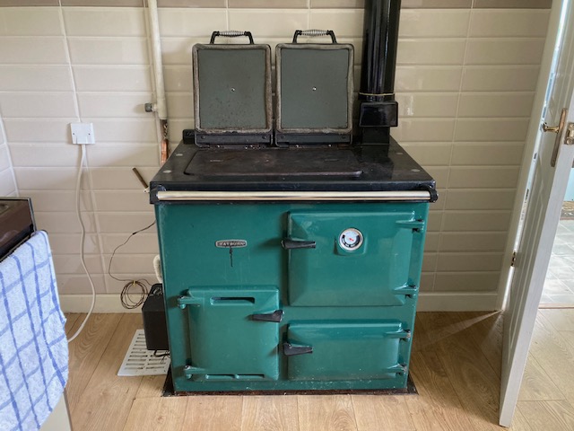

I have a gravity fed Rayburn 308k model with a back boiler that appears to be leaking water as the base of the Rayburn is very wet and rusty. It's not coming from the fittings on the outside so it must be the internal tank.
I cannot see how to get to it though, some models appear to have a side plate but this one doesn't and the only other way I could see is to take off the whole top but that looks like its not design to come off?
Any help would be great please...

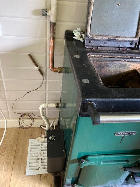

By the way that remote fire valve couldn't be in a more useless place if you tried. Needs a 90c type fitted next to burner.

What was the new section of copper on flow installed for?
Oh yes that's right it was stainless steel. I will have to try and rig up something better then to test it as to get more pressure and maybe spray some soapy water over it and look for bubbles.
And yes it is indeed a gravity circulation only type heating with one small radiator in the bathroom and the hot water cylinder. I fitted a new section of pipe because the old was leaking on the joint which is the return as you probably know and although I cleaned it as best as I could and using flux the new solder just wouldn't take properly so I cut a piece out and soldered on some new.
This cured the leak but again I was thinking as the Rayburn has been off for quite sometime given the time of the year and where it had been leaking before on that old joint water may have run back through inside the Rayburn and down the side of the boiler gradually making all the insulation wet to the point a pool of water had settled at the bottom of it.
Before the Rayburn was turned off for the summer I am guessing that previous leak was drying out enough as to not make it very noticeable wet on the bottom of it.
This is my theory but of course I can tell you know a lot more than me and I am thankful for your time and help. I forgot to ask about the sensor for the remote fire valve that's on the wall, should I move it then?
First fire valve sensor should be in front of burner as near to door as it will go there was originally a clip on bottom plate
Make sure fire valve is rated at 90°C it's marked on valve.

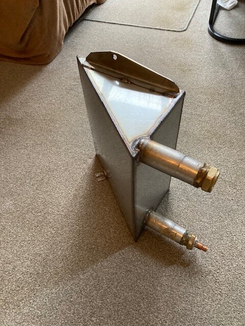

Hi again, haven't put the Rayburn back together yet but I have found that the boiler was leaking after all through the welded seams when it was under pressure, I'm glad I checked it again.
Luckily through a friend of a friend I had one made from stainless steel for £200 which is a lot cheaper than I could get one for online. They did re weld the original one but noticed some more hair line cracks. They of course pressure tested the new boiler before handing it back to me, the welding was absolutely brilliant.
So hopefully once I reinstall it everything should be as it should. Here's the photo of the new boiler I had made, oh and thanks again for all your help :)

Thanks for update that looks a nice bit of fabrication
When its all back together slowly bring it up to temperature as soon as you can less chance of fire cement cracking.
Plus don't forget to sort that fire valve.
