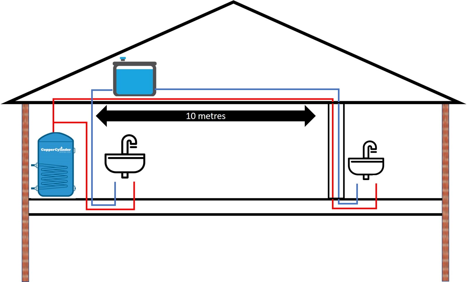

The current bathroom sink happens to be the room just under the water tank and the hot water cylinder is in a cupboard in the same room. Per my very simple diagram:

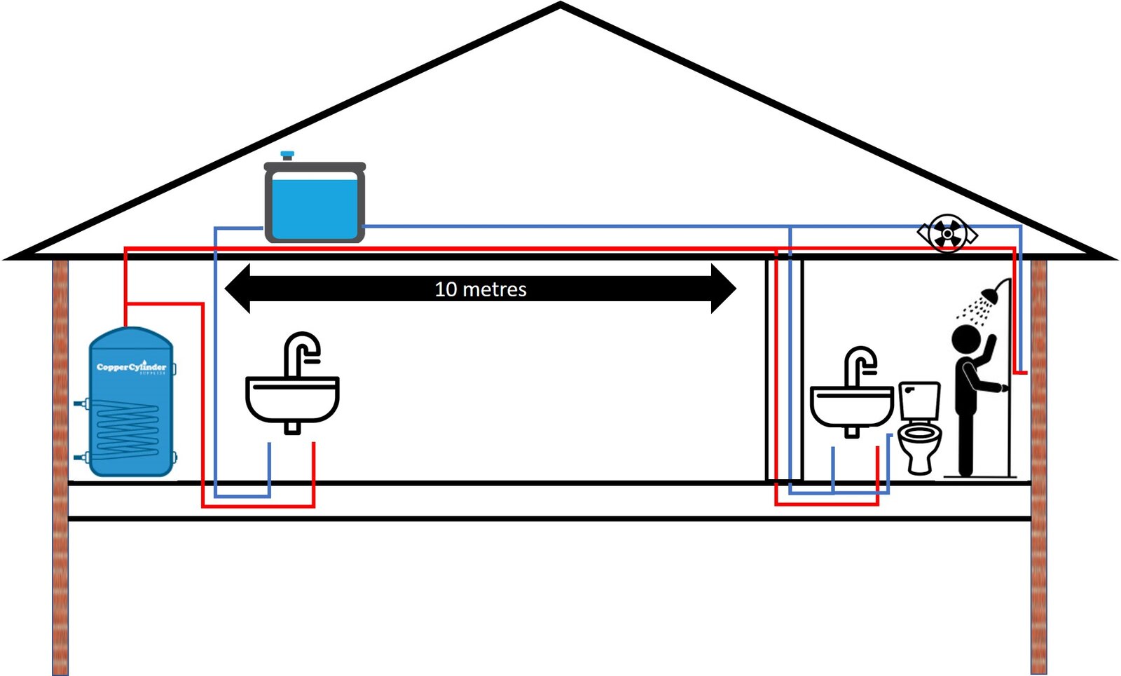

I am installing an additional bathroom on the same floor, but the other side of the house.
It is very difficult to pull up all the floors to get pipes via under the floorboards so the only practical way is up into the loft and back down a stud wall per my next diagram - (truly this is my best attempt at drawing my plumbing!)
My first concern and request for advice is whether the hot water might struggle without a pump to go up to the loft and over a ~10 mtr horizontal stretch and still maintain decent pressure like we have at the moment in the main(first) bathroom.
Of course this scenario isn't just a sink, a toilet and shower will be installed...
I was told to consider having a pump in the loft for the shower only.
I would prefer to situate the pump nearer the hot water cylinder as I'd prefer the noise to be that end of the house and for maintenance purposes it's easier to get to, but not sure about having the sink and toilet on the same pipe that will push highly pressurized water from the pump. So ultimately I am concerned about too much and too little pressure in either scenario.
Any advice on best practice or alternative options would be appreciated.

The hot supply for shower should come directly from the cylinder ,via a suitable flange ,and dedicated to the shower only. The cold supply should also be a dedicated supply to the shower from the loft tank. Both via the pump.
The cold supply to WC can be fed from the cold mains ,as can the cold to the basin if seperate taps are used (as opposed to a mixer ,which would be better fed from the loft tank)

The sink is indeed a mixer so I think it is best to run 4 15mm pipes to that new bathroom.
One pair via water pump for the shower.
One pair (cold from loft water tank and hot from the hot water cylinder) for the sink.
Do you think if the current bathoom sink pressure feels more than enough that using gravity fed for the sink in this way will still be ok pressure or going up and 10mtrs over create a large loss of pressure?
The pressure would be the same ,however, the flow rate would be less. That would be due to the restrictions in the supply pipework , particularly the hot, more bends = more resistance to flow. Small bore flexible tap connector hoses on mixer taps being the greatest restriction. Is your existing bathroom tap a mixer ?
The up and back down layout will also be inclined to cause airlocks, in the hot supply. Always better to go down first, along, then up to minimise them.
This was actually a problems before, if the system was every drained, getting back up and flowing was almost impossible. Any way of fixing this? a component that would allow the air out on refill perhaps?
A question for the plumbers - could an automatic bleed valve be fitted, be worth fitting?
Under normal conditions, with a gravity system like that you would fit manual bleed valves at the highest points in the system. On that I would fit 2, one at the top bend as it rises into the attic and one at the other bend where it drops. Don't fit AAV's, over time they're almost 100% guaranteed to leak.

Thanks again, manual sounds like a good option as whenever we have had the issue has only been when we drain and refill the system, but never once it's all running so doing a manual bleed on refill (which is rare occurrence anyway) is very ok!

If you're going to take gravity hot water across the loft, tee into the hot supply as low as possible before rising to the loft, again to avoid airlocks. It can be tempting to tee into the hot vent pipe already in the loft, but that is almost guaranteed to create HW airlocks.
Manual air vents - definitely, but keep them short and covered in insulation.
