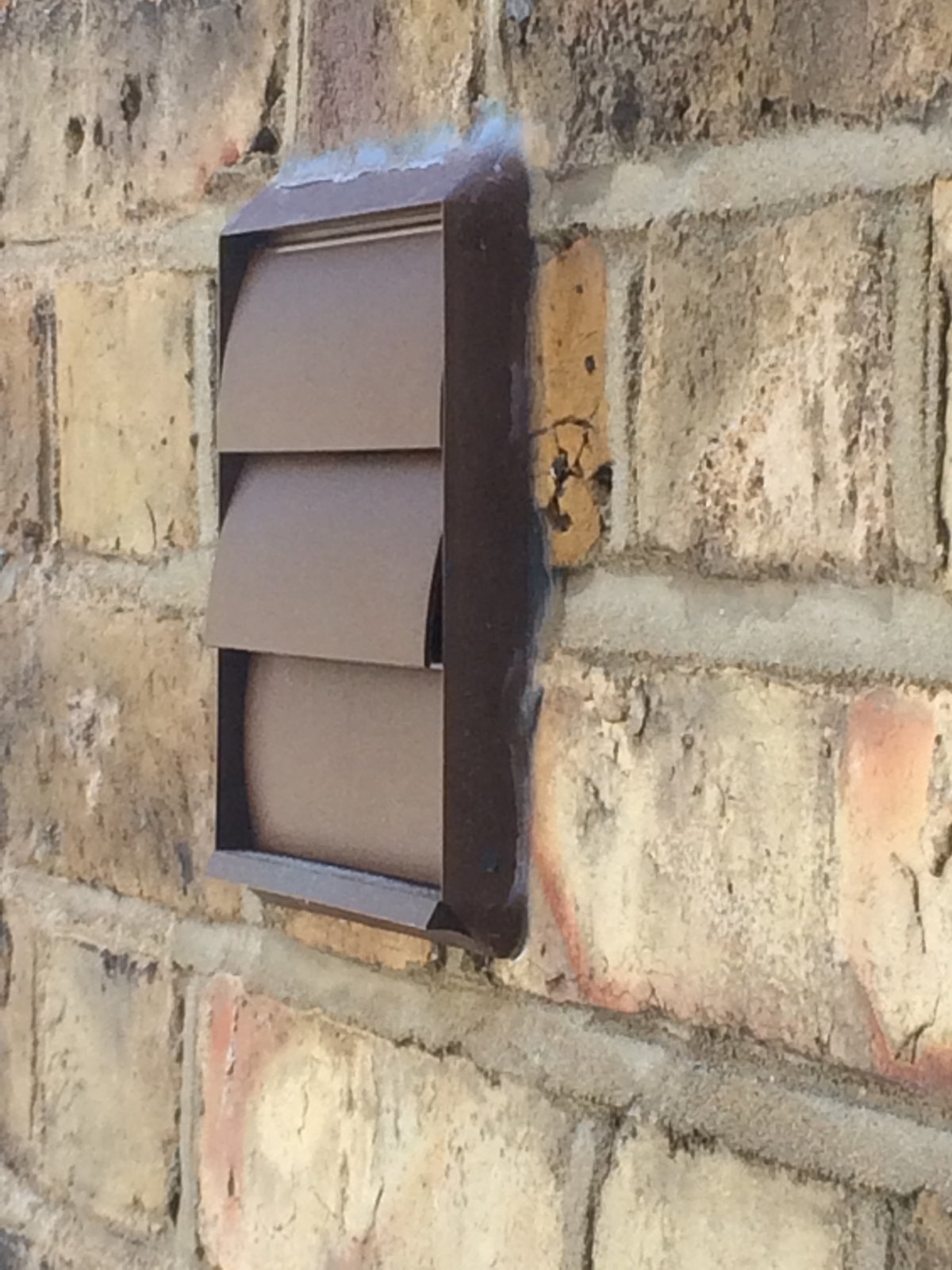

I noticed that it is not doing much to clear steam, and checked the outside grille while the fan is on. It doesn't move. I'm guessing it's supposed to open, otherwise no air can flow to the outside correct?

I checked again this morning and it is lifting up very slightly, a few mm. The top one seems loose, the middle one is a bit stiff (tested with a stick) and the bottom one is fixed in place, designed that way it seems. Opening the door makes no difference. It looks like probably the fan is just not powerful enough. Elsewhere someone recommended centrifugal over axial fans.

This is how much the flaps open when the fan is on. I think the fan has its own spring loaded backdraft flaps as well.

It looks a funny shape, perhaps that's the camera angle. If it is square, all three flaps should swing. However, on that model, they will rattle annoyingly in the wind, until they fall off. It should be attached with four non rusting screws, not glued onto the wall.
A cowl vent is not so noisy and has better weather protection. I like the brown ones. It has one large, free-swinging flap.
https://www.screwfix.com/c/heating-plumbing/air-vents/cat840496?producttype=cowl_vent
I see from the silicone that your builder is a bodger. Is there a plastic duct in the hole drilled through the wall?

can you open fully manually? looks like it may be obstructed by poor fit, excess silicon fouling it.If there is slightest restriction it will not open correctly.

The three flaps all open , if bottom is stuck then its a bodge job. Either distorted or silicon fouling.

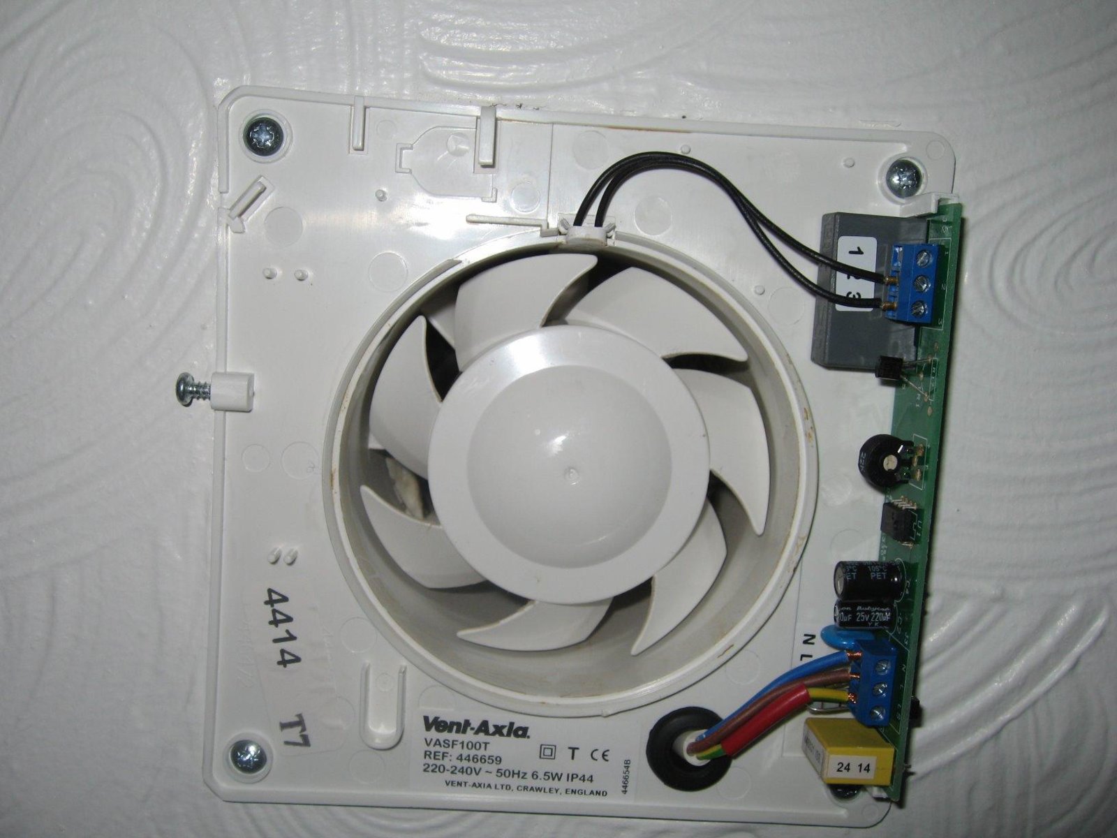

I managed to remove the flat cover, but can't find any info on how to remove the main front cover.
These things are flimsy plastic so I don't want to force it and break anything.
The manual doesn'r explain how to get the front cover off to access the pcb.
Any ideas?
I found a picture from Amazon of what it looks like inside
I think you will find the round screw (usually on the bottom, but on the LHS of your pic) retains the cover. The cover will then hinge from the opposite end, so you pull out the side that was formerly held by the screw, and it will then lift off tabs (on the RHS of your pic)
The round black thing facing you looks like it is an adjuster, probably for the timer, if yours has one.
But you must find the instructions, or put a question on the Q&A of that link I gave you, to see how the power is adjusted. It looks like there is a high and a low setting, "wall and ducted," what he calls "bath or toilet" but I don't know if your model is the same.

The pcb settings I'm sure I would be able to figure out, or it's in the manual.
But the cover doesn't want to budge. Unless it's designed to snap off with pressure, and in that case you need to be willing to risk breaking it.
The screw is removed but it's not hinging or sliding.
Rubbish design..
