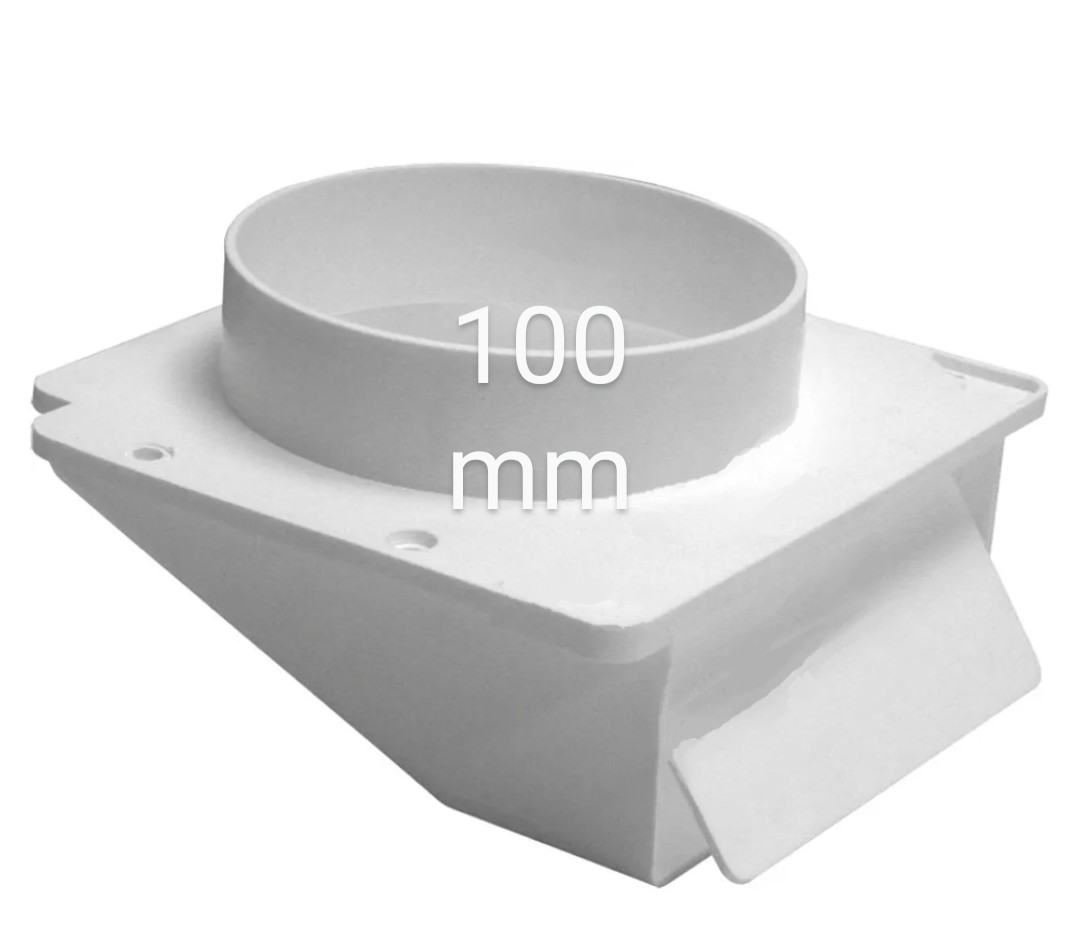

I'm looking for a 125mm soffit mounted vent with a flap. Stop the air blowing back in cooker hood.
I can't find one.
Anyone know where I could get one that's decent?
I prefer the cowl vent
The cover protects against rain and most wind, the single large flap does not rattle much.
Plenty of 4 inch options but not 5 inch 125mm.
It's for the soffit not wall.
This is what I want but 125mm
