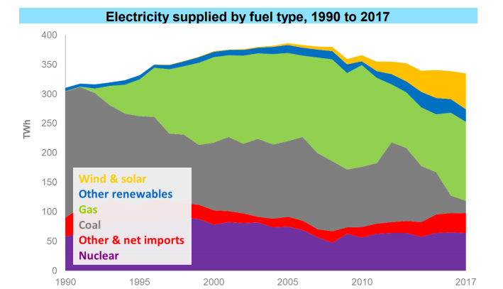

A large proportion of electricity in the UK is generated by burning gas - and as generating and distributing electricity has significant energy losses, it's inevitable that using electricity will create more CO2 than using the gas directly.
Also the production of electricity through renewables is on the increase as the coal stations close down.
Coal stations have closed, mainly because the number of gas powered stations increased.
Source: https://assets.publishing.service.g..._data/file/728374/UK_Energy_in_Brief_2018.pdf
