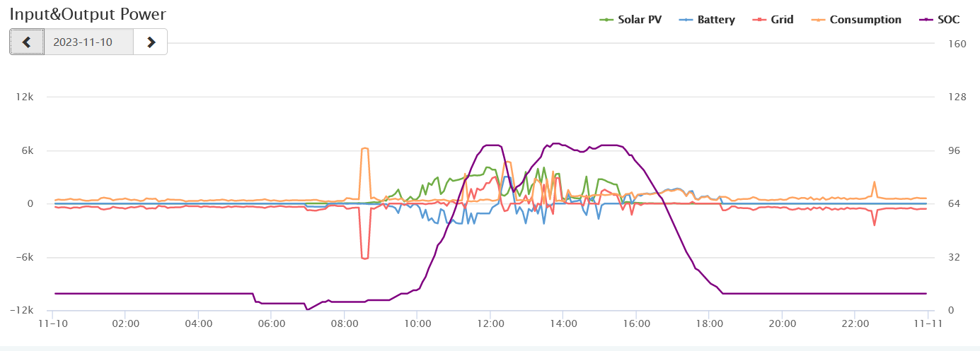

Each day I have a summary
I could work out the average cost per day, but with this as an example
Had my daughter waited until mid day to have a shower rather than around 9 am it would have cost me less. This shows a good day this month, and the window where use would only reduce export is 10 am to 3:30 pm, before or after that time it will cost me the import tariff. Yesterday it would have cost the import tariff all day, so I would forget the solar and charge at import tariff rate.

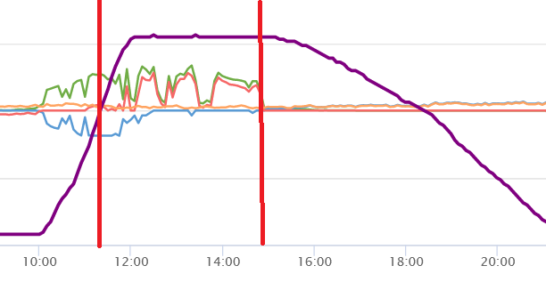

So looking at yesterday, quite a good day, if me daughter had used power between around 11:30 and 15:00 it would have been free,
You can see the green and red line following each other, solar production and export to grid, but after 15:00 hours, it would have been using the battery, which means less available over night. So only around 3½ hours of free power, which was not used as neither of us were home.

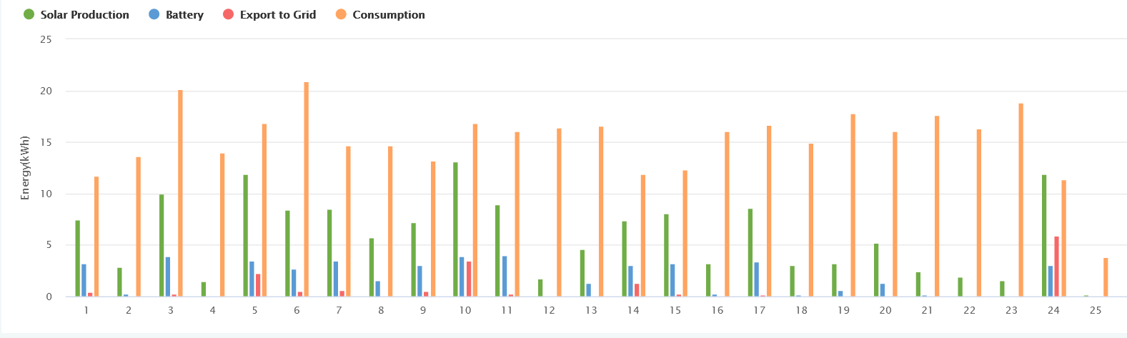

And one really has no idea when the sun will shine, so even using at 14:00 may cost as the sun may go in and battery never recharge fully, as I go back day by day, there are very few days where power was exported. 1700904951843.png red is export to grid this month, the 5th we got 2.3 kWh but most were lower or zero, only yesterday did we get 5.9 kWh which had we been paid would be 88.5 p at 15p per kWh so really not worth worrying about. And I have paid for the panels so why should my daughter gain as a result? As said she lives for free as she is my daughter, but if some one else lived there then I would not be reducing the electric cost due to sun shining.
