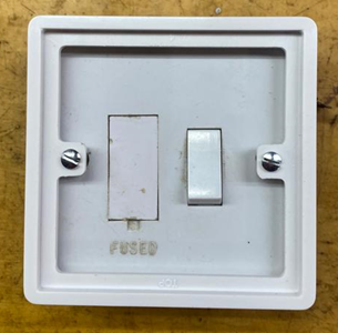

Guarded switch fuse?

What rather surprises me is that the OP's wife has managed to do this (at least twice). I've just spent a few minutes playing and, without getting ridiculously violent, I cannot operate the switch of a switched FCU by 'knocking things against it' - they really are pretty 'stiff' things.
As for the OP's original question, one approach might be to attach something like an accessory spacer on the front of the FCU, along thee elines of ..

Thanks, yes I've seen those but it's for a single switch fuse supplying the gas boiler.
Twice now it's been knocked off by SWMBO as she left the house to be away for a few days resulting in loss of Hive heating remote control and loss of heat to keep frost and damp at bay whilst away!
I think it's the bread bin's hinged lid that is at the correct height to push the switch off when opened! It's going to have to go....:unsure:
Turn the switch through 180°
