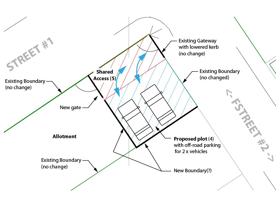

We're looking to create off-road parking for at least to medium size cars - see sketch.
The plot width (Street #2 side) is approx. 9.3m. Access to the plot is from this street (via a gateway measuring approx. 3m)
The plot length (along Street #1) is TBC
Ideally, I want to understand how much space (length) is required to comfortably park two vehicles on this plot. The owners of the allotment want to retain as much of this land as possible therefore we need to determine the right amount of space.
Can anyone advise on where I could find free guidance on planning the layout or at least determining how much space we require. At this stage, I do not want to waste money on a project that might fall over at the "the lands not even big enough stage!)!!
Cheers

Lol - that's my plan B!!
I just wondered if there was a document/website that provided more "official" dimensions for this type of thing.
There is no minimum but 2.4 x 4.8 is generally considered a 'standard' space. Look in your council highways guide.
There is an existing gateway with dropped kerb, hence we would look to use this as access.
The land has only been used as fields, allotment and garden. The only modification required would be an amount of landscaping to level (by filling) part of the land then the addition of a suitable permeable hardstanding (possibly gravel).

Maybe if we had a post code near the plot we could have a look on google maps to see the site/roads etc.

woody, although there is an existing dropped kerb it may not be designated for vehicles.
I bought land next door to my house it was previously an allotment society storage area with a dropped kerb,applied for full planning permission for a detached house with off street parking via the existing dropped kerb and was refused as the existing dropped kerb was not designated as a vehicle crossover.
So I had to apply for separate planning permission for a vehicle crossover,this was initially refused but successful on appeal.
Maybe it was the London councils way of getting more money out of me. I won.
I done my front garden into a driveway 5.4mtrs wide 5mtrs long i can get a mondeo and ka side by side no probs. Dropping the kerb is different for every council they can drag it out i got mine done for £850 from local contractor got it cheap as they never had much work on over christmas the council wanted £1200
