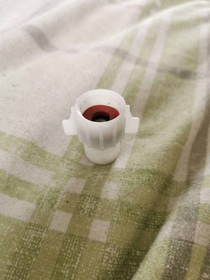

Does anybody know what this is called please? thanks
