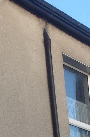

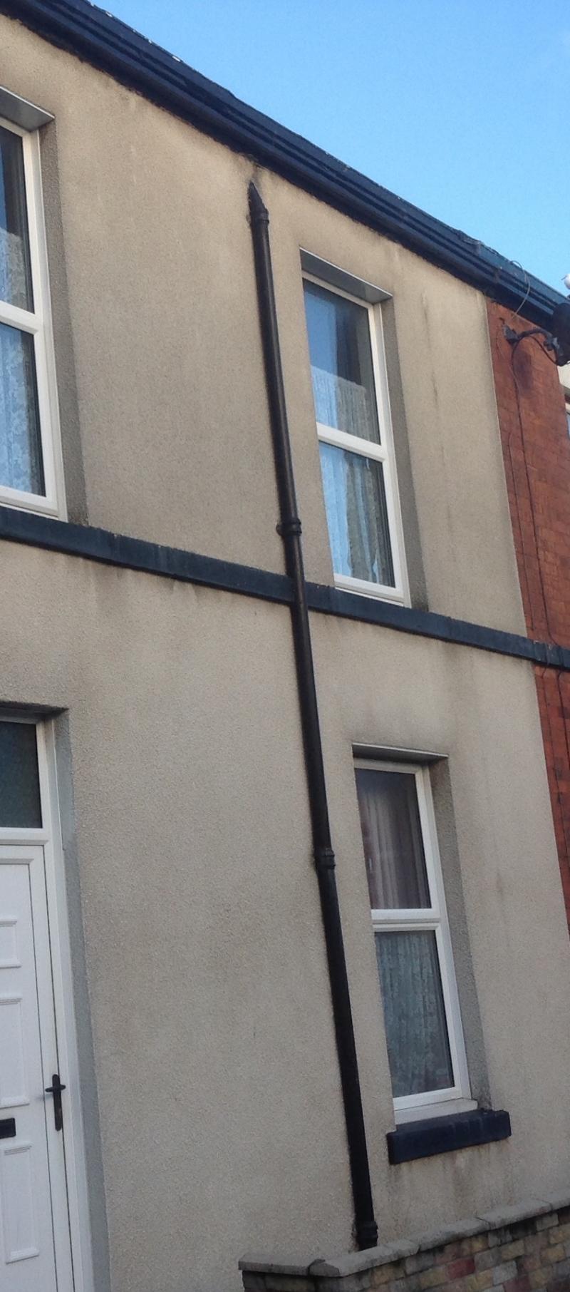

Couldn't get exterior pics today.
The overflow feeds directly into the trough. It is not visible on the exterior. Can only be seen inside. It is a piece of pipe whose end has been broken off.

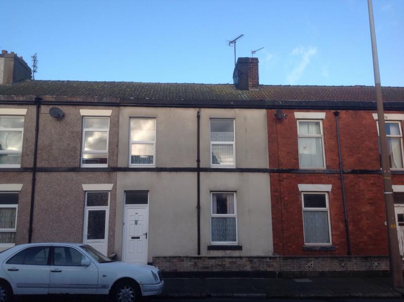

The next pic shows the original in the centre and to eavh side are subsequent modifications. One involves cutting into the stone gutter to insert a hopper whie the other just places a hopper onto the existing drainpipe.

The on-site evidence also speaks for itself. There is no way in the world that the interior trough had the capacity to deal with the main rainfall. It is far too narrow and shallow and the fall is not steep enough to ensure a fast enough flow.
It is clear from the interior that the trough, its feed pipe, and the exterior outet were all installed at the same time.
In addition, how do you explain why all the houses (before rhey were modified) had the same design of a pipe leading from the stone gutter to the front wall? This is clearly contemporary with the original build. The builders had to terminate that exterior pipe somewhere so if it was not in a hopper where else would it go but a drainpipe?
The castiron drainpipes are also clearly consistent with the period.
So whether you are convinced or not, the arrangement which you see is definitely that which was installed at the time of the original build.

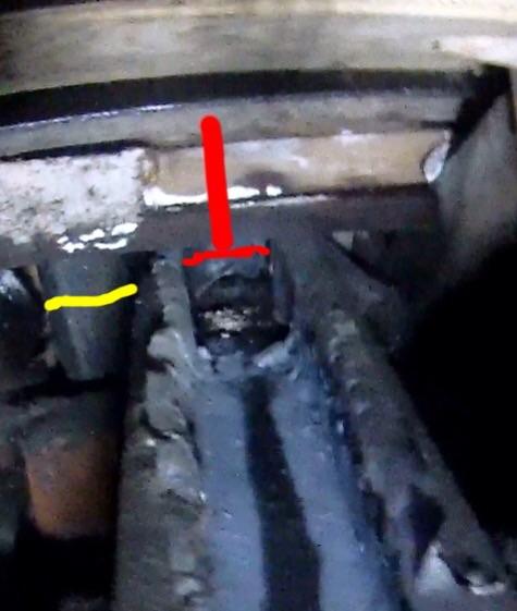

I have edited a previous pic to demonstrate my point.
- The pipe marked in red is the overflow pipe which discharges into the overflow trough.
- The pipe marked in yellow is the pipe which leads directly from the hole in the stone gutter to discharge into the front drainpipe.
- There is and only ever has been only one hole in the stone gutter.
-The yellow pipe descends vertically from that hole.
- Your theory is that there was no exit to discharge water to the front wall because the interior trough was designed to carry and discharge all the water at the back of the house.
- If your theory is correct then the pipe leading from the hole in the stone gutter (the yellow pipe) would line up with the trough. It clearly doesn't.
- It is the red pipe which lines up with the trough and this pipe is the overflow connected to the yellow pipe.
This clearly indicates a discharge of the main flow to the front of the house with an overflow leading to the back.

The yellow pipe is the main discharge - vertically down from the hole in the gutter.
The red overflow pipe intersects the yellow pipe underneath the gutter and then turns downwards to flow into the trough.
So imagine something in the form of a letter h.
The left hand vertical of the h is the yellow pipe and the red is the remainder.
