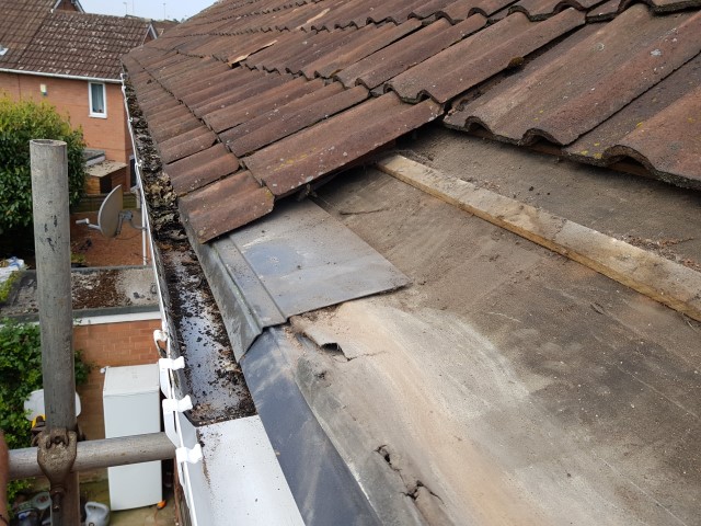

Had him round today for a quick look and a chat.
I'm having facia and soffits replace and new gutters. I've asked to have gutter trays fitted regardless so he's going to take pictures while he's up there.
He mentioned the ridge tiles could to with re-setting/ pointing which you can see from the ground when it's pointed out, this will be a job for another day though depending on his quote.
Said up to 3 days work for facia/ soffit/ gutters and gutter trays (needs 1 or possibly two tile runs lifting) which sounds fair enough to me.

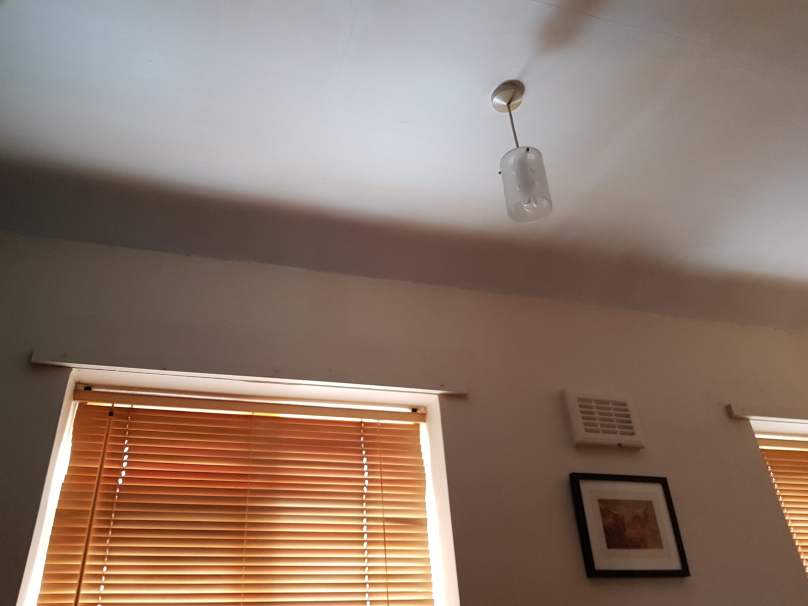

Hard to tell from picture but it gets damp where the long shadow is across top of wall.
The ceiling slopes down due to rafters so I assume the roof wall plate will be in this area?. Happens across front and rear of house.

It is fairly common to get condensation at the wall/ceiling abutment. If you think about it, this is the spot where the roof tiles are closest to the ceiling (cold bridge) and where the insulation is likely to be at its weakest.
Condensation! especially if you have the old black bitumen felt
and a raked ceiling, felt support trays will be a waste of time.
To be fair while he's up there no point not fitting the trays!.
Will see what happens, could be condensation as you say.
poorly fitted insulation and little ventilation more likely
What's best to do with that then? Kingspan between rafters (with air gap?).
