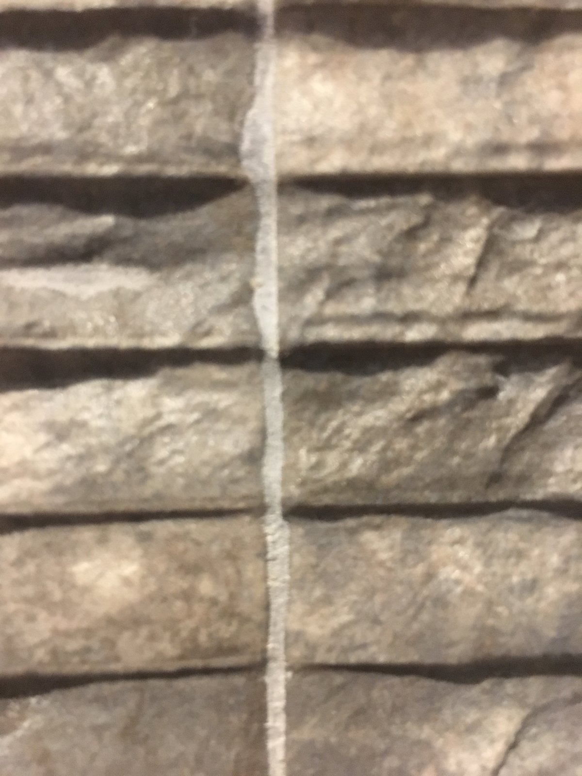

In May 2017 we had an extension including an en-suite, however last month when cleaning the shower, a pool of water formed on the floor. This may have happened before but we had a box next to the shower. I moved the box and it was soaking underneath. I then noticed the walls were wet at each end of the quadrant shower tray. The shower tray has a lip, I was told as it had a lip no sealant was required where the tiles meet the tray.
I effortlessly scrapped out the very wet plaster & plasterboard right back to the celotex.

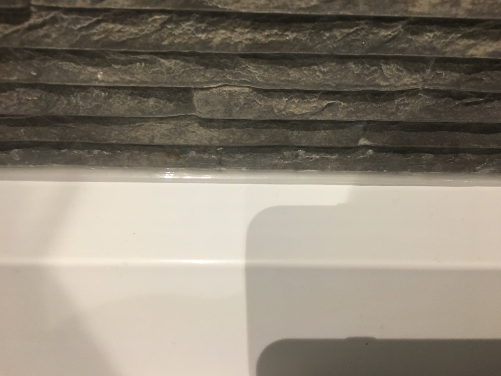

The builder came over, he hadn't seen this before and said it was due to the design of the lip on the tray and advised I should put sealant down. Not too much effort so i did this, let it dry, filled in the plaster (see pics) and starting using the shower again. It still leaked!
I went round with sealant over ever possible leak area, including the screws joining the shower enclosure screws etc but still getting leak.

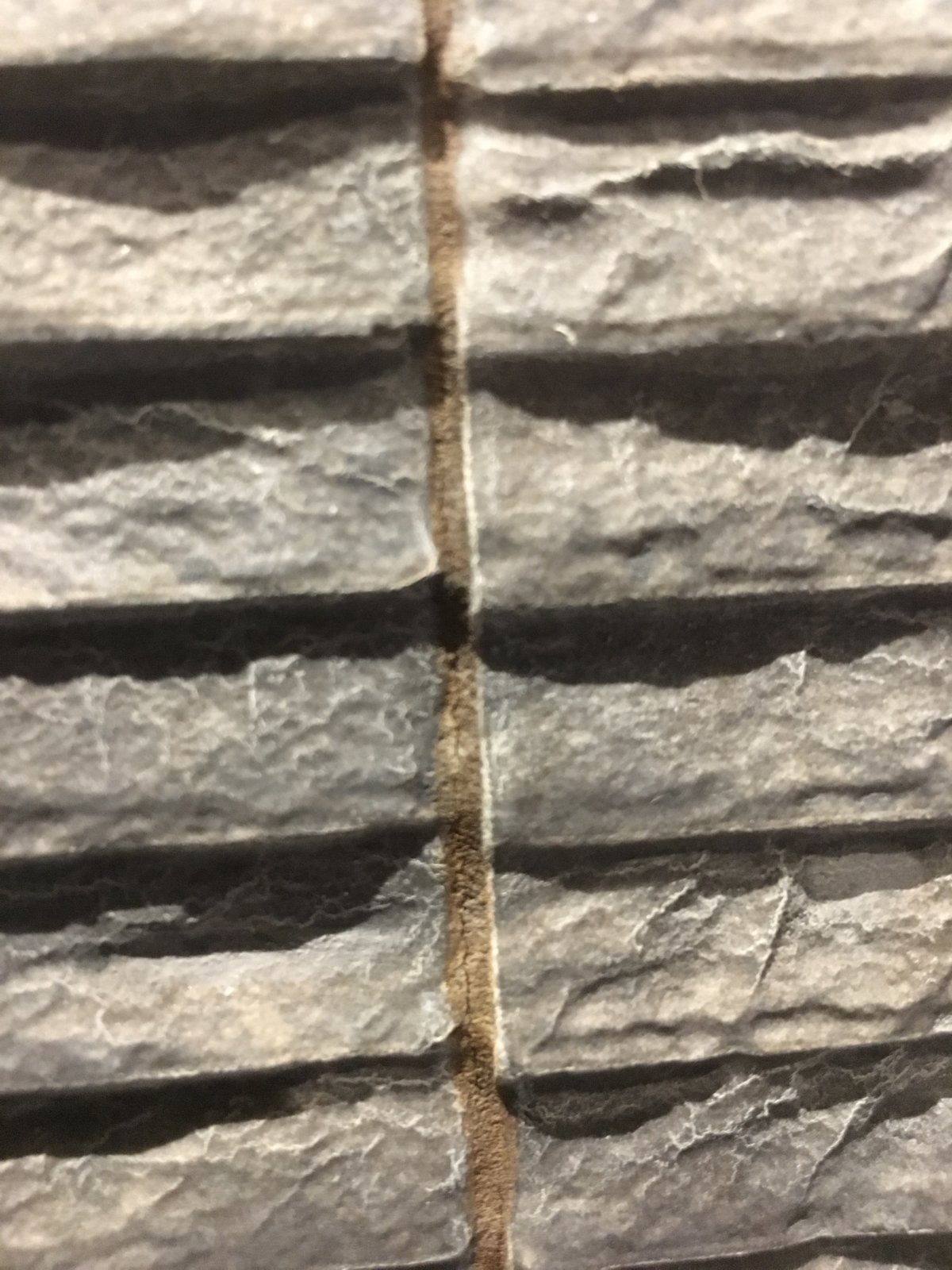

Checked the plumbing, no sign of a leak but I noticed a small hole in the grout which I have now filled. Upon closer inspection I have noticed a few hairline cracks in the grout (see pics), especially where the grout never seems to dry even after not using the shower for a week. I did mention the different grout colour to the builder but he wasn’t concerned.
So is it likely that these hairline cracks are causing the leak? It is bone dry under the tray but it wold be due to the lip.
If the hairline cracks are causing the leak do I need to rake it all out and start again? None of the tiles seem loose.

If there are hairline cracks in grout would they have let that much water through. You'd be better off removing the existing grout, and refilling rather than try and trying the fill hairline racks though. A lot of show trays have an upstand, but you should still leave a 5mm gap at the bottom, and then silicone it, as you don't know how much water would splash back up and over the upstand. Or did he tile right down to the shower tray; that'd make it more difficult to seal properly, and could justify asking for the shower to be redone.
Thanks Doggit. There is a gap between the tray & the tiles. Sounds like I need to scrap out the dark/damp grout. Will try the shower again first after filling a gap 8mm with no grout in.

Try spraying the hose on sections of the tray, to try and narrow down where the leaks coming from. I certainly don't think it's the hairline cracks, but I think they should be done at some stage. But I have to say that those tiles don't look good for a shower, as they'll allow the water to run backwards, before it runs downwards, and if there are any cracks at the top of the tiles, then you're on to a hiding.
I've tried spraying the hose all round the silicone in sections to try to pin point the leak but nothing. It only seems to leak after a few minutes of the water hitting the tiles. Used the shower today after filling in the 8mm grout gap, it leaked after a couple of minutes.
I think next steps are to scrap put the dark grout areas & re-grout
I think you'll find the final solution, will be to replace those tiles I'm afraid. Best of luck though.

Grout manufacturer came out, he believes the cracks and leaks are due to the grout being less than 3mm. In some places the tiles have been butt up against each other.
I remember asking the tiler to make the grout lines a thin as possible but at no point did he say this would mean it would not be water proof enough and leak!
Have taken one tile off and the plasterboard is damp. The grout came out easily!
