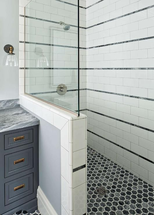

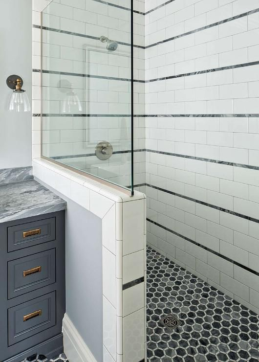

Upstairs with wooden floors so no concrete to work from, what would you use to construct a half height wall which will be tiled ?
Ideally, as strong as possible but not very wide as space is limited.

That sort of wall, where it doesn't have a pillar up to the ceiling, must be strengthened like mad to prevent it bending. You've got to imagine that overweight visiting relative grabbing the end of it and hauling themselves into the shower.
If it flexes then it will break the seal between it and the shower tray, causing damp issues.
Screw down with large screws in pilot holes into the joists, not just the floorboards.
It would be better if there was a tiled pillar between its top and the ceiling, which needs to go through the ceiling and be securely bolted to a noggin between the ceiling joists. Nuts, bolts and crinkle washers all round. You will need a pillar anyway if you're having a door.
Glue, screw and brace the framework, go mad on it. You can't overdo it, the potential damage from underdoing it will be terrible.
If you have a cupboard as shown then make use of its rigidity by screwing it securely to the original wall and your new one.
Yes screw the cupboard to the framework to add strength or even build one in as part of the design if space is limited as you say. It will be handy for towels etc.
That's a photo off the interweb. It's possible there won't be a cupboard there. In fact I'd avoid built-in furniture in a bathroom.
Just brace and bolt the heck out of it!
But... if there's nothing there then there's probably also no need for the wall, just have a full-height glass panel.
More info needed!
Build it in stud and perhaps add a couple of Galv roofing angles* at the base of the studs. The plasterboard or tile backer will knit it together and effectively sheath it.
