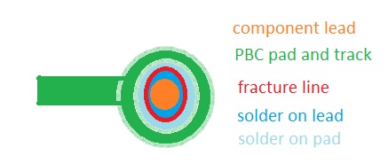

Many PCBs in boilers are single sided non PTH ( Plated Through Holes ) and that is a design fault that cannot be engineered out unless the board is rebuilt using a PTH board.
Non PTH boards are prone to the track next to soldered joints on component leads failing. With PTH boards there is effectively a hollow copper rivet through the hole and this rivet provides a secure mechanical anchor point for the joint
With a Non PTH board there is only a ring of copper around the hole in the under side of the board. This ring is glued or bonded to the board. If the lead from the component exerts any force onto the ring via the soldered joint then that ring may become detached from the board and the track to the ring will then break. The glue or bonding will have been weakened at manufacturer by the heat of the soldering of the joint. Vibrations affecting the board can give rise to component leads exerting forces on the joint and this over time results in the ring becoming detached from the board and the circuit broken.
The other vibration related failure mode in Non PTH boards is an annular failure of the soldered joint. The ring of copper remains attached the board but the component lead is a loose fit in the hole. The bridge of solder between the lead and the ring has to absorb the vibration and eventually fails.
Both these failures create intermittant faults which makes them hard if not impossible to find other than by a close examination of the board and every joint on it.
