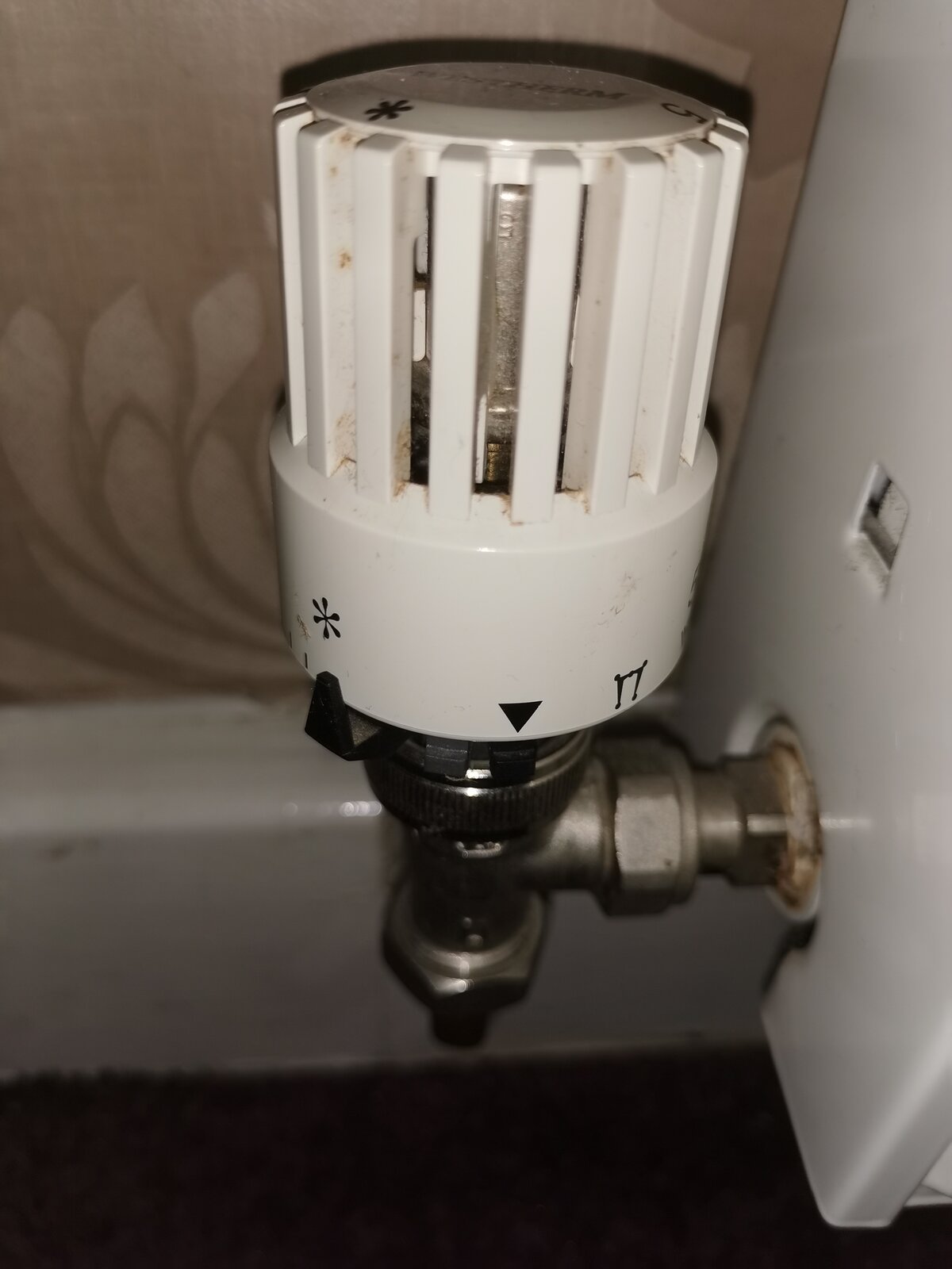

Does the banging radiator have a older uni-directional thermostatic radiator valve? Post a pic..
Here is a photo

Does it have 2 arrows on it or a right angle symbol?

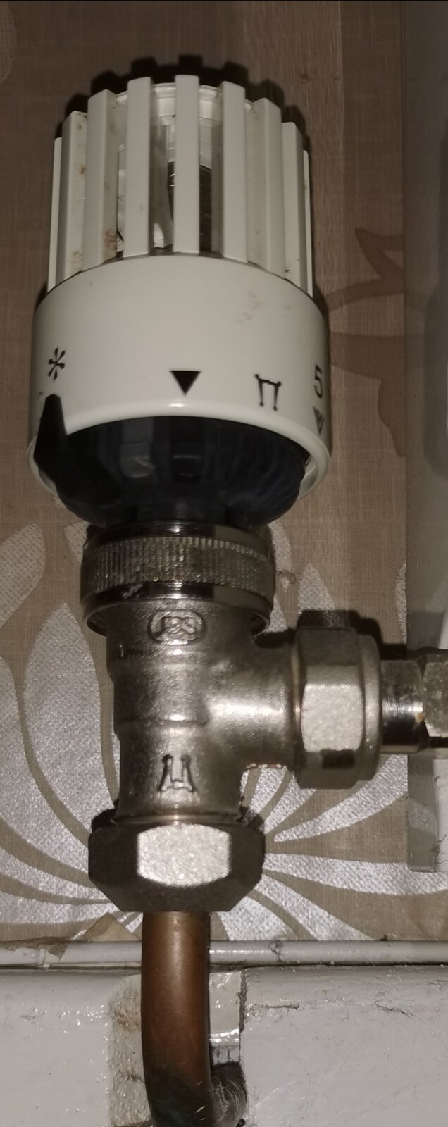

Closer up pic of the valve body req.
No, that's the thermostatic head...pics of the valve body..the bits with the nuts on.
Sorry ☹️ hopefully this is what you mean.
