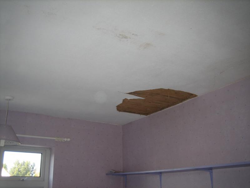

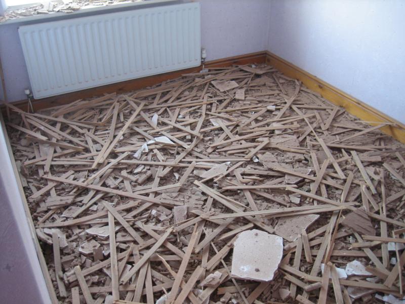

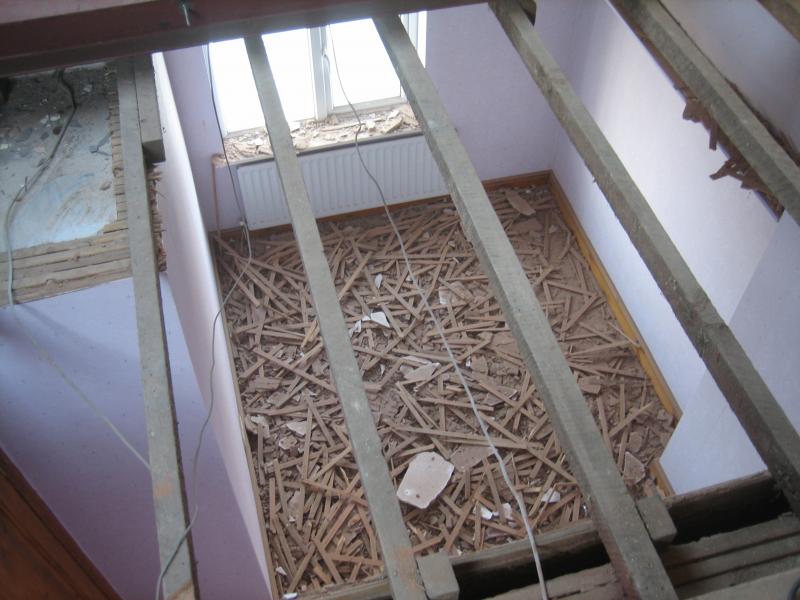

Update time! Not much done during December but I'm back with it now. I decided I should do something about the bedroom ceiling first...
10 minutes later....

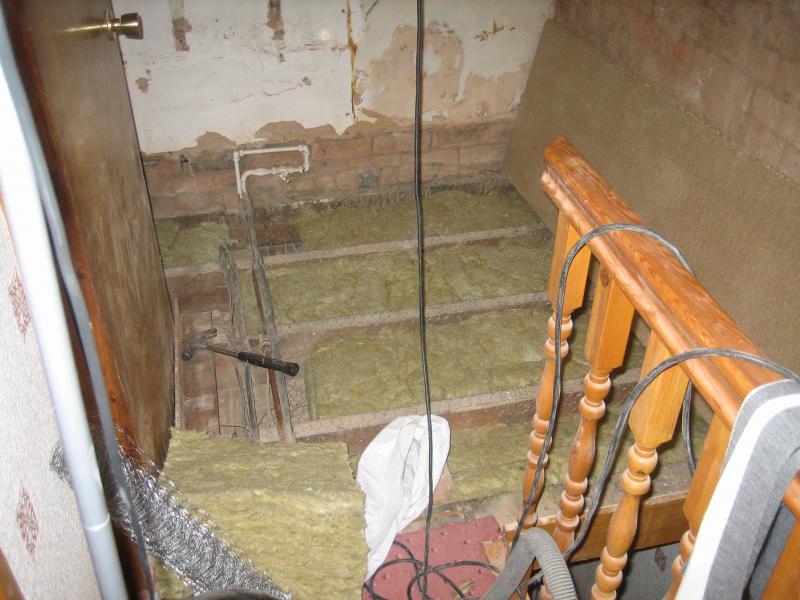

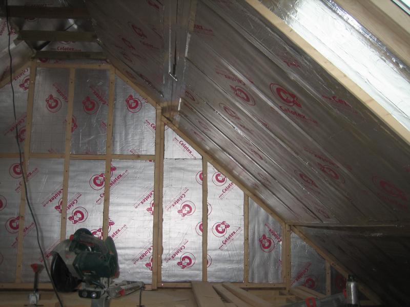

Floor joists are in, and ceiling studwork complete...
Landing meshed and insulation in place...

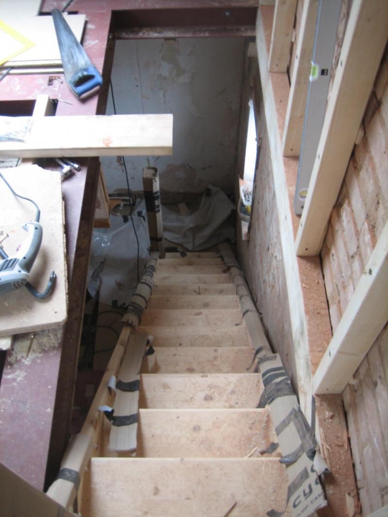

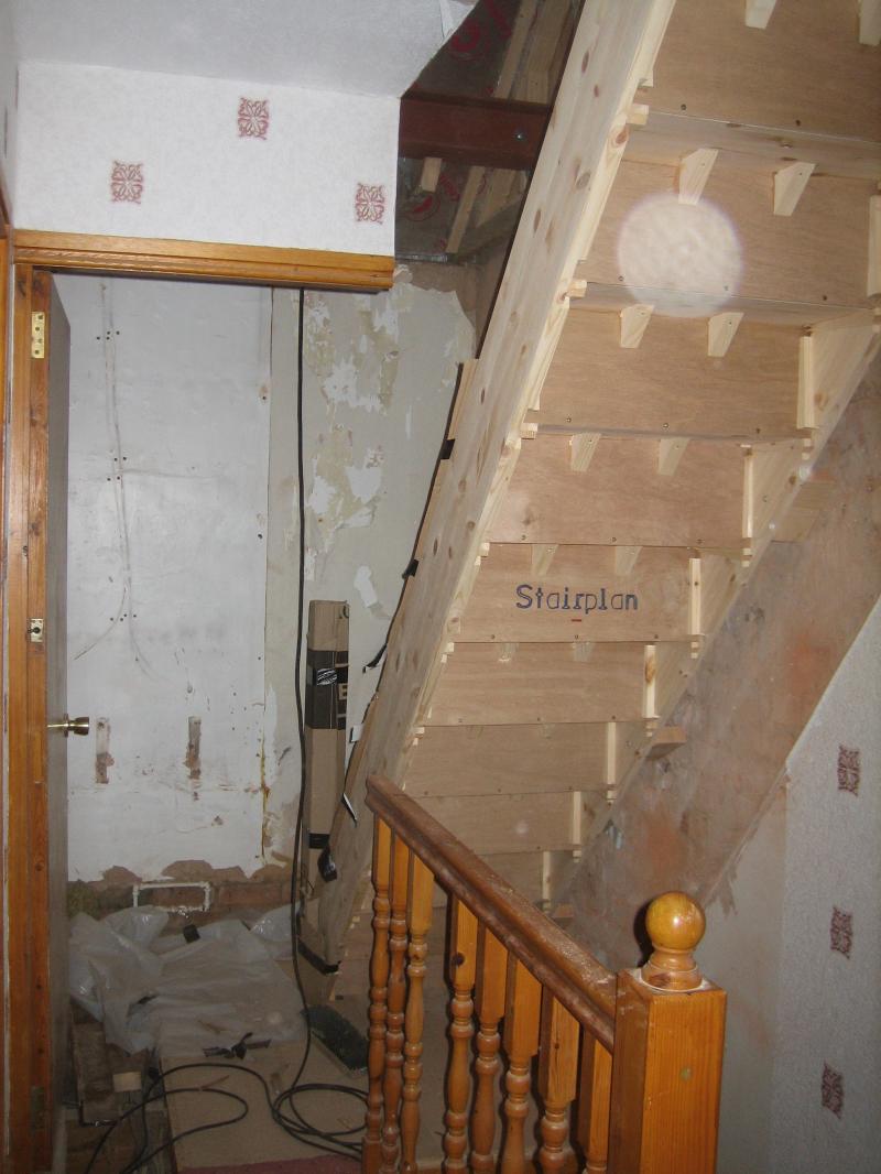

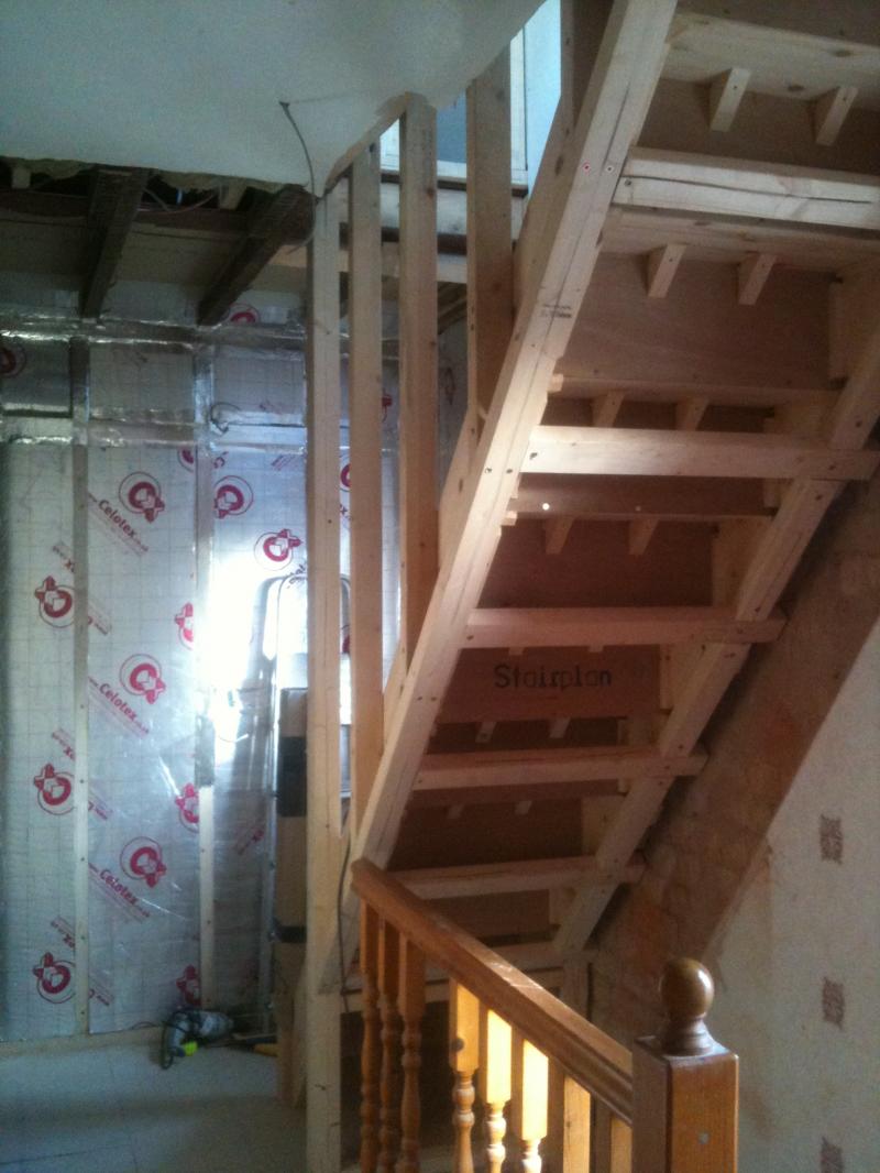

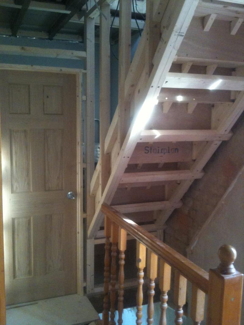

Stairs are in...
I was able to agree with BC to have a slightly steeper stair than normal (45 deg) to get the required headroom, which is still shallower than the 1st floor staircase (49 deg), and has better headroom to boot. The width of the stairs I ordered were only 1mm less than the width of the opening too, fit like a charm :) 2nd layer of roof insulation complete, and north wall insulation complete (still needs gaps filling and taping)...
I've framed up most of the south wall now, this is how far I've got as of today...
I should have the studwork and insulation complete in a week or 2, then it's on to flooring and plasterboarding, feel like I can finally see the end of this project on the horizon! More updates soon...
Looking good. I can appreciate how hard and long a job it takes when doing it by yourself. The insulation was the bit I detested most sawing all that foam. So your by that.
The stair you probably already realised but just in case. The minimium width will be your narrowest point ( normally the handrail to wall ) but you need 40mm clear on the other side of your ballustrade clear for your hand to run up the ballustrade. Its just something to remember before boarding the other side. I reckoned I had enough room until I attached the ballustrade. :rolleyes:

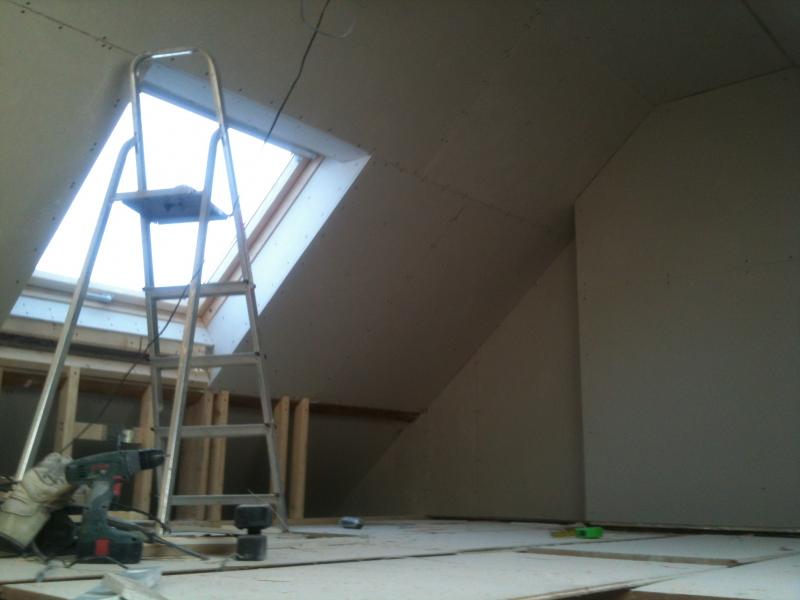

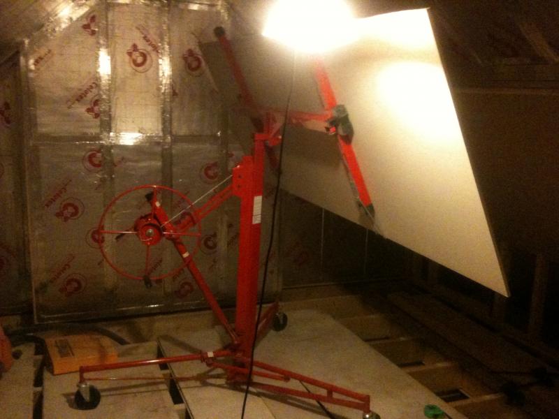

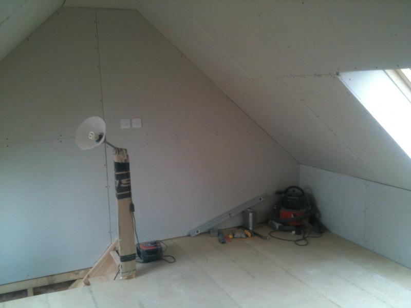

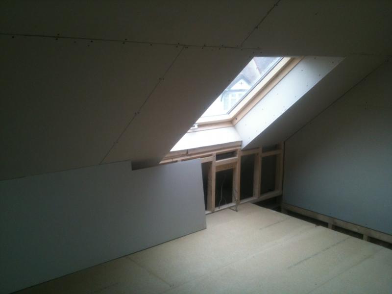

Plasterboarding begins...
Some random pics...

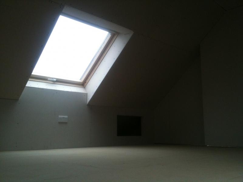

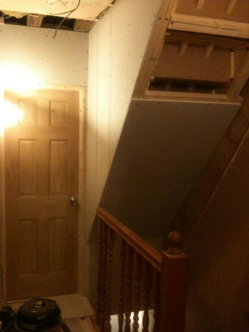

Plasterboarding upstairs complete...
The landing studwork, doors, insulation and plasterboarding progresses...

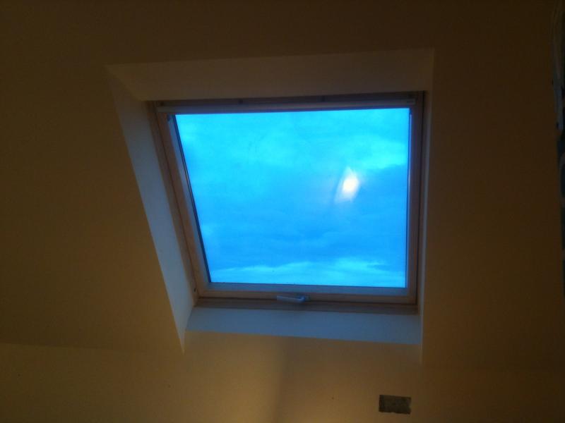

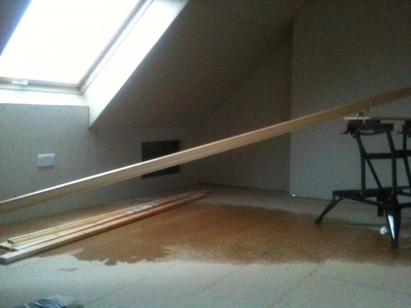

Word of warning, always close your skylights before you go to work, otherwise this happens. Doh!

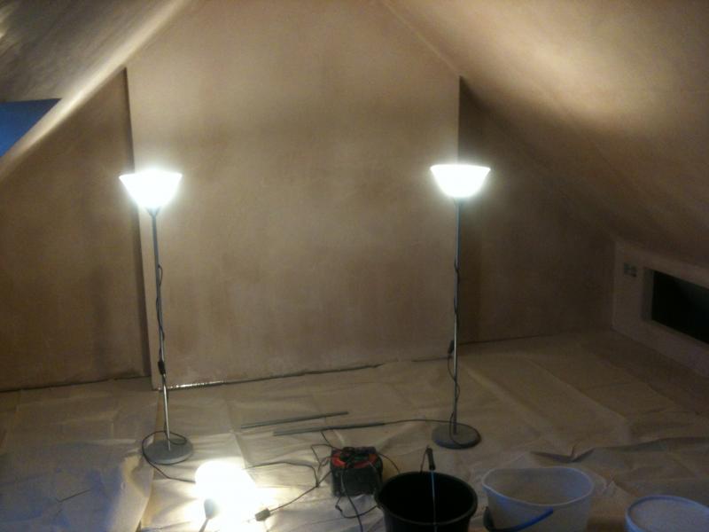

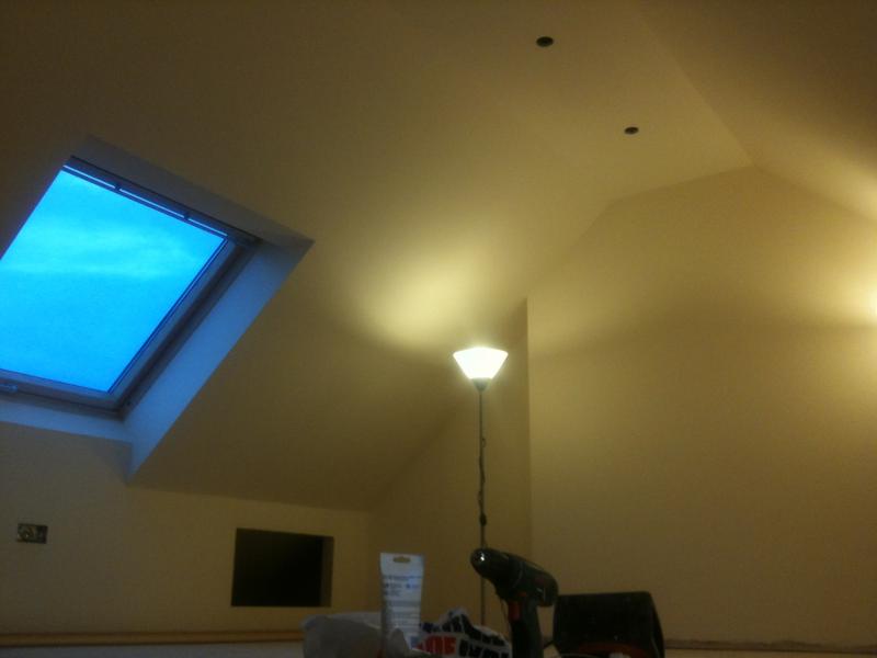

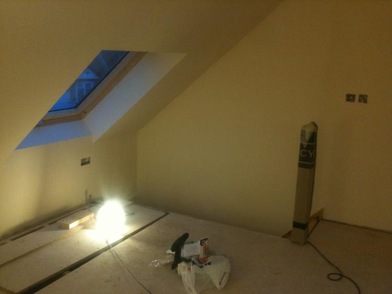

Plaster skim complete...
Painting complete (today)...

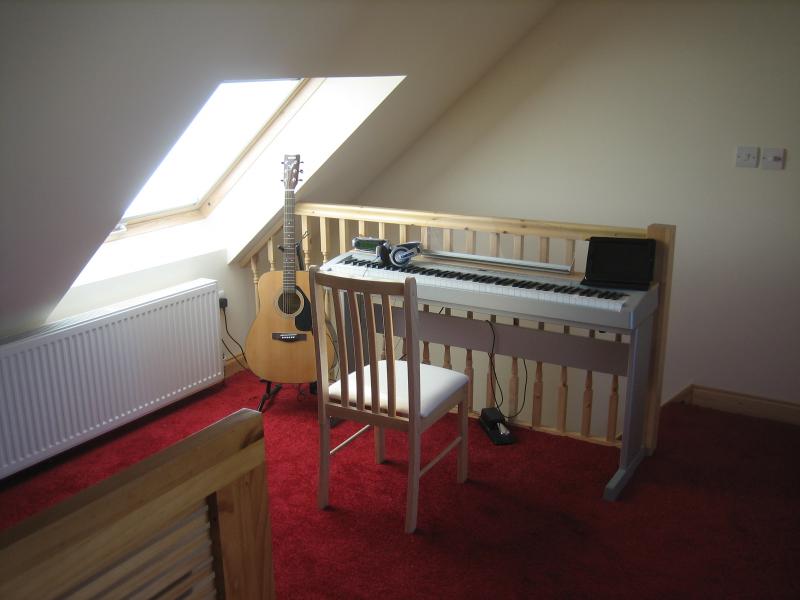

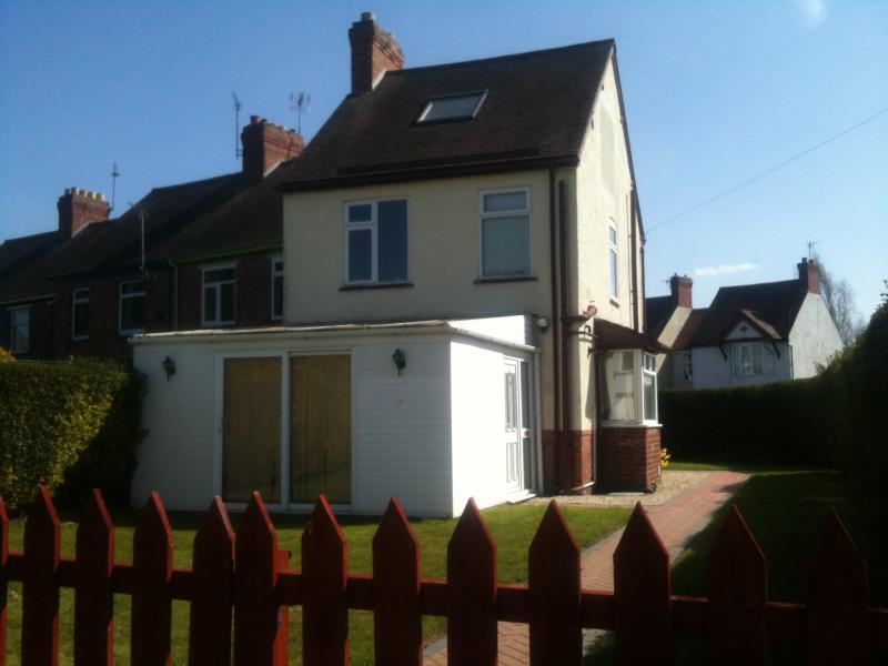

Well I'm finally there, the room is now carpeted and inhabited! Building control made their final visit a couple of weeks ago and gave it the thumbs up, the inspector was very happy with the build and found no faults. Here's a few pics....
