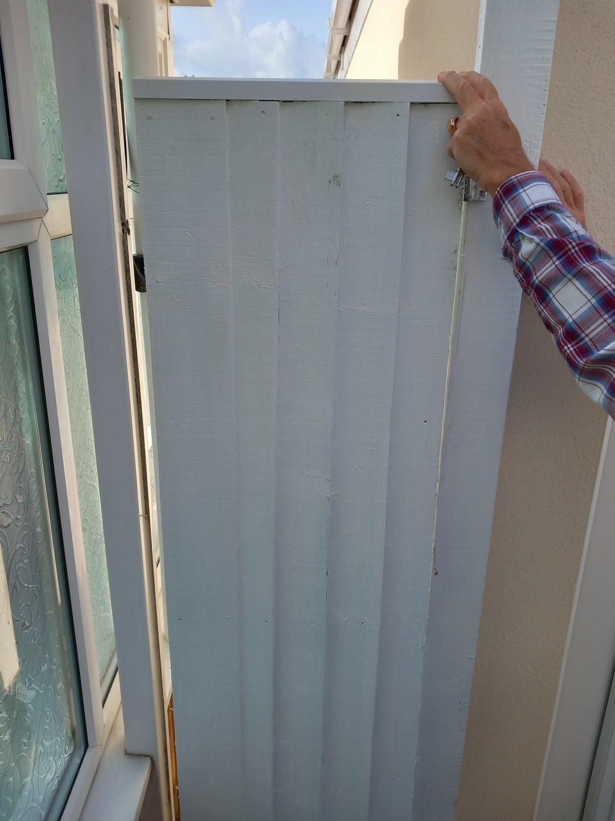

Hanging a narrow gate
The skinny gate (gonna open towards the camera)-
Maybe the photo, but - It doesn't look as if the hinges are positioned to actually work.
It's got one of those natty opening restrictions built in; so long as the hinges are screwed on with the pivot not quite touching the 4x2 it'll just about open to 90 degrees before it starts riving itself apart.
That's just what one needs when fitting a gate to the narrowest opening known to man; to make sure it stops 30 degrees short of where you'd expect it to to give reasonable access, and bounces back smacking you in the face as you try to pass
Security feature; forensics can identify the blood
How long do you think the hinges will last outside?

to be honest i would have planned the post to the outside face [round the corner]and perhaps stepped back about 4 inch so when the gate is attached and open the gate'post and handles would not impinge[interfere with] into the opening

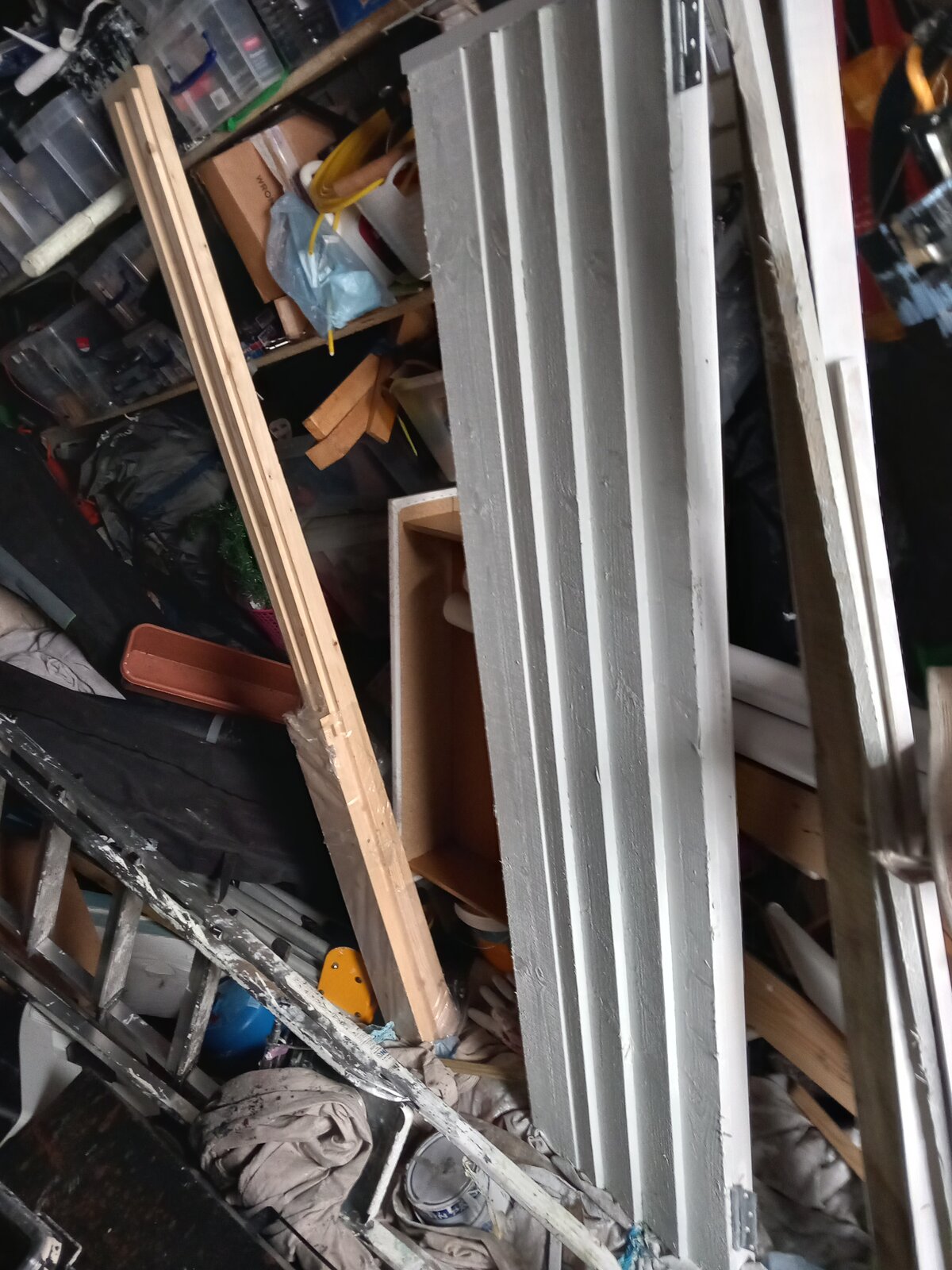

The gate's too small. He wants the 4 x 2 on wall facing the camera (to the right). The gap is narrow enough. Need to get 50mm added on. And will those hinges allow it open more than 90 degrees? I'll take it back to joinery, see if I can get them to sort it.
View attachment 284413View attachment 284413View attachment 284413
the trouble you have with those hinges fully open you have the full thickness off the gate in the opening
iff you use hoop and band hinges you can put the pivot point half way across the face off the post and the gate will be out off the way when open
