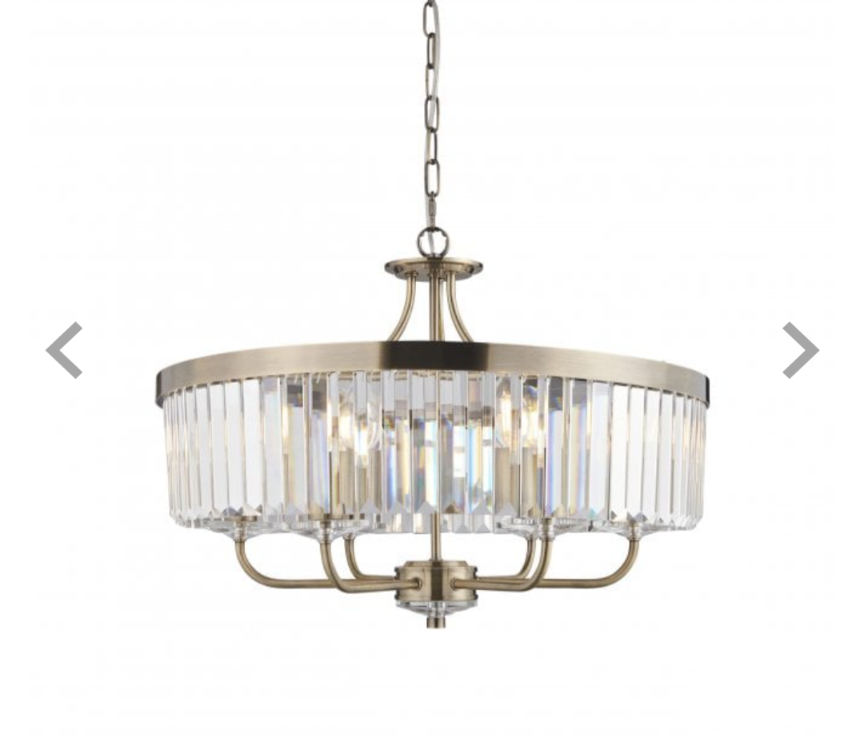

Thanks for the replies , the new light is the one still packaged. What you cannot see is the glass decor which hasn't been hanged on it yet as per picture which adds extra weight. 9kg is probs a slight overestimate as I am shortening the chain so likely 7-8kg but going to prepare for extra weight.

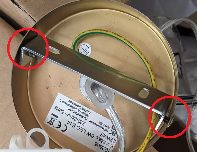

Thanks for the post above regarding beam supports. I thought two x long no 5 wood screws 80mm or so would be suffice? Plaster is 12mm thick.?

Do you really mean "No. 5" ? I'm not suree that I've ever seen such an animal, but it would be somewhere between No. 4 (~3.0mm) and No. 6 (~3.5mm). I would personally not use a screw smaller than No. 8, and would probbaly be inclined to use No. 10 (~5 mm).
Did you perhaps mean 5mm (roughly No. 10) ?
I would say that 80mm long would be overkill, and probably would be happy with 50mm or thereabouts.

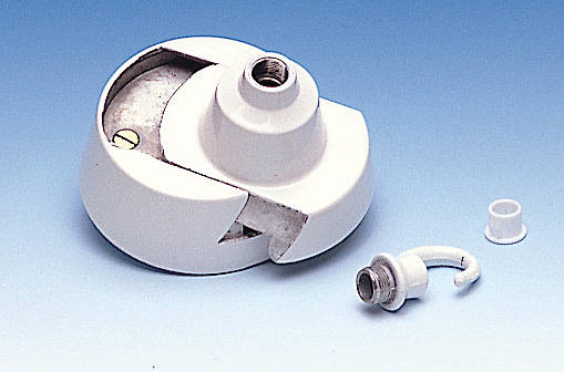

I used this View attachment 303189 which is seems has been discontinued, with the hook taking the weight I was not that worried, but to hang on the power cord yes I think 5 kg is a bit much ...
As I've said and illustrated in the past, I have a lot of those (in brass) in my house, including some mounted 'vertically' on walls, rather than 'horizontally' on ceilings, to support high uplighters (see pic below).
However, as I recently wrote, no matter how able the rose is to support a particular weight, the quality/.safety of the support will be totally dependent on how well the the 'rose' itself is attached to the ceiling/whatever - which, as I said, takes one back to the OP's issue/question.

Thanks you John yes sorry meant a 5x50mm screw. Will let you know how I get on. Thanks for the help :)

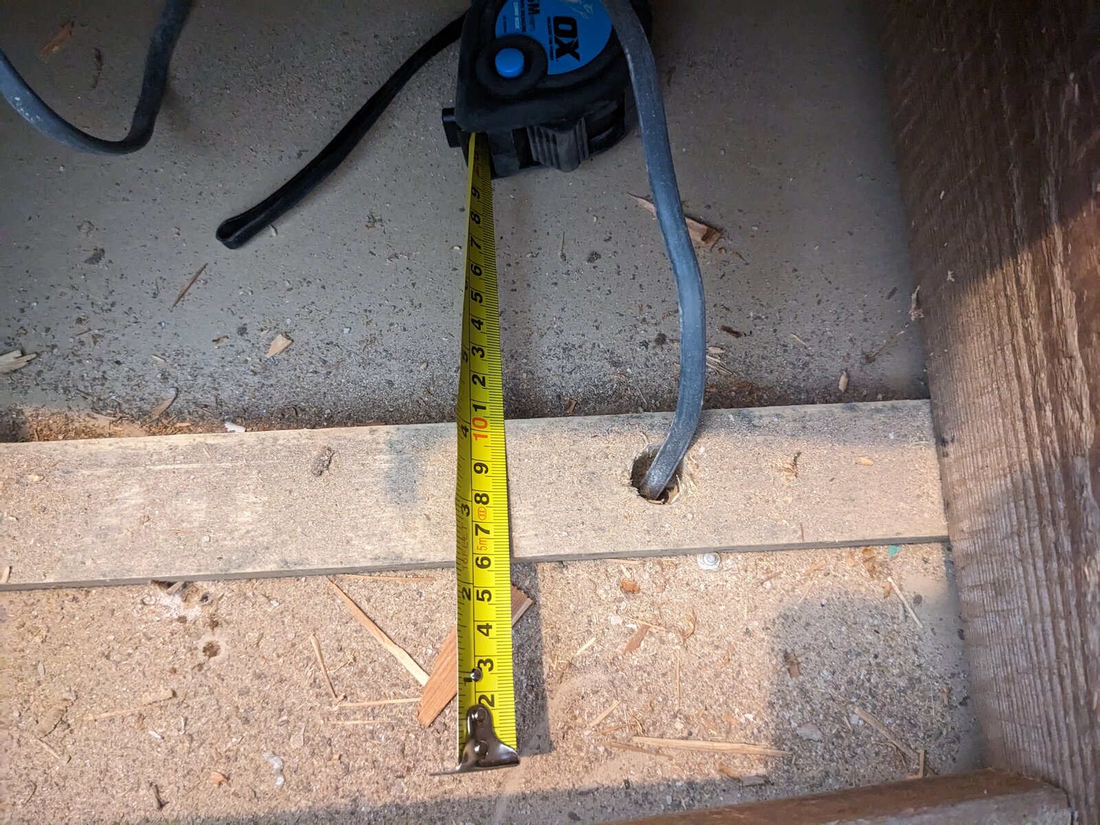

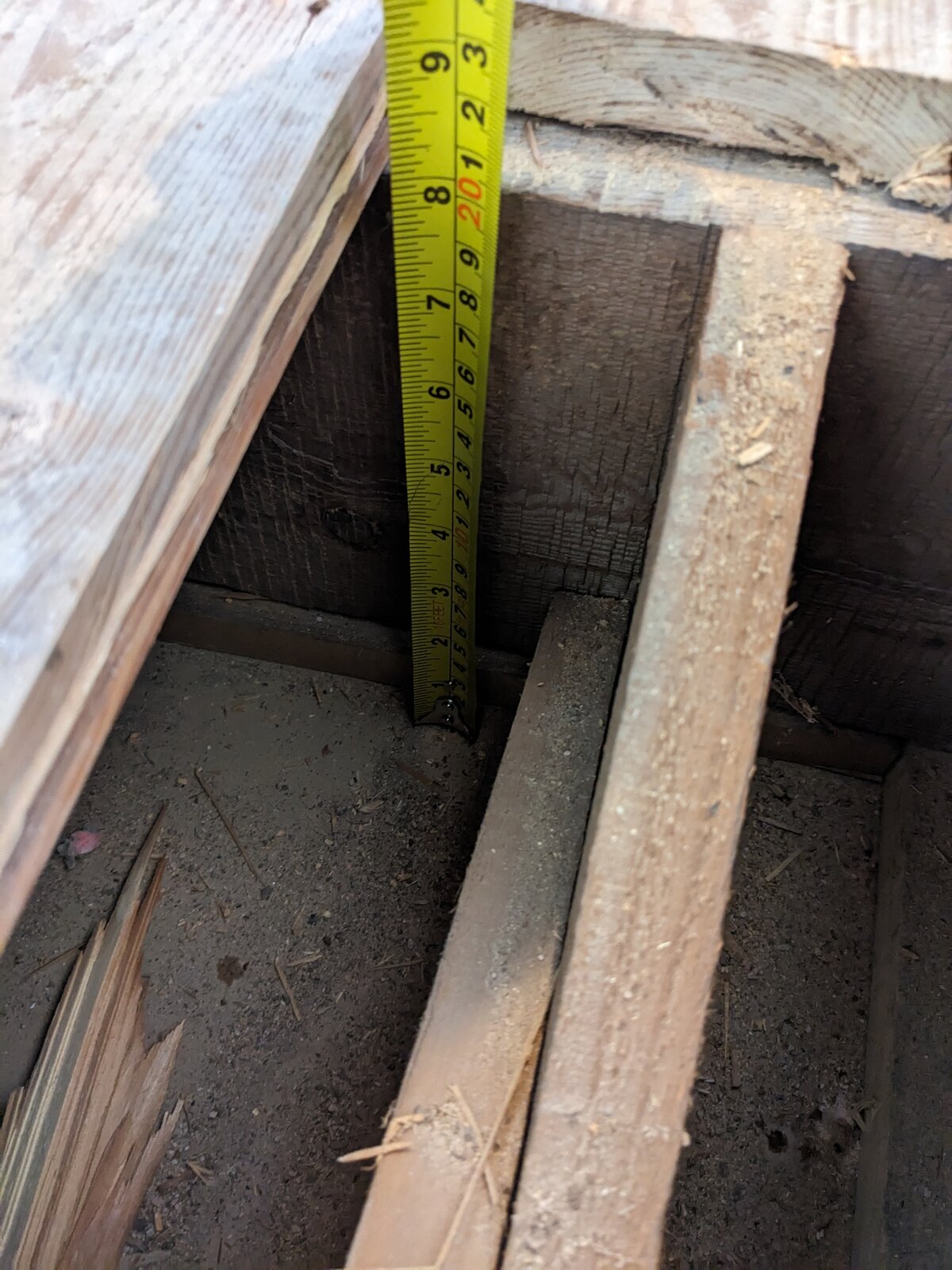

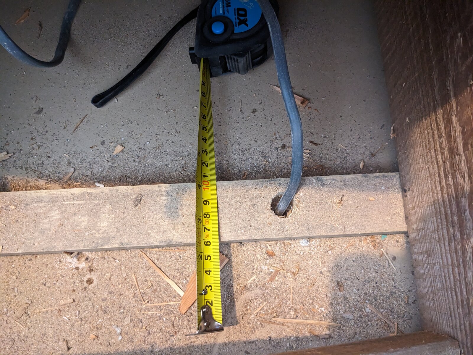

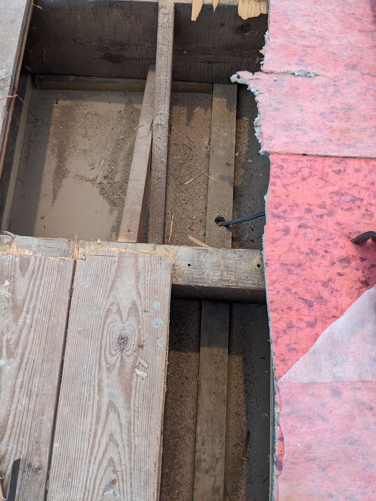

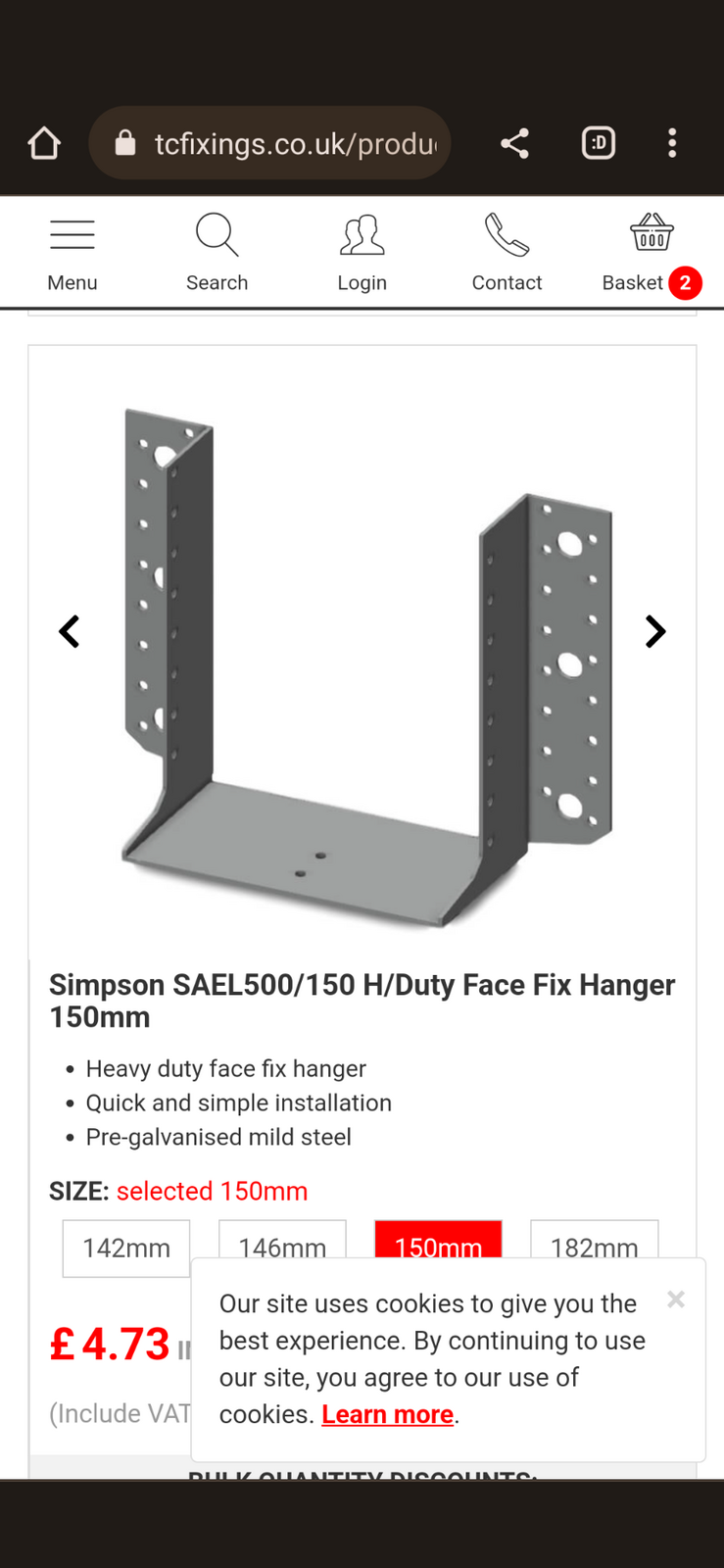

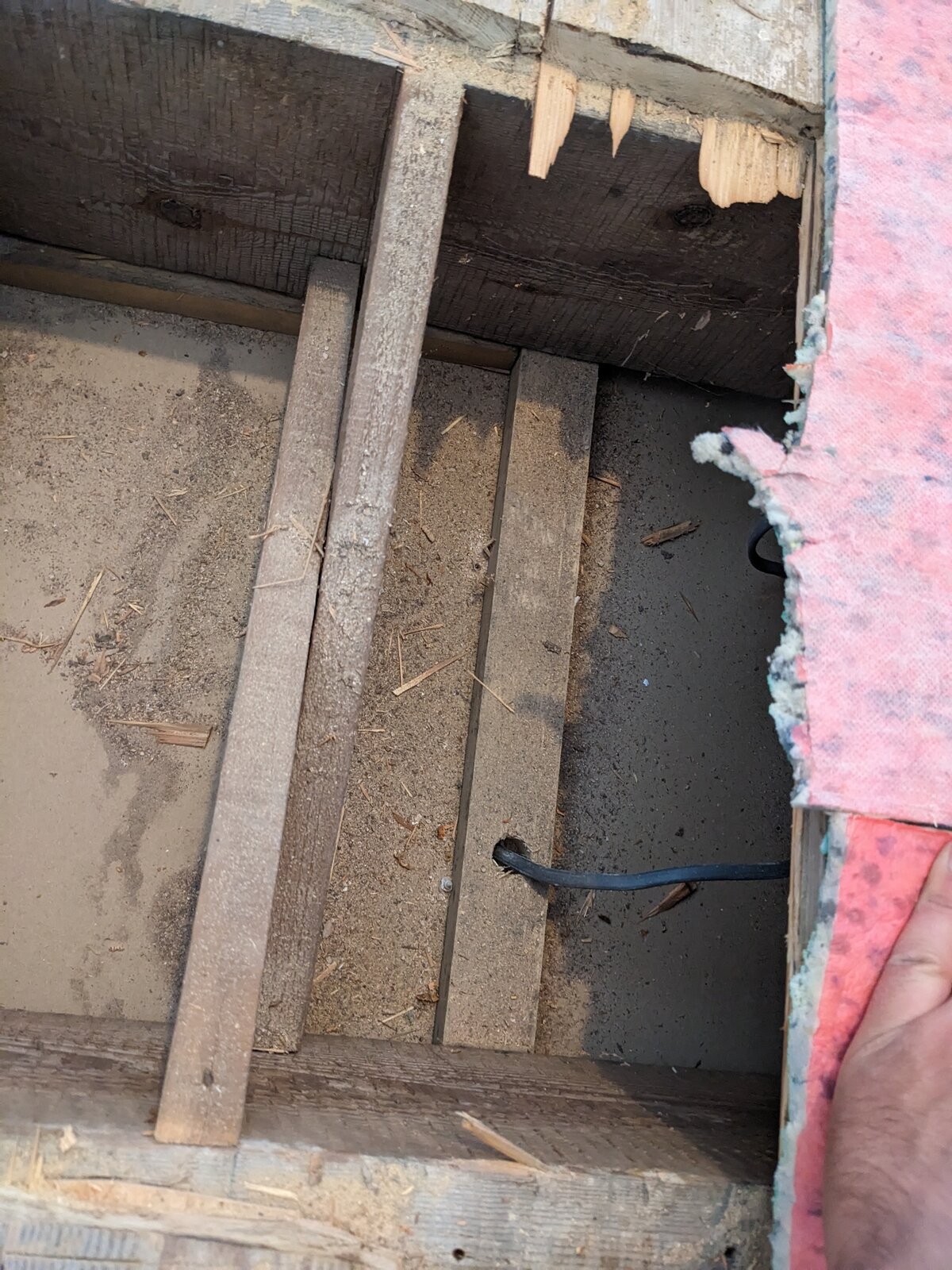

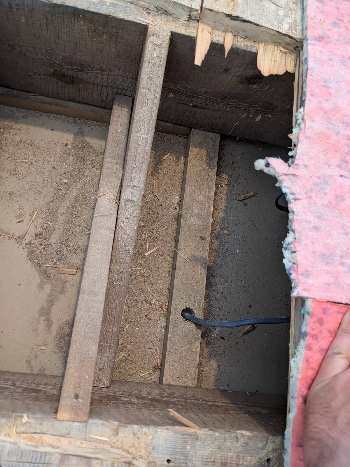

Hi just to update , moved some floorboards above and below the joists are Battons holding the plaster board up. I would have ended up supporting the new light via the Battons rather then the joists so glad to have checked.
To support the light thinking of using 2 of these 150mm hangers between the 2 joists, some timber in-between and then screwing the 9kg light into the timber between the hangers.
Would be great to get thoughts. Thanks

Thanks Chivers,
Trying to think what bit of 150mm x150mm timber to put in. It would only be a short stretch between the joists. Any recommendations for what timber to use?
Also is it worth bolting the hanger through the joist , by drilling a small hole or would some simple wood screws be suffice?
Thank you
Do you really mean 150mm x 150mm? That's enormous, and not all that smaller than the beam holding up two stories of part of my house.
What you propose would obviously 'work, but represents serious overkill. A piece of small timber (say about 50mm x 25mm) of any type, attached simply to the joists (just screwed or nailed or using small angle brackets) would be more than enough to support your 9 kg fitting.
Kind Regards, John
I think the thinking is 150 to go into the size of that hanger, doesn't need to be more than 50x50, in fact you could get a smaller hanger . 50mm perhaps?
Though Flameport's right unless the existing joist isn't in the existing correct place.
