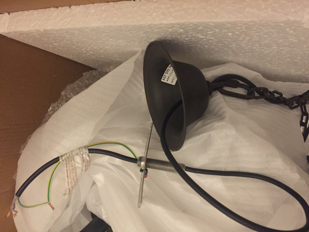

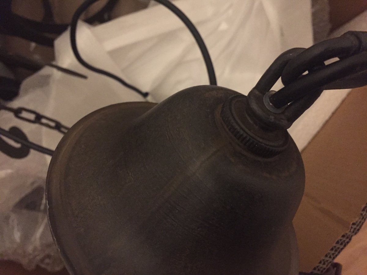

- what hook are you referring to? Do you mean the loop at the bottom of the cup that the chain is attached to? If so, I'm not sure it screws off the cup (It wouldn't shift with finger pressure). If I follow correctly, I don't think it needs to come off as the threaded tube comes out on its own but please do correct me. Here is a pic of the threaded tube undone from the cup:

Oh i see the hooks braised on the cup, not seperate, just do same but screw hook and cup on together.

Yes you cut the links with hacksaw open with pliers and take off one or a section, the screw up link, is to asssist fitting too, as you need to spin the cup/hook about 10 times to tighten, which you cant do when its wired in, so you spin it on then rejoin the chain.
Solid link chain and screw up links are used as they are stronger than split link chain due to the weight of your fitting
You only need use 1 screw up link

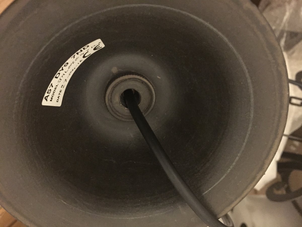

Can you post pic of inside the cup
That's starting to make sense. A problem I might have if wiring in the ceiling void would be the separate earth wire from the plate might not have enough length to get up there. So I might have to bring the wires back down. Here are a couple of other photos of the cup as requested.

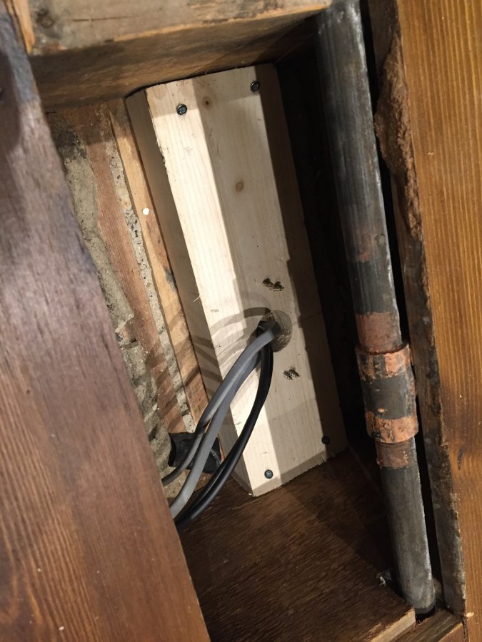

When screwed in, the threaded tube will be flush with the noggin - I'm guessing I could use a hole saw all the way through the noggin and given that I will have access then, I could tighten a bolt onto it?
Well, if you could you'd need a box spanner to get down to the nut.
Still in your court is the question of whether, when the rose is hard up to the ceiling, the threaded rod is far enough above the bracket for a locknut to fit. If it would be then ditch the noggin, replace it with a sheet of ply flush with the top of the plasterboard and held to the joists with battens, and a large hole in it to allow good access to the nut.
I could then also have the wires entering the ceiling void via this route too?
How else would you ever consider doing it, given that the flex runs through the threaded tube?

Personally I would try to find a longer length of the hollow threaded rod that was long enough to reach above the top of the nogging. Then the chandelier can be assembled securely onto the rod with a lock nut to ensure the chain bracket could not become loose on the end of the threaded rod. Then pass the treaded rod up through the nogging and fit washer, nut and lock nut on the top of the noggin.

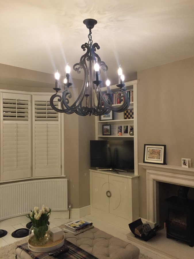

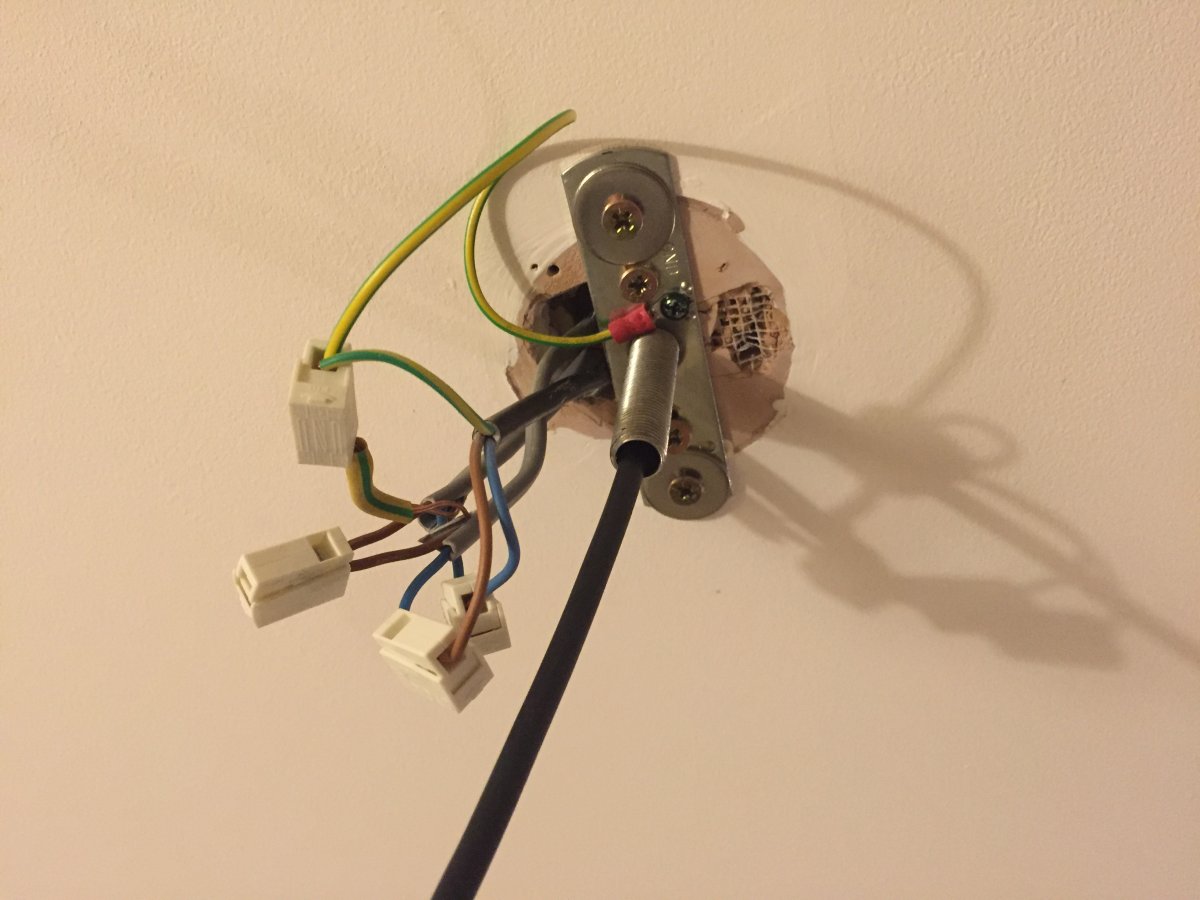

Thanks for all of the help, cracked on with it this evening and just finished it. Pictures below of what I did. I would've ideally got a longer hollow threaded rod and fixed a lock nut but seems like that size was hard to find. I'm somewhat amazed Oka don't provide something to make this quirky setup more secure. Thanks again for the helpful replies.
That shouldnt go nowhere,10mm thread is sturdy and hopefully the bottom cup on at least 5 turns i assume, thats best having the connecters below, under the floor is NOT accesible and them connecters would be against the regs under the floor.
Nice to see the result, thanks
