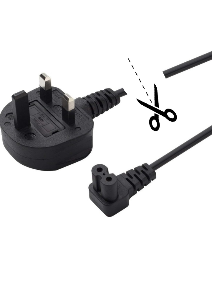

Hello,

I don't see an issue as long as the cable is rated at or above the rating of the fuse in the outlet.
5A should be sufficient for any TV.
You may well find that it has a 13A fuse fitted. Extension or not, this should be swapped for a 5A one.
BUT... chopping off the plug shouldn't invalidate the warranty anyway, you may be solving a problem that doesn't actually exist.

Just cut off the plug.
Or even if the OP was truly concerned, they could buy another lead and cut the plug off that one!
Why would you need a 5 A fuse in the FCU assuming the plug of the TV already has one fitted and the extension lead is suitable for 13 A?
Of course there‘s no need for a larger fuse but I can‘t see any reason to replace an existing 13 A one.
