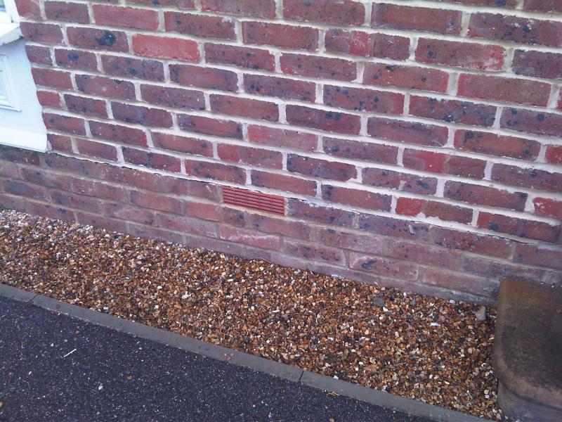

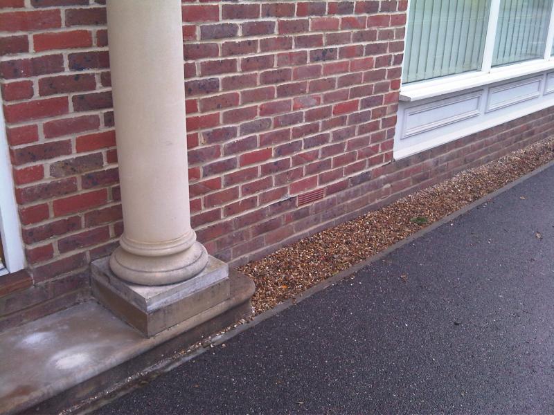

Nice pictures wyl,,
Those airbricks are merely "cavity wall" vents and have nothing to do with floor ventilation.
Only wooden joist or block & beam sub-floors have airricks for the purpose of venting the void beneath. The sub-floors in these houses are solid concret and sit just below DPC level.
You can clearly see in pic1 that the airbrick (cavity wall vent) sits below DPC level.
Concrete slab sub-floors DO NOT have airbricks !!!!!!!
Interesting aswell that in pic1 the top step of the block paving sits above the DPC clearly bridging the dampcourse !! Wern't building reg's on site when they did this ?

So in your professional opinion these have nothing to do with the house climate and are not worth checking to see if they're causing problems.

Just admit there is no substance to what you are saying. And no, those are cavity wall vents, and have nothing to do with concrete sub-floors.
If they were airbricks that vent voids under wooden sub-floors then yes they would be checked as a matter of course, it takes 2 seconds to look through one and few more seconds to clear if they are blocked. I doubt a cobweb in a cavity wall vent would seriously change the house climate lol.

Not much point in clearing them out in this case though if the builders have already bridged the dampcourse!! Something you would have spotted i presume while sniffing for damp !!
