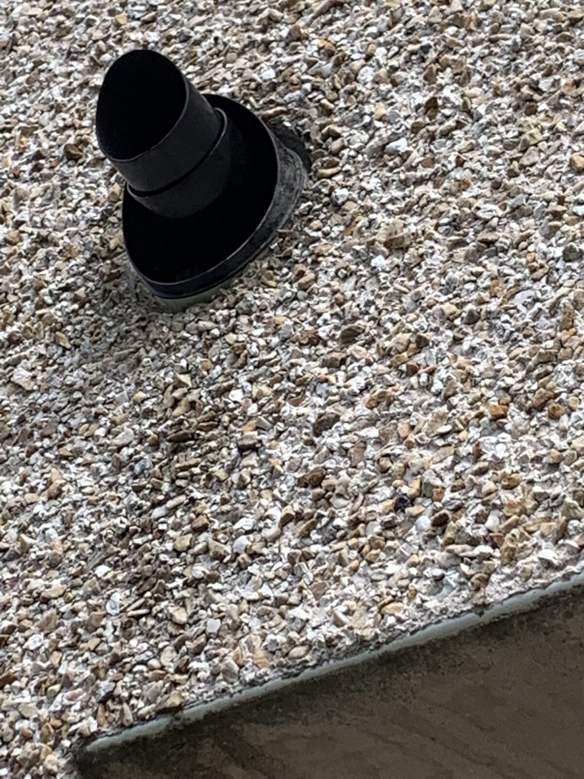

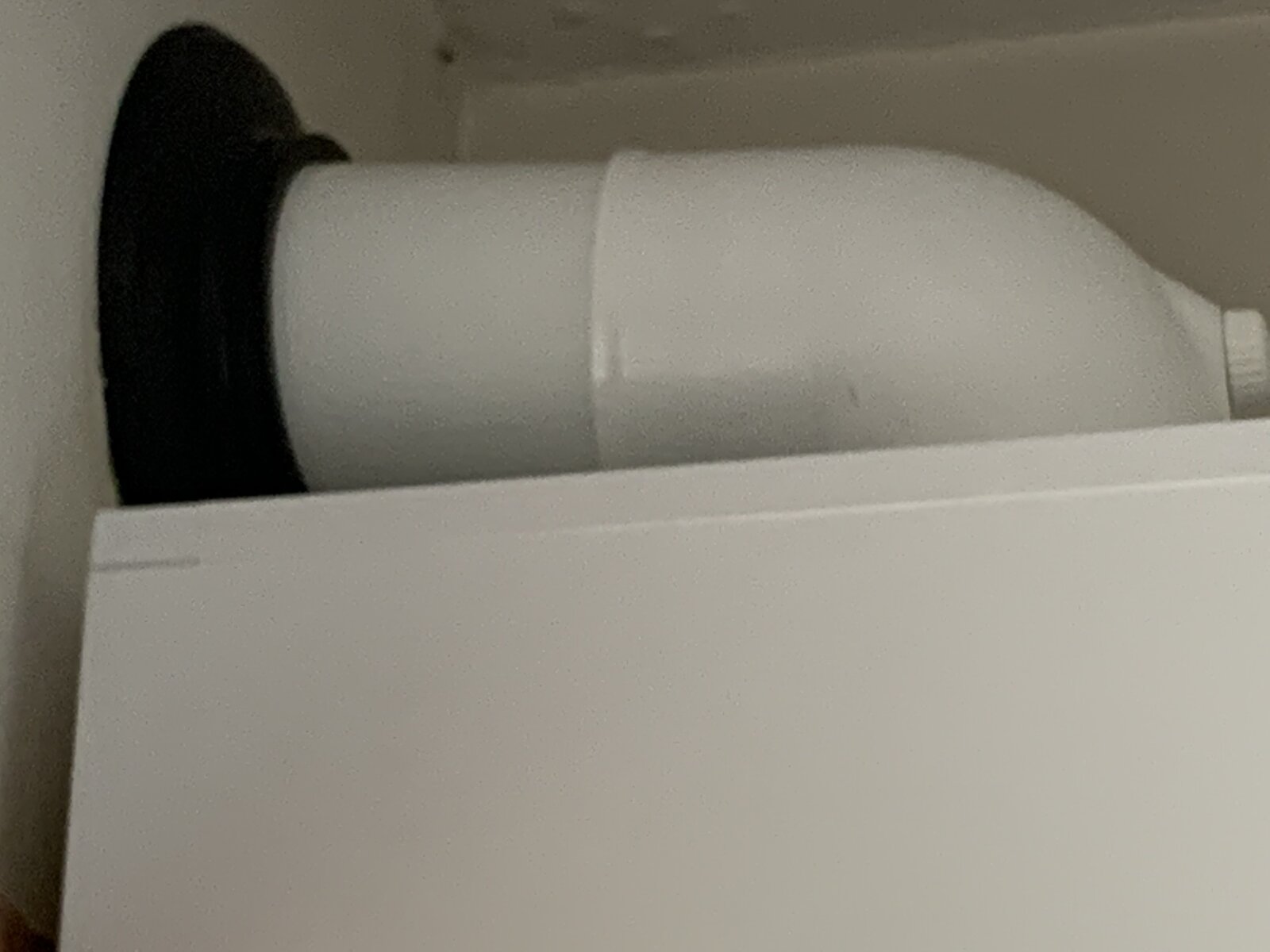

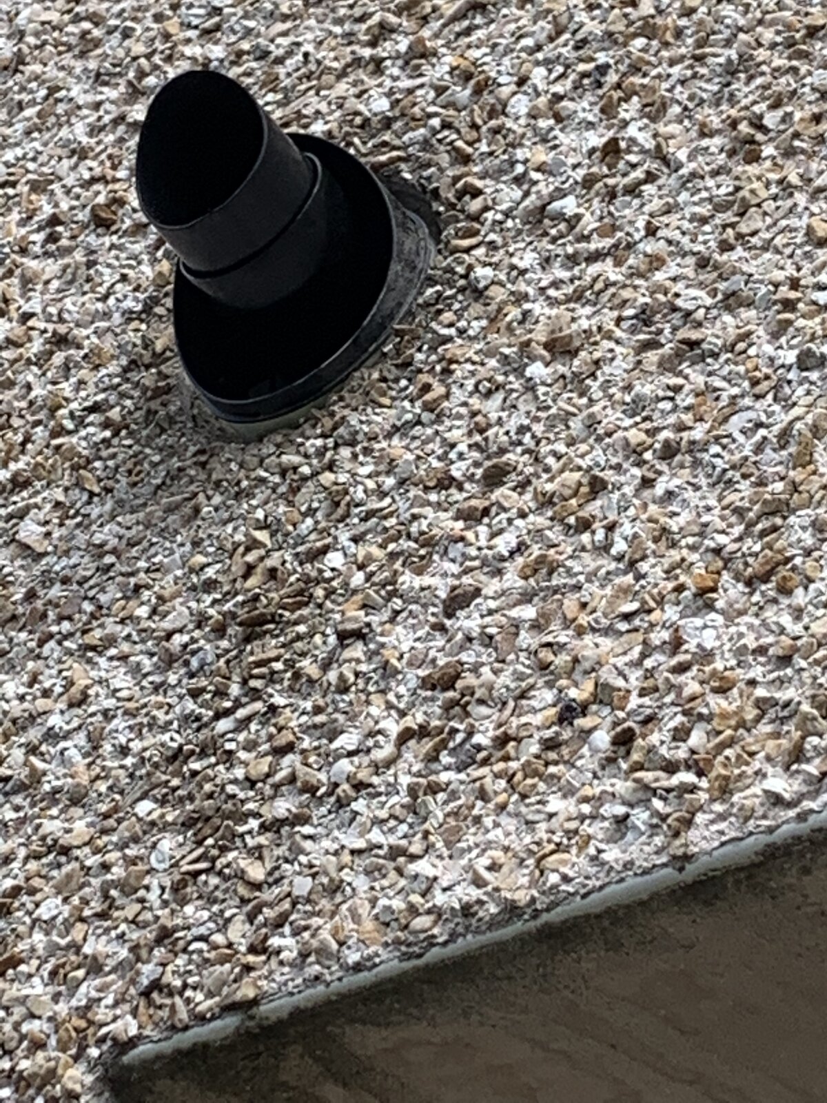

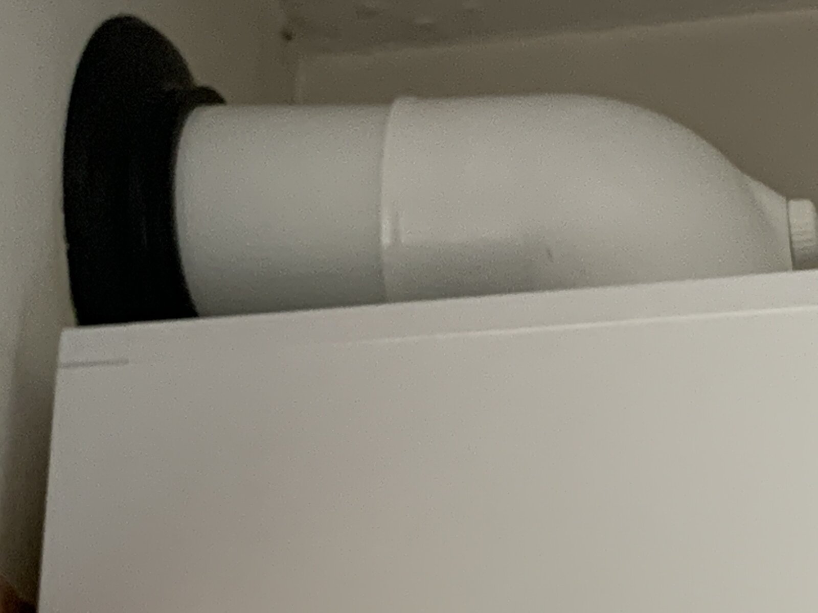

Couple of pics of the flue

Well gas safe may mention that the flue not being sealed properly, can't be sure if the camera angle or not. The black collar on the inside though is a weathering collar and should be on the outside, he may have cut the flue a little short and therefore the collar wouldn't fit where it needs to on the flue itself but again may be the camera angle.
There may also have been a white internal collar supplied too, not sure with that boiler.
