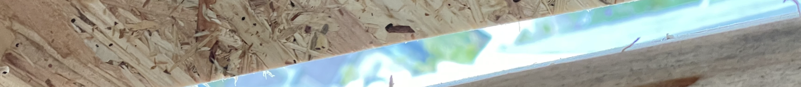

We are in the process of having a huge dormer built. The approved drawings the builder is working from says single layer membrane roof covering bonded to19mm plywood, also sides from 25mm plywood (exterior grade ply). The builder has used 11mm OSB3 board all over (also gaps all over between boards - you can see daylight) and has purchased a load of GRP.
We are not living in the house so we didn't know - only the boards are up so it is not too late to change, but obviously an unpleasant conversation for the builder who has been great up to now. It is (what I would class as) the world most expensive roof (already feel like we are paying a ton for it - so has to be right).

@RandomGrinch Thanks - I wouldn't mind if they checked in with me first. There are loads of gaps between the boards. Would it be advisable to double board (they said gaps are because they ended up getting board from two different places - and they didn't fit together well so they had to remove the tongue from some).

@sxturbo @Notch7 These are cold dormers finished with GRP (didn't know the difference until recently - too late now as the job is well underway) - the dormers were specified by the architects as part of a bigger job. They will be tile hung fronts and cheeks - they are not finished yet - we have a couple of large OSB boxes at present (front dormer has not got gaps, rear larger dormer has load of gaps between boards).
Spec for roof was 19mm ply, insulation on the inside of 100mm Kingspan between joists, then layer of 45mm PIR insulation on underside of joist and a layer of 12mm plasterboard.
Builder has gone with single layer OSB3 instead of ply, they will have the 100mm Kingspan, but saying no such thing as 45mm PIR so going with 25mm PIR. Instead of 12mm plasterboard, I'm opting for 2 layers of 12.5mm acoustic board off clips and metal furring strips - to reduce noise.

I had considered asking the builder to double board the OSB to get rid of the gaps (they already said they are doubling up on the cheeks - gaps are worst there.
Also, do we need an air vent.
11mm OSB is too thin for using as a deck for GRP. Daylight between boards indicates square edged rather than T & G so all the joints will have to be supported and taped (otherwise you'll get holes in the laminate).

no, gaps simply because they had to cut the tongue off as ended up with two types of T & G that did not fit together - one dormer has no gaps - as it was all the same board - the other has loads of gaps - some examples - from smallest to worst.

Your project manager should be all over this, BCO may well twist about OSB instead of ply (very different structural strength and properties) and will almost certainly reject 25mm PIR instead of 45mm (presumably 45mm was specced to make the SAPS sums work).

@oldbutnotdead, thanks - yes, I had a good call with BCO today - they have accepted all changes saying the architect over spec'd - the builder is still proposing minimum or higher than minimum.
