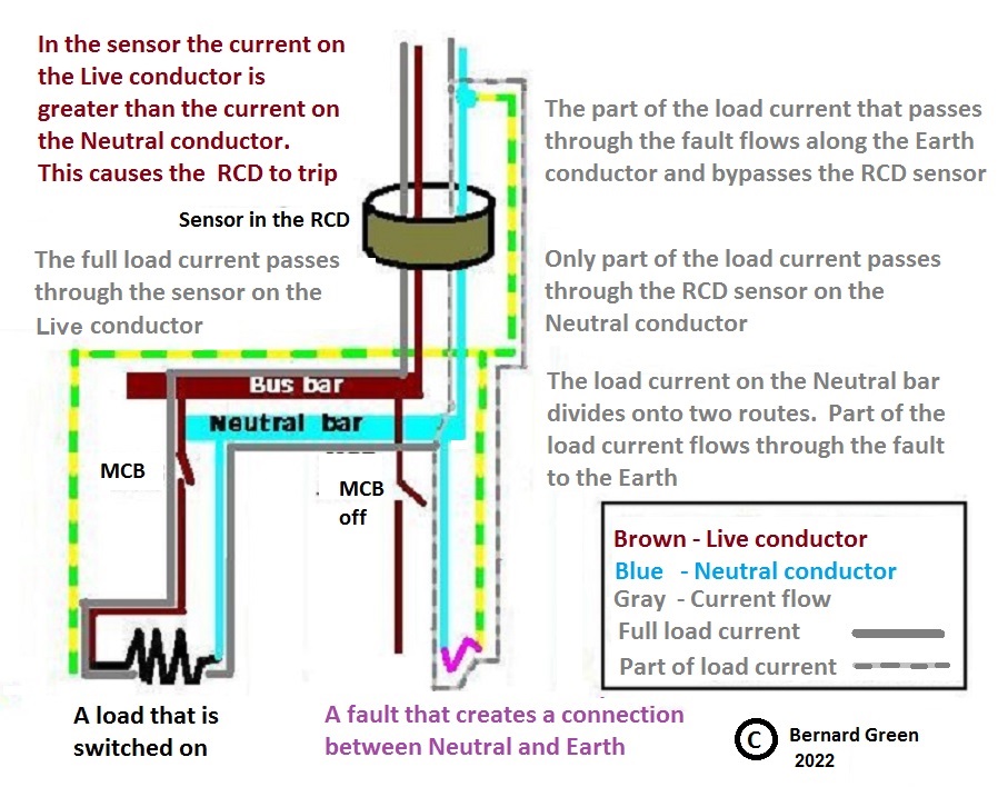

Yes, for the convenience of being able to fully isolate a faulty appliance in order that the RCD that is being tripped by that faulty appliance can be reset and thus restore power to the circuit

The best way to fully isolate an appliance is to pull the plug. For a cooker (the only appliance that needs to be hardwired) flip it’s MCB.
(1) It may be difficult and/or time consuming to remove a plug from the socket if that socket is behind the appliance and the appliance is heavy.
(2) Most MCBs when tripped disconnect only the Live, they do not disconnect the Neutral
Leaving the Neutral connected means that if the appliance has a Neutral to Earth fault then the RCD will continue to trip when there is a load on other circuits protected by that RCD

1. If the appliance is faulty it needs moving anyway.
2. True. Cookers (the only appliance that needs hard wiring) usually have element leaks not neutral earth shorts.
It will need moving at some time but the urgency would be to restore power to the affected circuits by a reset of the RCD.
Element leaks ? Leaks from where to where ? Are these "element leaks" you refer to just leakage from Live to Neutral without any involvement of the metallic sheath of the elements affected.
