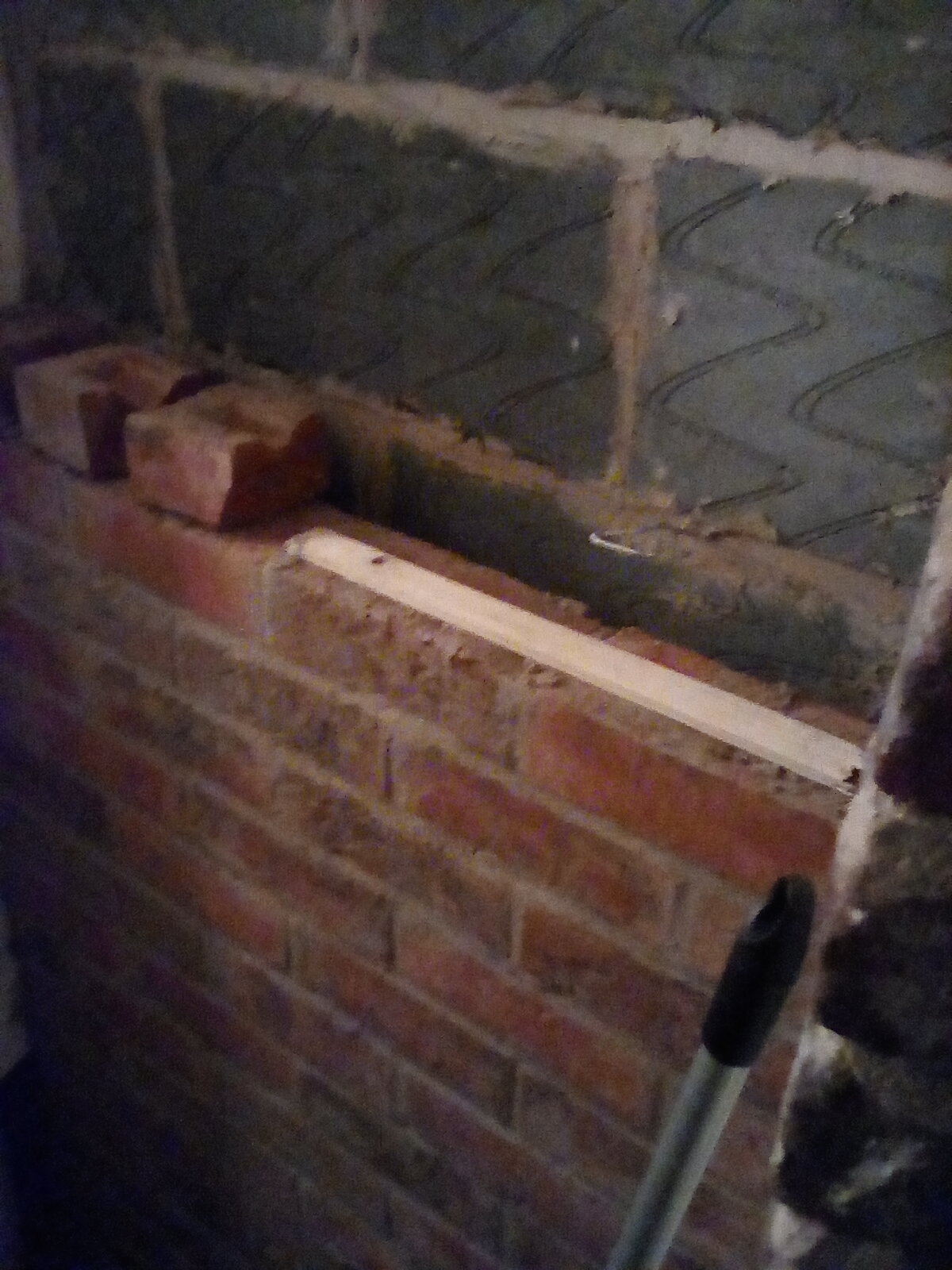

This is some brickwork I did about 4 weeks ago, using a 6/1/1 blocking up a door at home. My wife wanted a rustic looking brick and joints, as it's an old cottage. It's a flush joint.

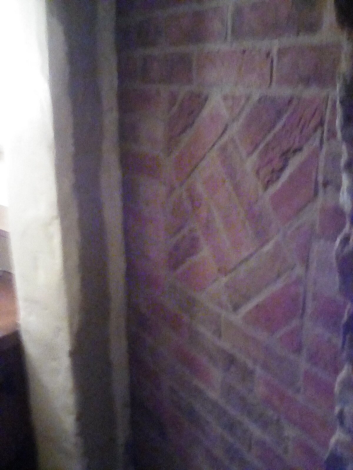

On pointing style, my uneven brick joints did make it hard work to use the brick jointer (the half round style). But it's come out ok. I need to get some more sizes of brick jointers for the various joint widths that are all over my house.
Some of the perps were so narrow I widened them with an angle grinder. Others were nearly an inch in width.
