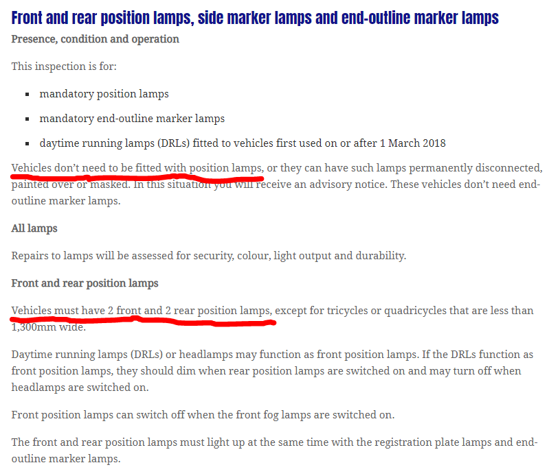

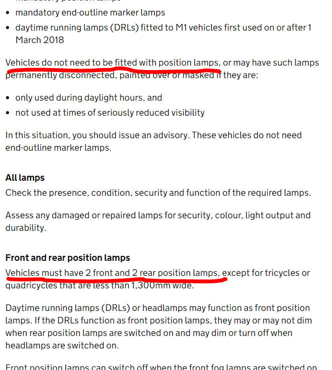

He did not say "permanently disconnected, painted over or masked, that are only used during daylight hours, and not used at times of seriously reduced visibility".

You could see if your local test station is amenable to giving you an MOT pass with an advisory that your vehicle was not fitted with lights at the time of test and must be used during daylight hours only.. It's fairly common for motorcycles, but note that that in that scenario there are no lights fitted to the vehicle, and that's different to your scenario of "fitted but not working". Whether the tester will accept that you pulling the plug out of the back of the light is "permanently disconnecting" it is for your tester to advise
That cannot say that. All they can say on the advisory is something along the lines of “Headlamps permanently disconnected at time of test. Headlamps not tested”
Unless the tester can see that the lamps are connected at the time of the test, they have to accept if told, that they are disconnected. They are not allowed to remove any covers to check the connection.

Forget anything other than the official inspection manual which testers have to refer to. This is the section on lighting.
That's all true.
But if such a vehicle is presented, with headlights fitted and not obscured in anyway by paint or masking etc then it has to be assumed the car is used in conditions that require headlights, and as such will fail the test, unless the presenter explains and justifies how and when the car is used.
If the car is to be used only in daylight hours and not at times of reduced visibility then the tester has to take note of the conditions on the day and time of the test. For example if the car has been driven to the test centre in poor light or poor conditions, then it is not used under the circumstances that allow for lights to be not working, and will (or should) fail the test.
