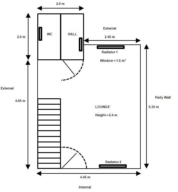

Hoping someone can help, I am trying to do some heat calculations for my Lounge, as I think that my current radiators are undersized for the size of the room and characteristics:
I have looked at on-line calculators, but none seem to cover the case where a room is open to the stairs. How do you go about calculating this?
Do I need to consider the Porch which includes the WC and Hall, or just the lounge?
If it helps current radiators in the lounge are 1149 x 530 single with fins (I believe about 985w each), house is 10 years old. Not sure that the pouch roof is insulated, but believe the house has some form of insulation.
As the thermostat is in the lounge, I measured the heat up times for the lounge last night. Heating turned on at 5:45 it was 13.0 degrees (6 outside) at 6:45 it was 16.0 degrees and by 19:30 it was 18.5 degrees. All radiators get too hot to touch longer than a few seconds and all over.

Galoka, things for the link I will have a look at it. Are you saying that I calculate the Heat Loss for the landing separately block, i.e. Length, width and Height of landing with one external wall. This would then be added to the lounge calculation, it give the overall amount.
D_Hailsham, all dimension are included in the drawing. The window is 1.5m2 and above radiator 1.
Are you saying I work out the area of the 2 External walls and floor and add the window loss using the u values provided?

Assuming for simplicity that the room is a rectangle 5.35m x 4.45m you get
External wall
Area = (5.34+4.45) x 2.4 = 23.52m² less window area (1.5m²) = 22.02m² x 0.45 (U value) = 9.92 Watts per °C
Window
Area = 1.5m² x 3.1 (U value) = 4.65 Watts per °C
Floor
Area = 5.35 x 4.45 = 23.81m² x 0.45 (U value) = 10.71 Watts per °C
Party Wall
Area = 5.35 x 2.4 = 12.84m² x 1.33 (U Value) = 17.08 Watts per °C
Ventilation
Room volume = 5.35 x 4.45 x 2.4 = 57.14m³ x 0.33 (specific heat of air) = 18.86 Watts x air changes/hr Watts per °C
External walls, floors and air changes are usually calculated for -1°C outside and 21°C inside - a difference of 22°C
Party walls are calculated assuming a 10°C difference
Ventilation rates can vary depending on type of room, for a living room a rate of 1 to 1.5 changes/hour is normal.
So loss from external walls, window and floor will be:
9.92 + 4.65 + 10.71 = 25.28 x 22 (temp difference) 556.16 Watts
Party Wall = 17.08 x 10 (Temp difference) = 170.8 Watts
The total loss through the fabric is 556.16 + 170.8 = 726.96 Watts
Ventilation = 18.86 x 1.5 (Air changes) x 22 (Temp difference) = 622.38 Watts.
Total loss = 726.96 + 622.38 = 1349.34 Watts
As you can see the ventilation loss can be a significant part of the whole, which is why draft proofing is so important. Obviously an airtight room is not achievable, and certainly not desirable!
Use the same method to calculate losses on the landing. You ignore any floor losses as there will be no temperature difference.
You have approx 2kW of rads, so that is probably sufficient.

D_hailsham thanks for the comprehensive response. I have managed to get my head round it. In answer to your questions:
Does you boiler cycle a lot? Not a great deal
Where is the room stat located? Bottom of the stairs (lounge)
Do you have TRVs on the rads? No just upstairs bedrooms
Do you keep the doors closed upstairs? Yes[/quote]
The boiler does not appear to be oversized and the stat is in a sensible position.
TRVs on the rads in hall, WC and the other rooms would be a sensible thing to do.
Keeping upstairs doors closed does mean that the landing has to be heated from downstairs, so you have to take this into account when sizing the the living room rads.
It might be worth experimenting with some of the upstairs doors open , so the heat filters out of the bedrooms to warm up the landing.
