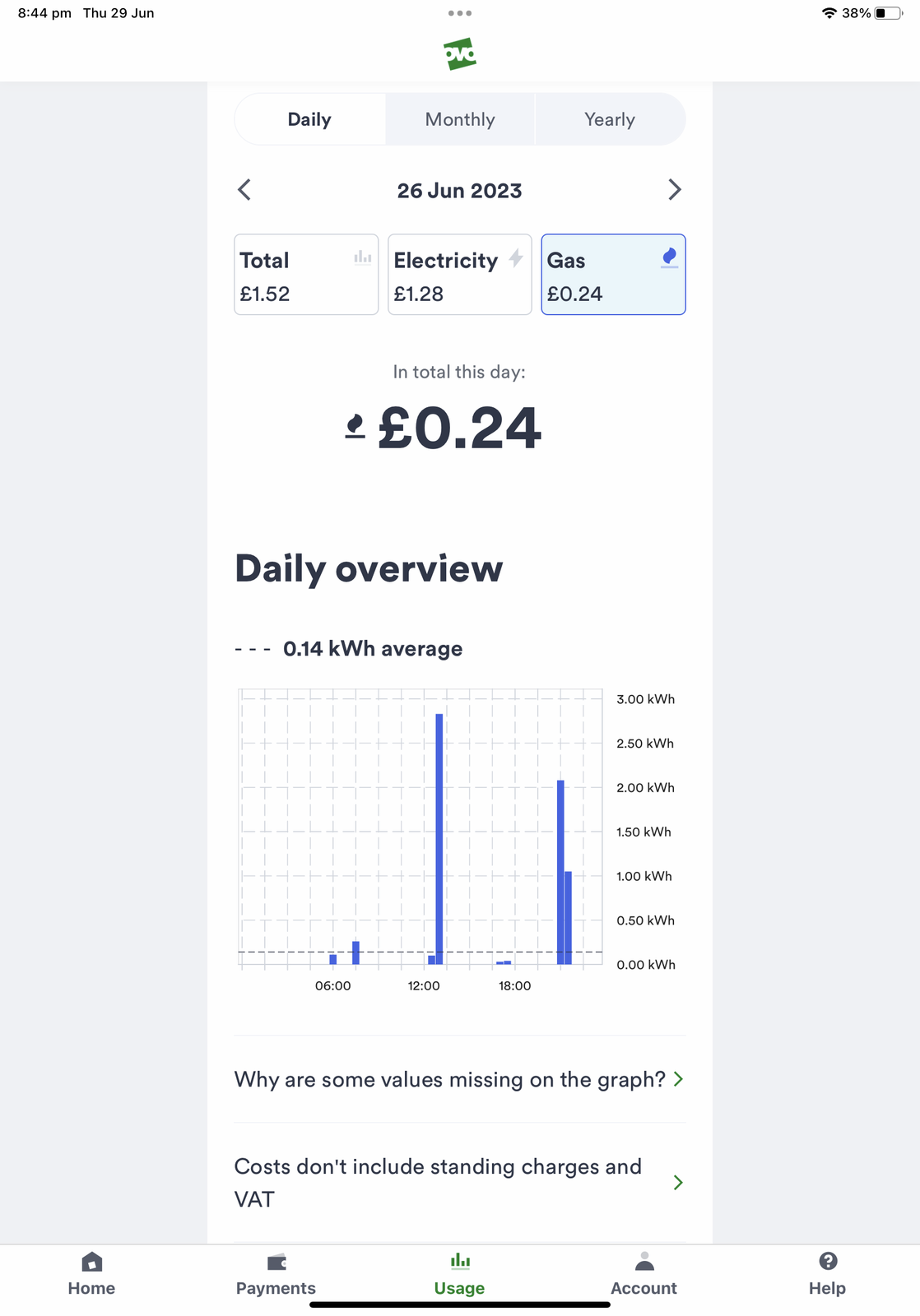

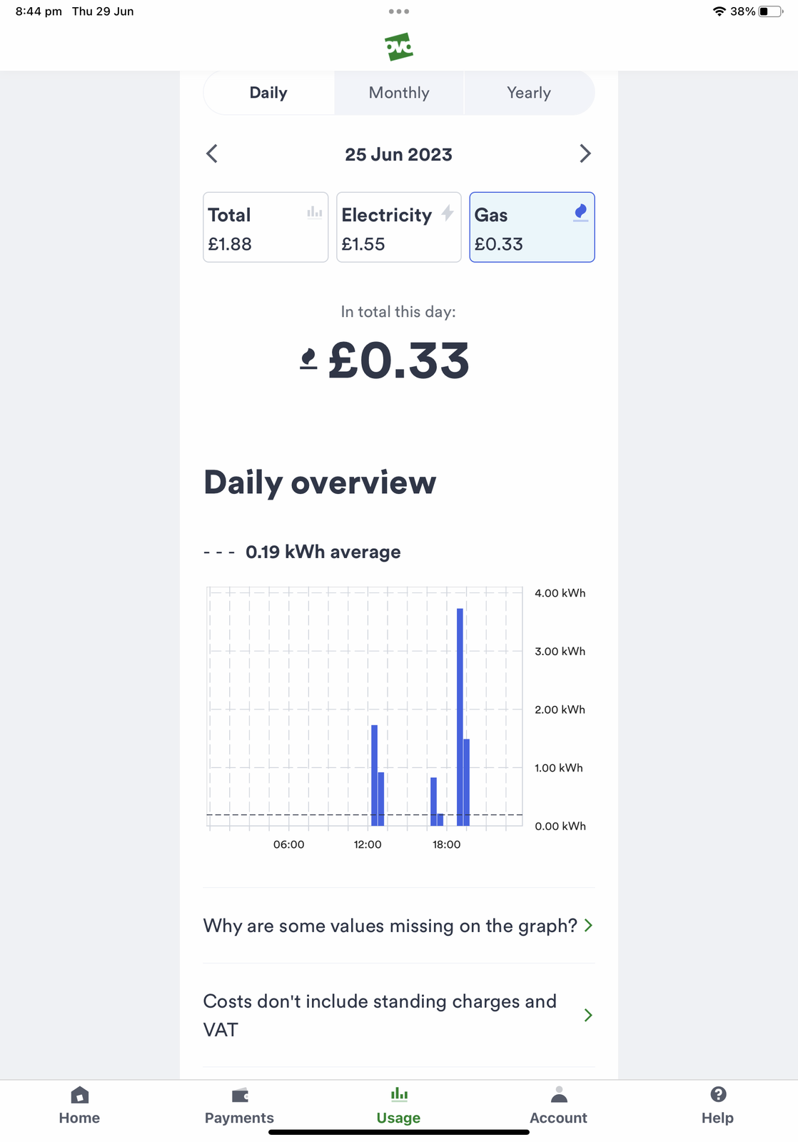

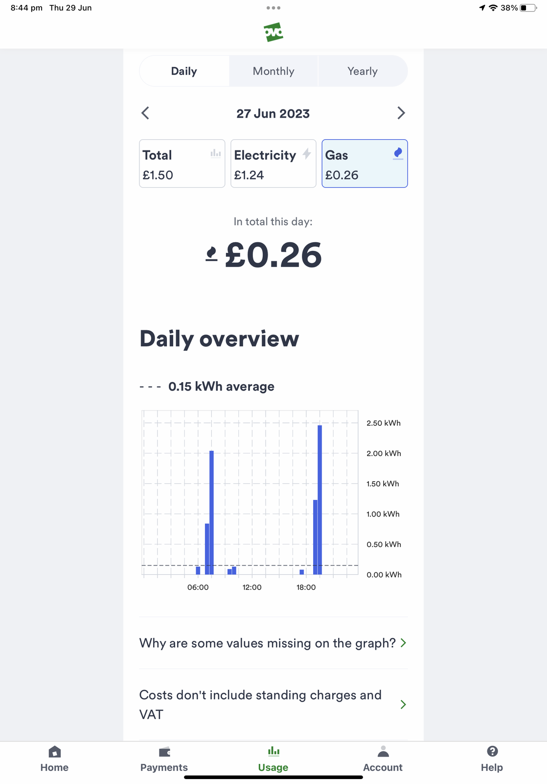

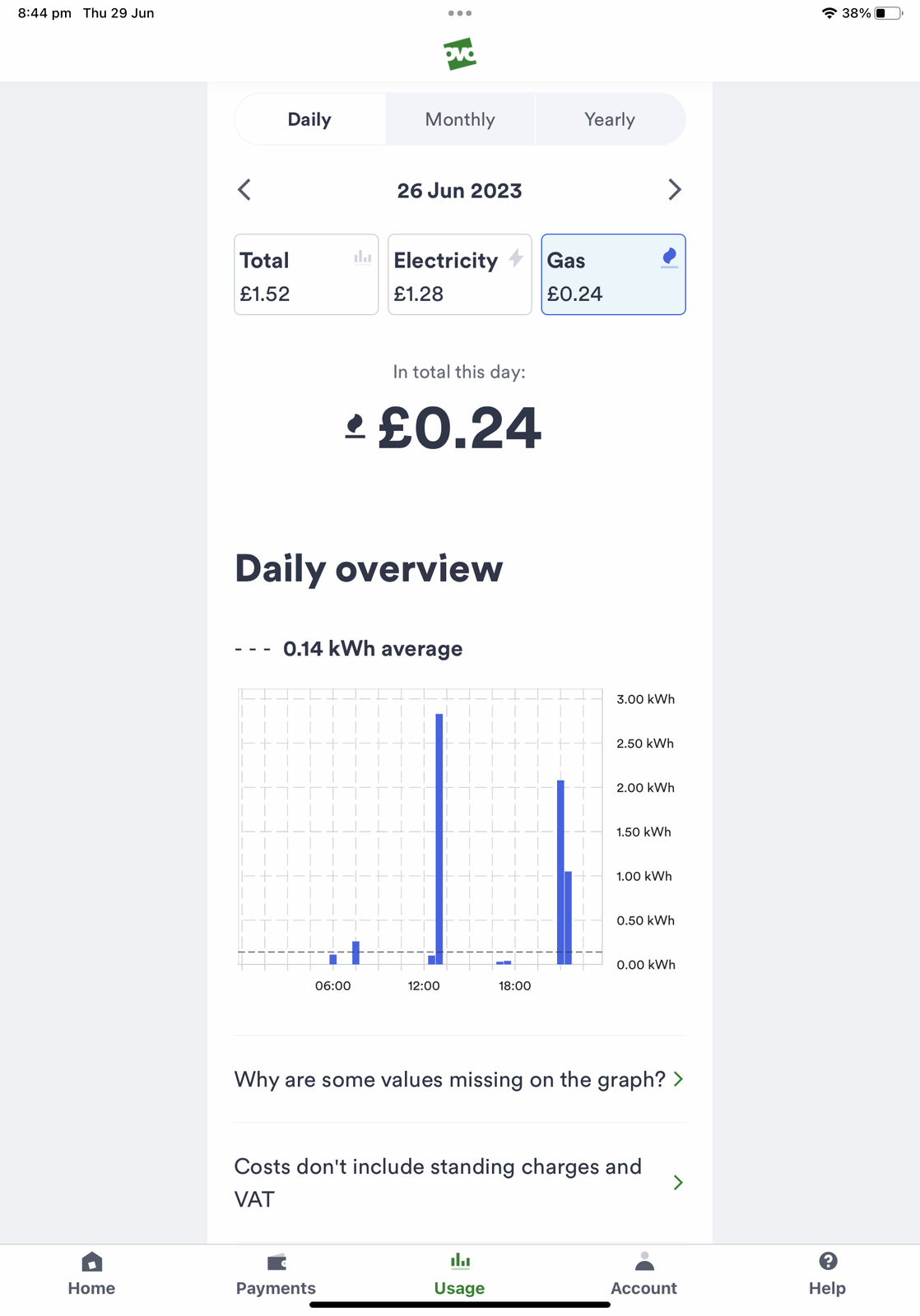

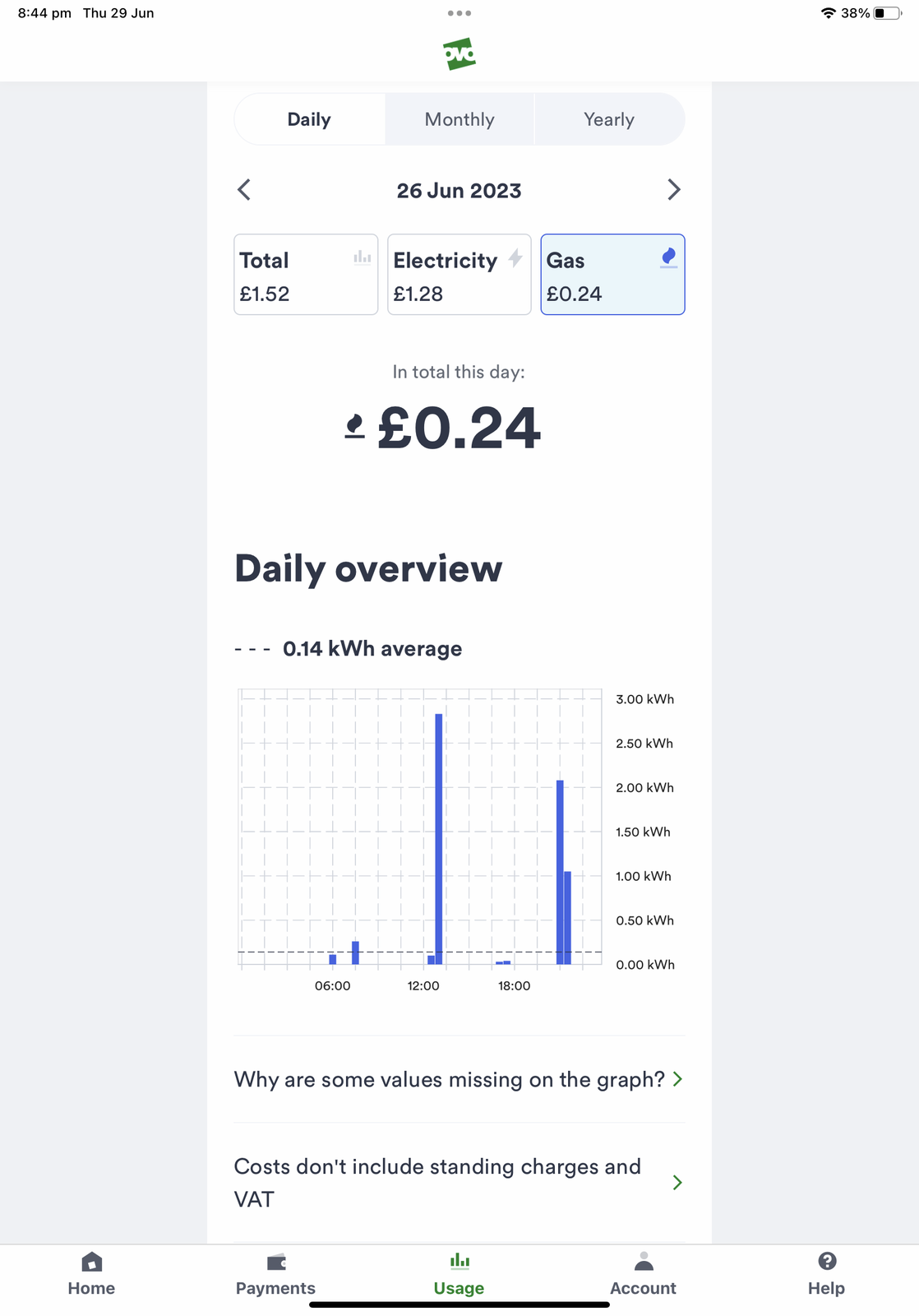

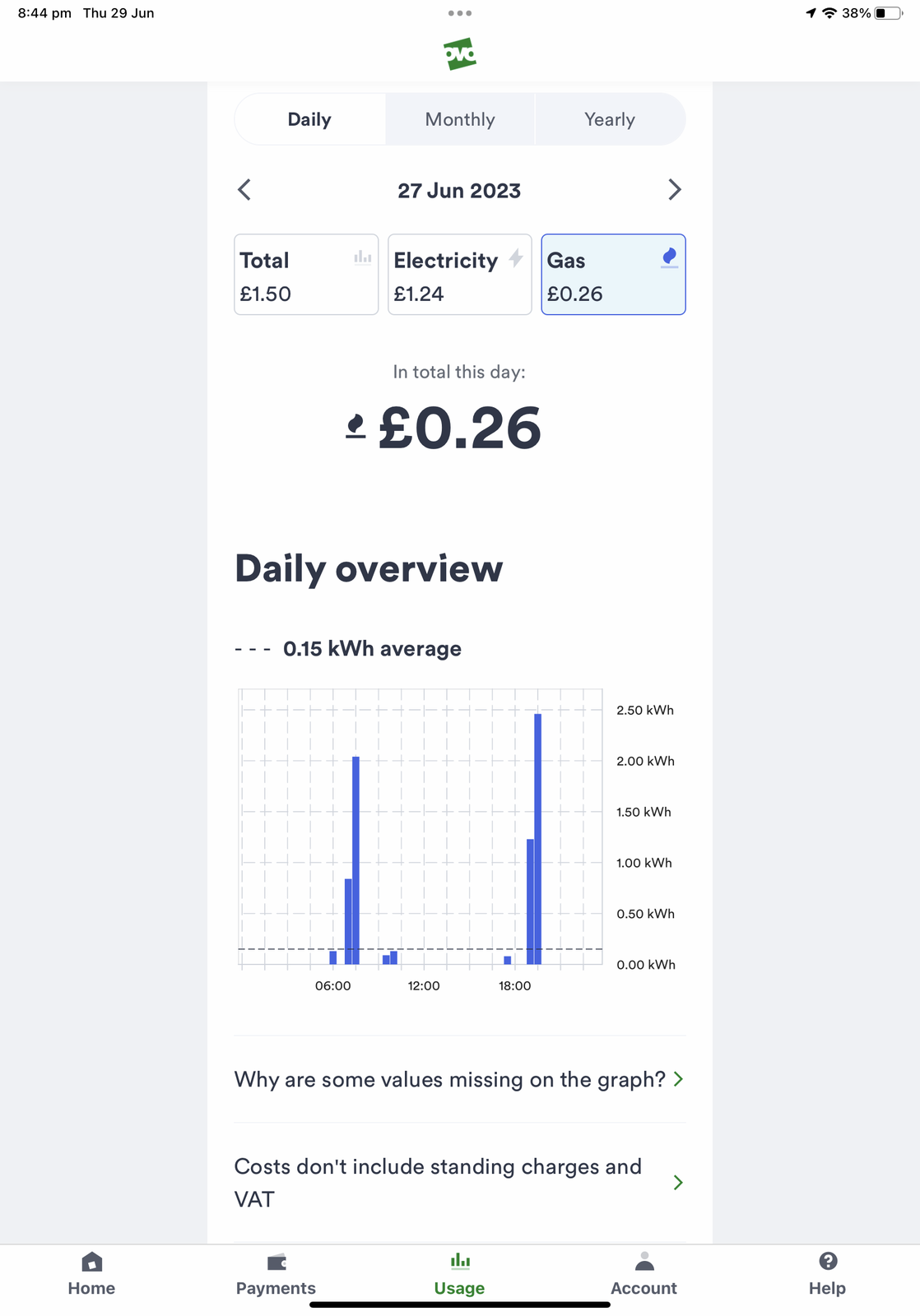

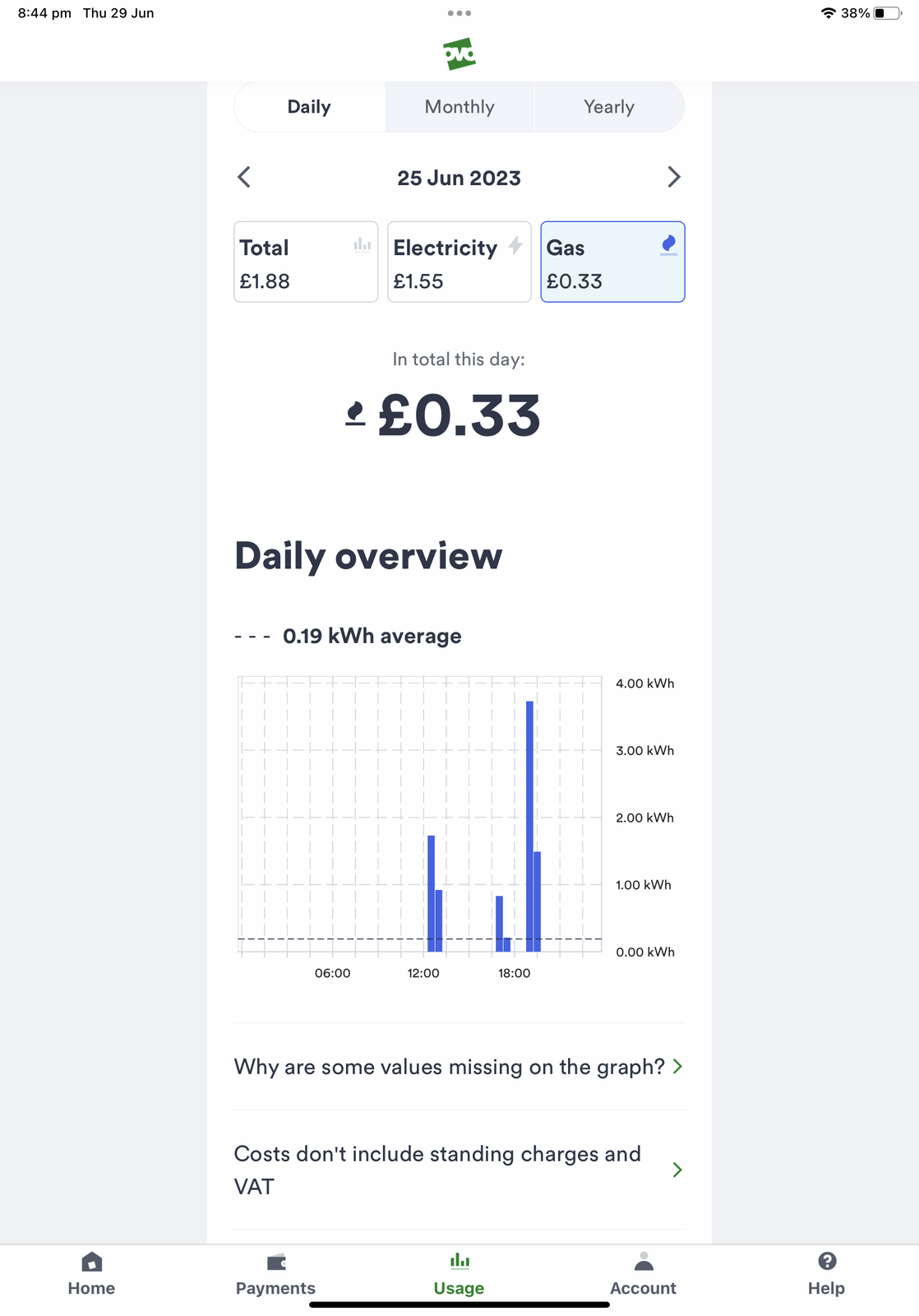

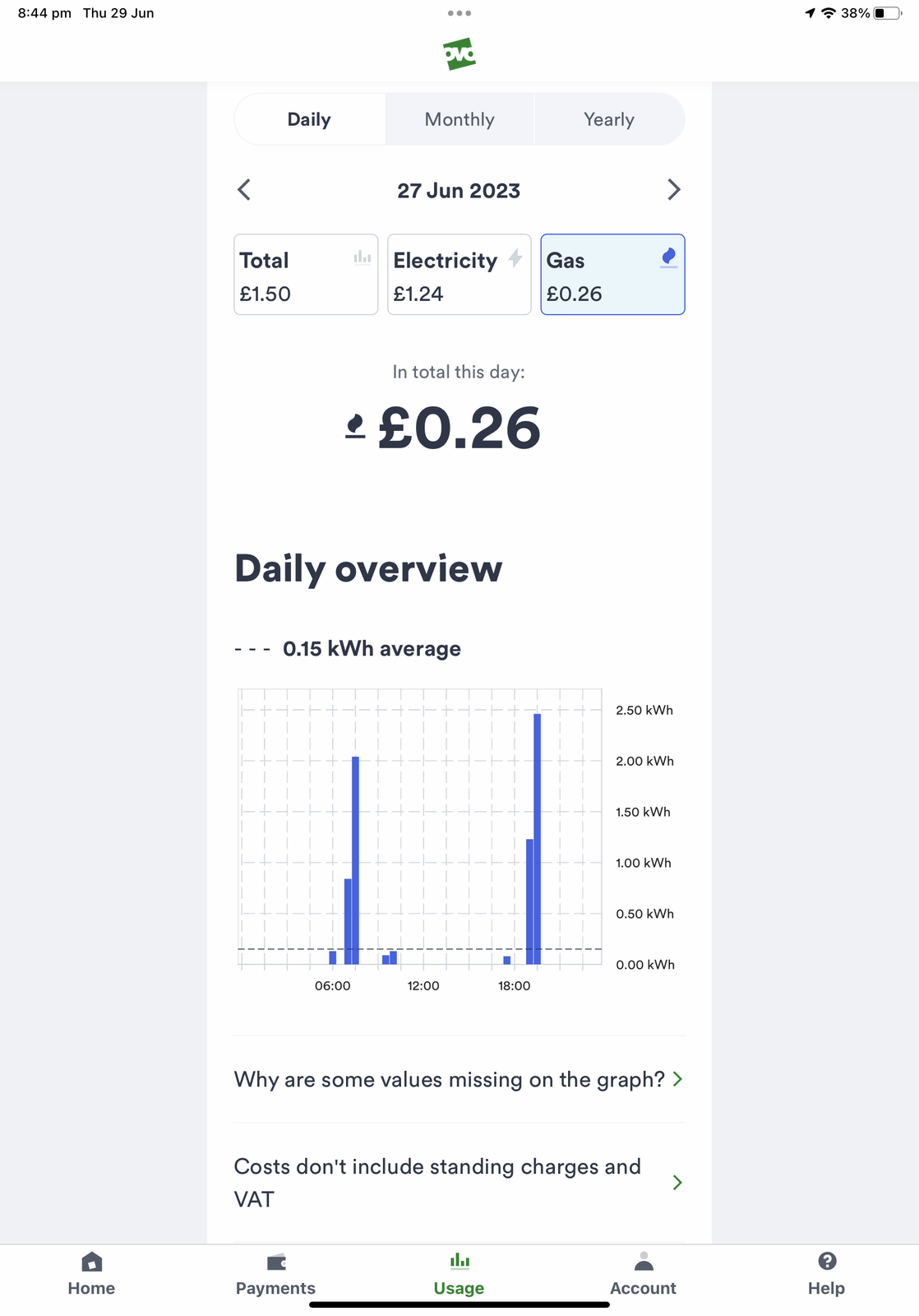

Are you sure it only fires up once or twice per day?
Yep. According to my daily gas usage. See chart.

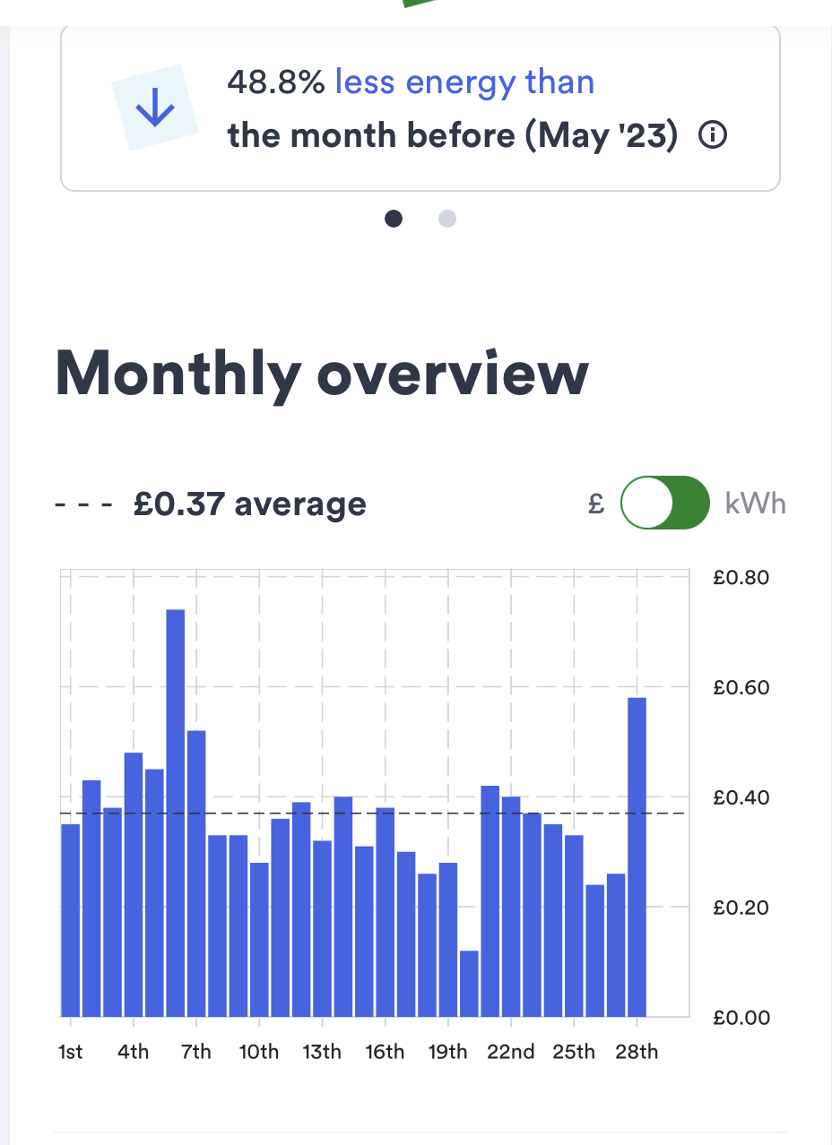

Two of us in the house, gas hob for cooking, numerous hot water hand washing throughout the day, both of us have a shower every night, occasional baths. Hot water is on 24/7. When the heating is not used, we average 37p a day gas usage so personally, I CBA with switching the hot water on and off or even putting it on a timer. I might come home from work or the allotment in the middle of the day and want to jump straight in the shower so it’s nice to know I always have a cylinder full of hot water at any time of the day.
Your gas meter is probably passing unregistered gas.
1 kwh of gas boiler heated HW will give 15L if heated from 10C to 60C resulting in 25L of shower/bath water at 40C so easy to work out how much water is reheated once cost/kwh is known, this assumes a mains temp of 10C, at the now mains temp of 20C these numbers become 19L & 38L per kwh of gas consumption.
The vol of water used before reheat is largely determined by the positioning of the cylinder stat, the higher up on the cylinder, the greater the volume to reheat and the less the frequency but a longer reheat time obviously.
