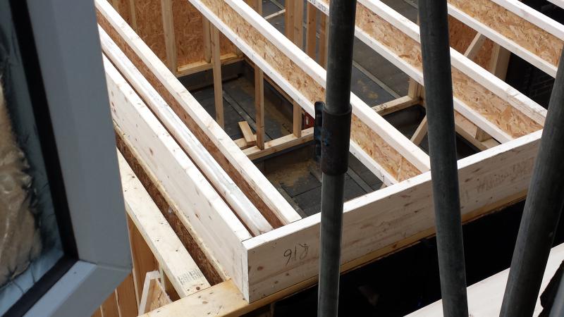

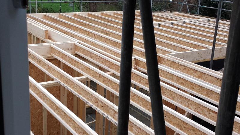

Its amazing how they build flats these days. They are building 3 story flats next door to our house, all wood wood wood (See Pics taken from our bathroom window).
