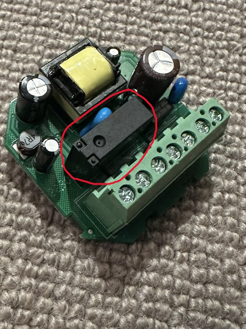

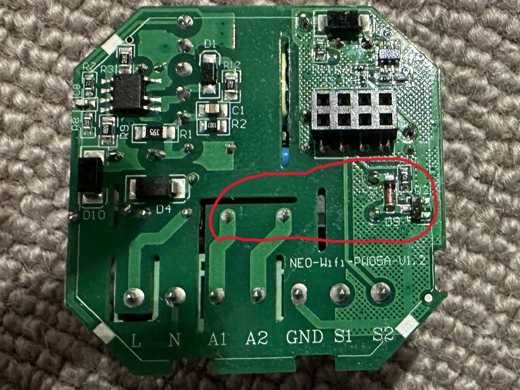

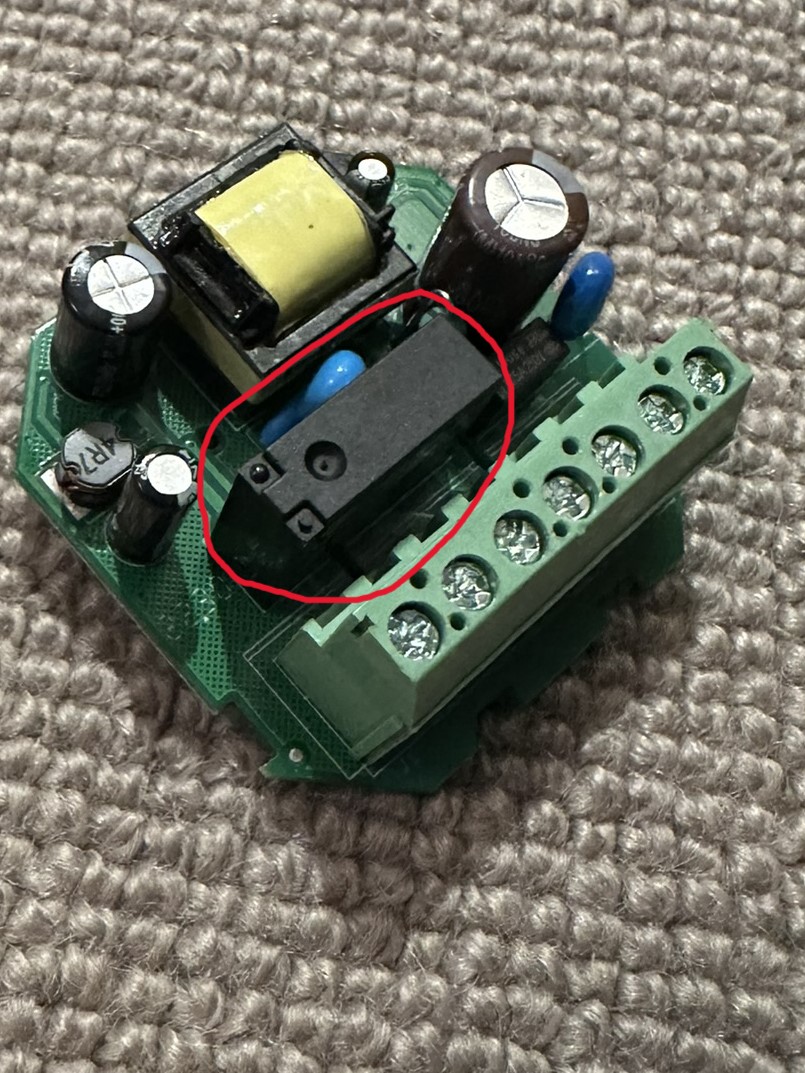

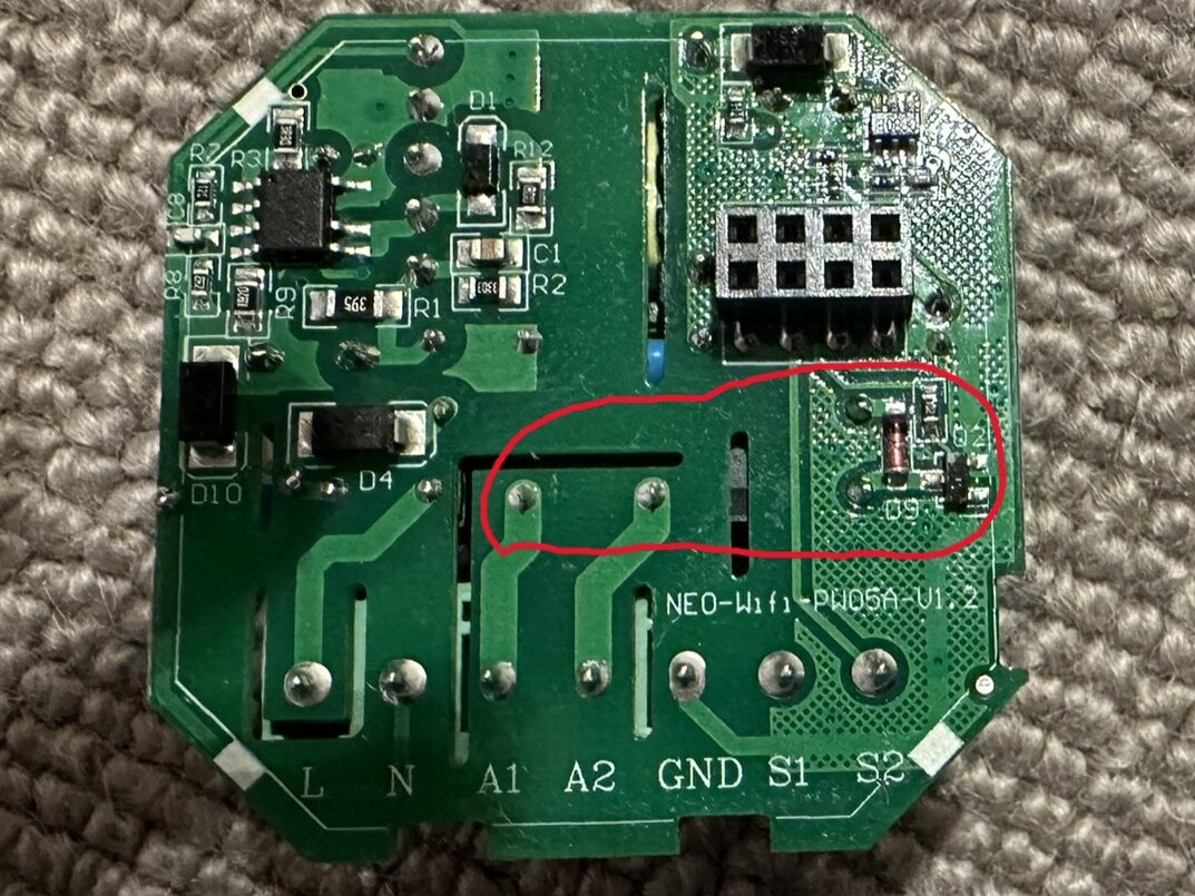

I have disassembled and this seems to be the offending part, an HF46F relay (the slimline uses a HF49F).
There's no visible signs of damage. I could try replacing the relay but I would need to be very accurate with the desolder/solder and I suspect the same thing wouldn't happen again.
I just did the same. The HF46F is rated at 3A ac, when it has a non-resistive load. I suppose the next question would be 'What load is this relay driving?' It would seem pretty certain that it is more than it's supposed to be as two of them have failed. You probably need to establish exactly what the load(s) is/are.

Give the neostat a couple of light taps on the back with a screwdriver handle - it's sometimes enough to loosen a sticky relay - but even if that works, it may only be a temporary fix.
I've just given this a quick try having had a bit more time before I set off with the neoStat upstairs (downstairs is back to Slimline). It now seems to work as intended, whether that was due to the taps or not I do not know.
Very bizarre behaviour. How long it will stay like this is anyone's guess.
It seems that the neoStats are opperating standard 2 port valves, one for each storey? While they are probably designed with a UFH manifold in mind, driving a wax motor actuator or two each, Given that the screwfix link reports back that some kind of self balancing actuator (not entirely sure what one of those is) can cause the relay to stick, then I expect a three port valve probably could, and its probably not a configuration they tested at design stage when they decided to use a very small relay for it.
I think I'd be sticking an enclosure with two DIN rail mount relays next to that wiring centre to switch the valve motors..... you shouldn't have to but short of trying to shoe horn a bigger relay onto the PCB of the neo stat or sending it back as not fit for purpose its a way to try and work around the issues with it
