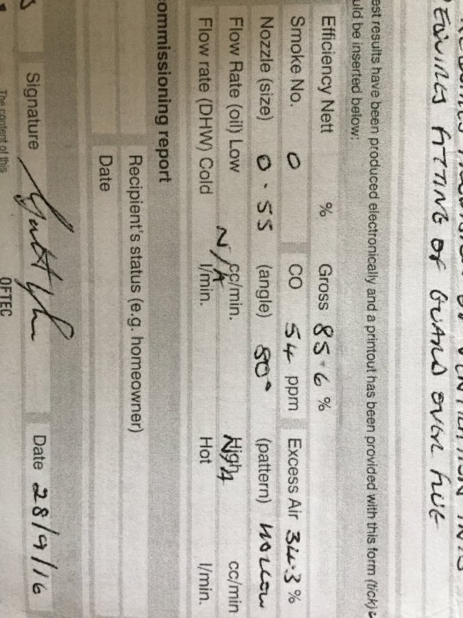

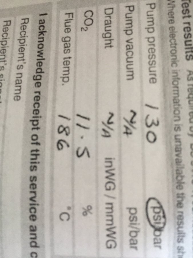

Found the service report from September, not sure if this helps.
Those figures are correct enough, but we still don't know how clean things are in there.....a sooted up photocell does sound the alarm bells!
If your Heatslave has a balanced flue (burner is in a box) run it with the burner cover off to see if it makes any difference.
John :)
IMHO too much oil pressure and too much co2.with a .55nozze I'd have the oil at110psi and co2at
10.5% after cleaning out the boiler properly.I don't think boilers been cleaned properly,and they've took the air down to try to get it as efficient as they could problem is combustion is a very
fickle thing and I see this a lot.Bob
