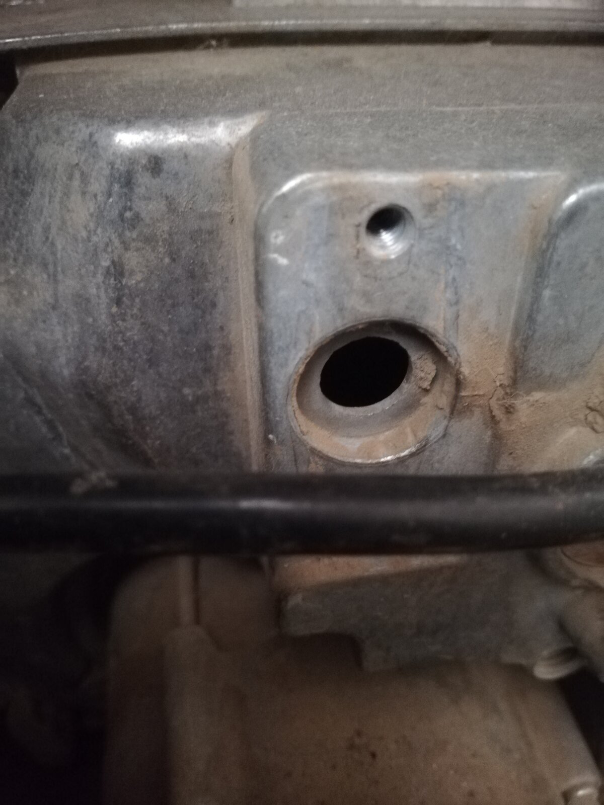

How much light is too much light for the cell prior to start up?
This cell has a hard plastic flange to hold it in place but there's not a seal behind the flange. The hole in the burner is larger than the cell with a recess which under other circumstances I'd expect to see an o ring or similar. So some light will get through to the chamber the cell sits in.

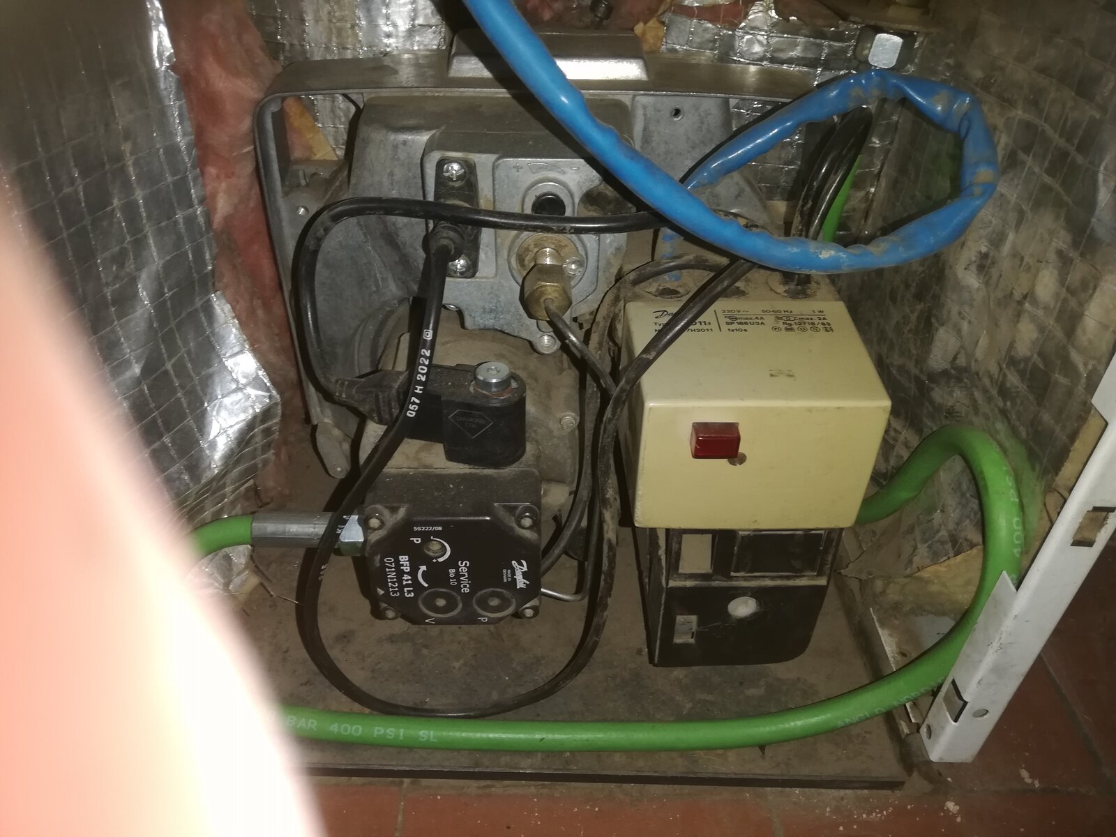

A photo of the burner would be good.
It's on my growing list to do as soon as I get there (y)

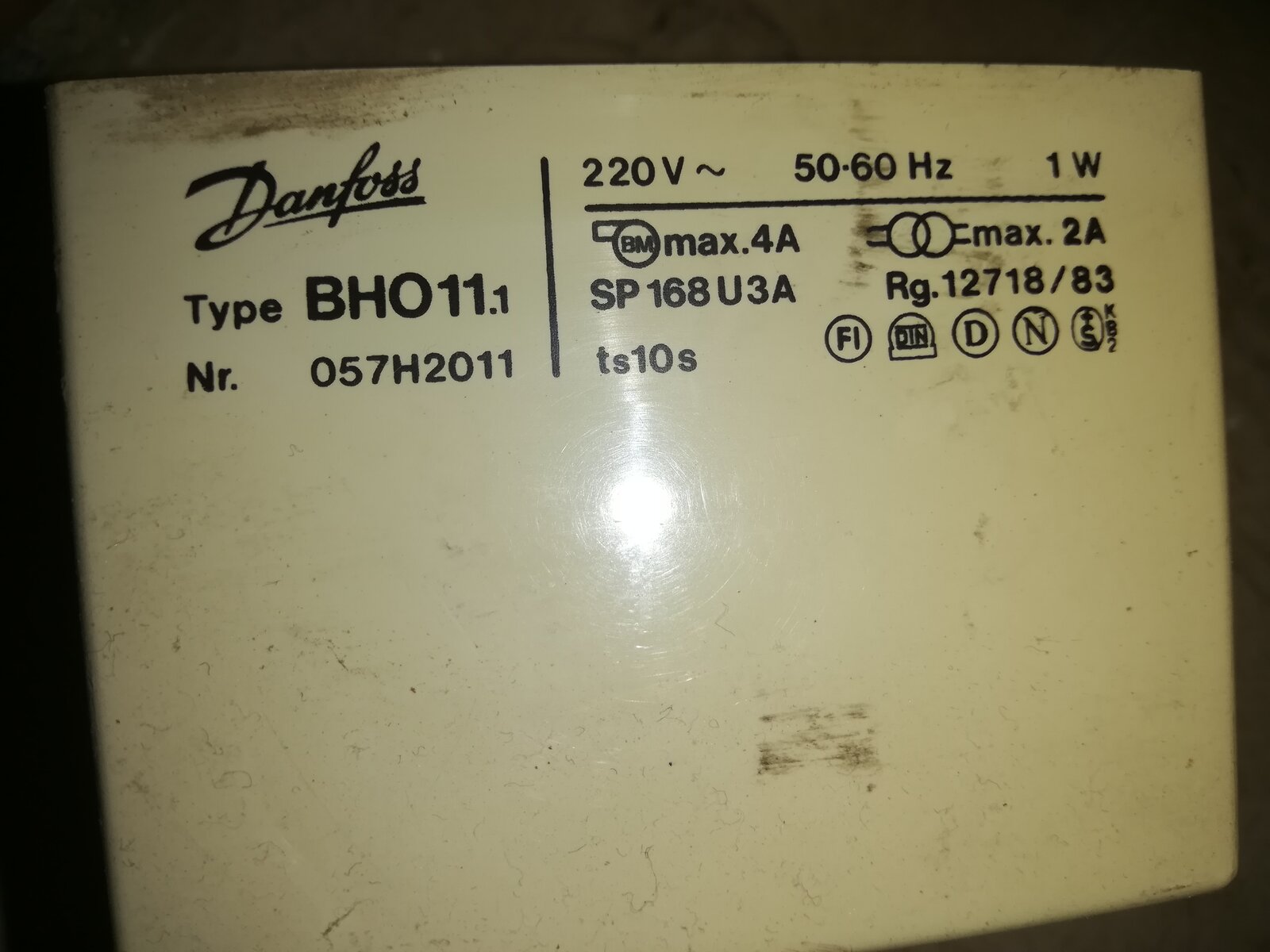

I've also got to find the control box part number as danfoss list a few variations of the modern equivalent with different functions included.

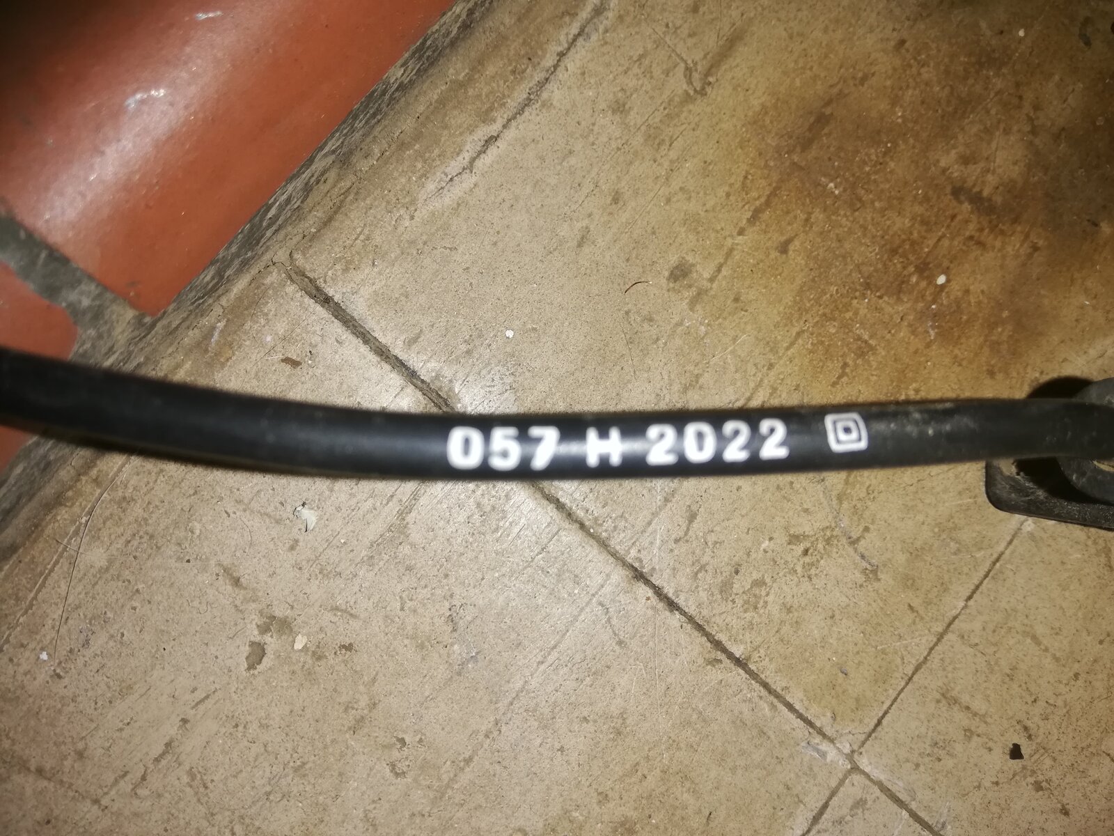

I haven't seen part number on the cell up to now which won't help me.
I will re-do the torch test as it should be done if the resistance readings are in the ball park. If that works well I'll seal the gaps around the cell to try again. Just in case :)
At 18 years old, the 15/19 would have had a B9 or B11burner and both of these would have had Satronic boxes. I think it would also have been too late for the TF801 series box which would have had the FZ cell referred to by Terry. If the photocell is loose in the hole, then if an FZ has been replaced with an MZ, then this can produce the fault the OP has. I recently attended a burner with the TF801 series box and the FZ cell which had failed, and the MZcell was very hit and miss. After changing for a TF830, then no problem. When we get the numbers, we may be better advised.

I spoke to a supplier who then spoke to danfoss this afternoon, expecting you to tell me the cell is dead, and the news is that both CB & cell were superceded a long time ago and there's an update kit available.
