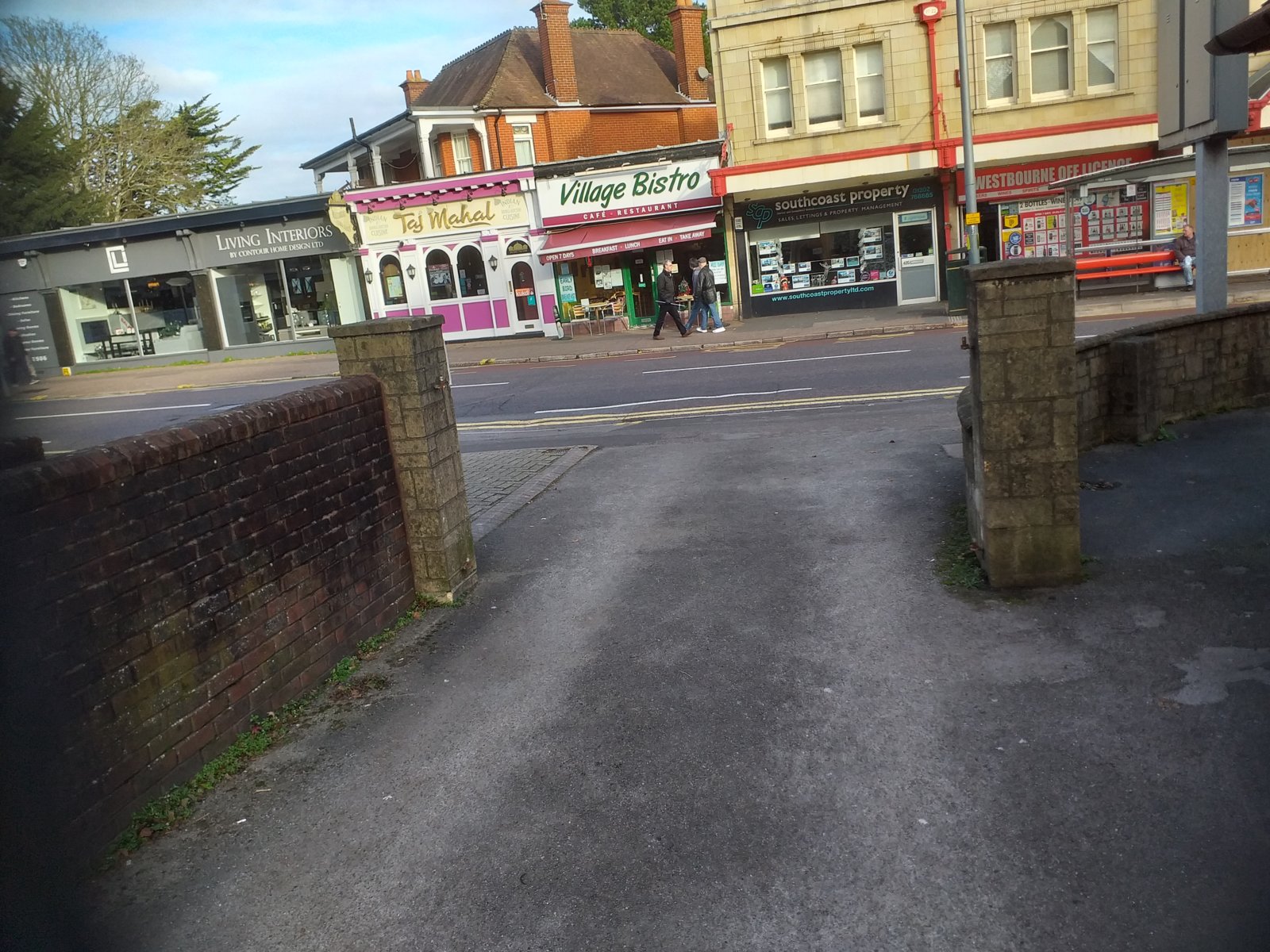

Should I just put some washers to raise this gate up as it's runbbing on the floor at the moment ?

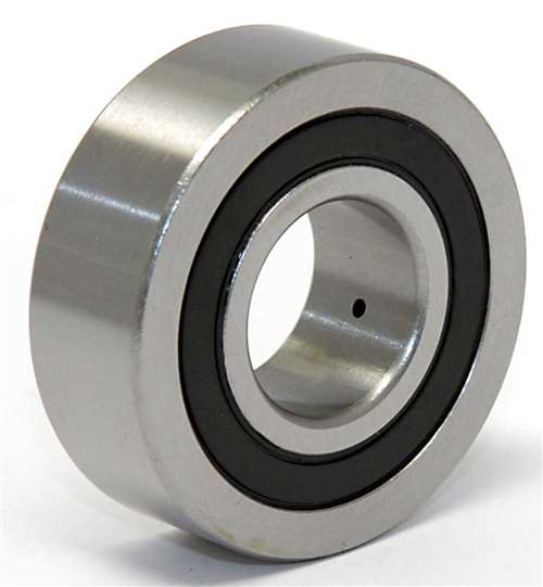

I don’t think washers would work. You’ll probably find that they have dropped because of wear on the hinge pins and/or the corresponding holes on the gate. They may need building up and re-drilling or even modifying to accept a sealed roller bearing. Something like this:

I agree the holes in the gate look worn oval.
I'd consider having them drilled out and a bronze push pressed in, but the washers are a much easier first step.
On the asphalt I can see the rubbing arc from the left-hand gate, locking edge.
Next time you have the drive done you could dig it out a bit to reduce the level
Alright I'll try the washer route. How about fitting new thingies (hinges?) On the wall? They would have to be very strong with the weight of these gates though.
I dont live there. Local church asked me to sort it
The hinges you have are built into the brickwork so a bit of a job to change. Might be a hundred years old. If it was me I might put new ones in, not in the same place. I am not much good at brickwork.

Rather than interfere with the stone pillars, I'd consider moving the eyes on the metal gate.....easy enough to slit them off and weld 'em back on.
Washers first though!
John :)
It might even be possible to use eyebolts, with a nut either side of the gate metal... An eye, with a long thread attached to the side.
This sort of thing - https://wireropeshop.co.uk/wire-sto...=17_80&zenid=0b0a49663de43f1c208373095fe3fe48
Basically you cut the present socket bracket from the gate, then drill a hole where the socket was, and fit an eyebolt with a nut either side of the gate vertical metal work. That way they are adjustable, so any wear can be adjusted out.
What ever method is used, it would be worth making the gates less easy to lift off, to prevent their theft by scrap metal collectors. I have a nut fitted on top of the bracket of the gate post, to which I added some weld. They cannot be lifted off, without grinding the nut off first.
I see four options.
1. Dig/scrape a couple of inches out of the driveway and have it resurfaced at a lower level.
2. Get the crooks out of the piers and rebuild them with the crooks a couple of inches higher.
3. Cut the hinges off the gates and weld them back on a couple of inches lower.
4. Use spacers. i.e. build it up with washers.
I know which one I would do first.
