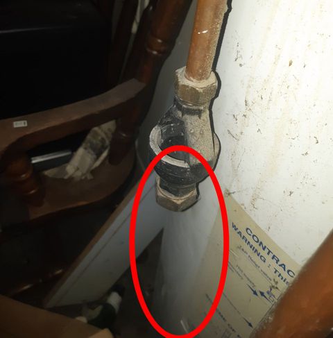

Heeeelp!!! Central Heating works fine but NO hot water and the pressure gauge show high!

Where is the rest of the pipework?
Straight to the waste. FYI.I still not got any let along hot lukewarm water as yet
If you didn't get hot water after two hours ,the immersion heater isn't working. To state the obvious ,there should be a switch for turning the supply on/ off ,where is it and is it on ? Is the dial on the stat set to the max position ? If answer is YES ,you will need electric testing equipment ,like a multimeter ,to establish why its not working.
your 3 port valve, is showing that your controls are set to central heating only, the little black indicator tells you what position the valve is in, there is a manual lever on one end of the valve , slide this across and lock it into the manual position and switch the heating on and you will get a tank of hot water

It's an unvented cylinder (that have more onerous installation requirements due to their potential safety issues) and by the looks of it has been bodged in. I'm not sure it's sensible to give any further advice other than to call out a suitably qualified engineer to the sort the mess out. Defeating the controls in order to obtain hot water due to lack of funds...Hmm
