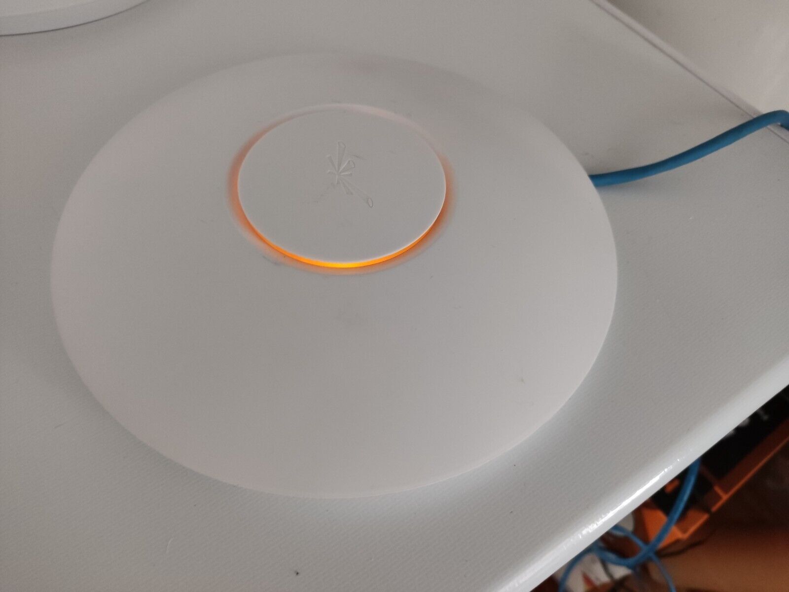

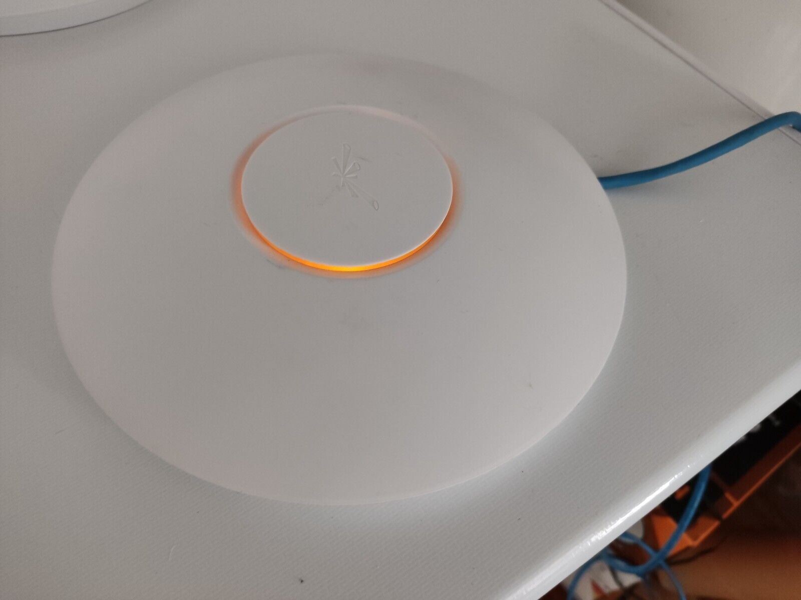

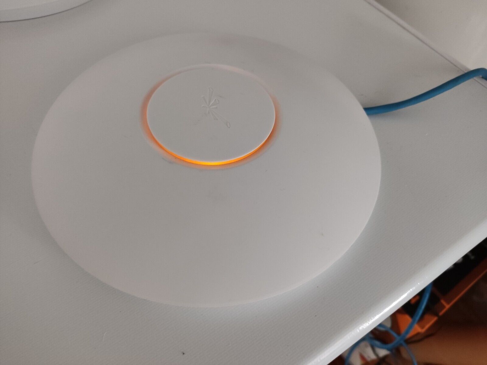

Well, I got one of these things
Plugged it in yesterday. Didn't see any improvement yesterday, upstairs speed check was about 23 MB yesterday.
The tablet ran flat overnight. After restarting I ran speed check and it was 120 which I thought satisfactory.
Tried again just now and it is down to 42.
Adequate but I don't know why it's dropped.
Is that a ubiquiti repeater ?
It needs to be showing blue to be operational
What is the setup? I have no instructions.
