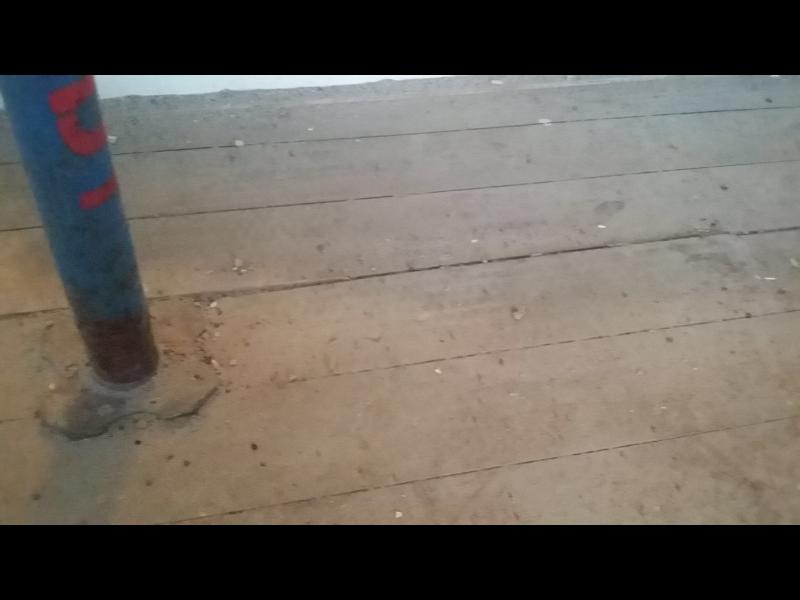

Got a builder in to knock a load bearing wall through 2522mm long. Building warrant approved. Pads on the drawing spec'd as 420mm length. The builder said he always just fits 150mm long padstones. Advice/comments?
Also he has only put 4 acro props up. And I noticed just there that one of the floor board is slightly raised now where one acro is. Is this normal? Shouldn't these be on the joists? Are there Enough props for the length of opening? The beam arrives on Friday so it's on these props til then.
Doubting this builder now.
Don't be too hasty in putting your builder on 'Rogue Traders'.
On that sort of span, 4 acrows should be OK, and if they are on the floorboards (rather than directly over a joist) that won't be an issue for the short time they'll be up.
The padstone has been specified as 420 long?? Frankly that's ridiculous.
On a span of 2500 or so, the load won't be very high and if the walling is in reasonable condition, the shorter pad you've got will be fine.

He has been a bit of one with the acros. In theory you should go down to solid ground when suppoting a lot of weight. However he should at least of put a scaffold board under them all to spread the weight. If one of the floorboards is bending it shows the problem.
