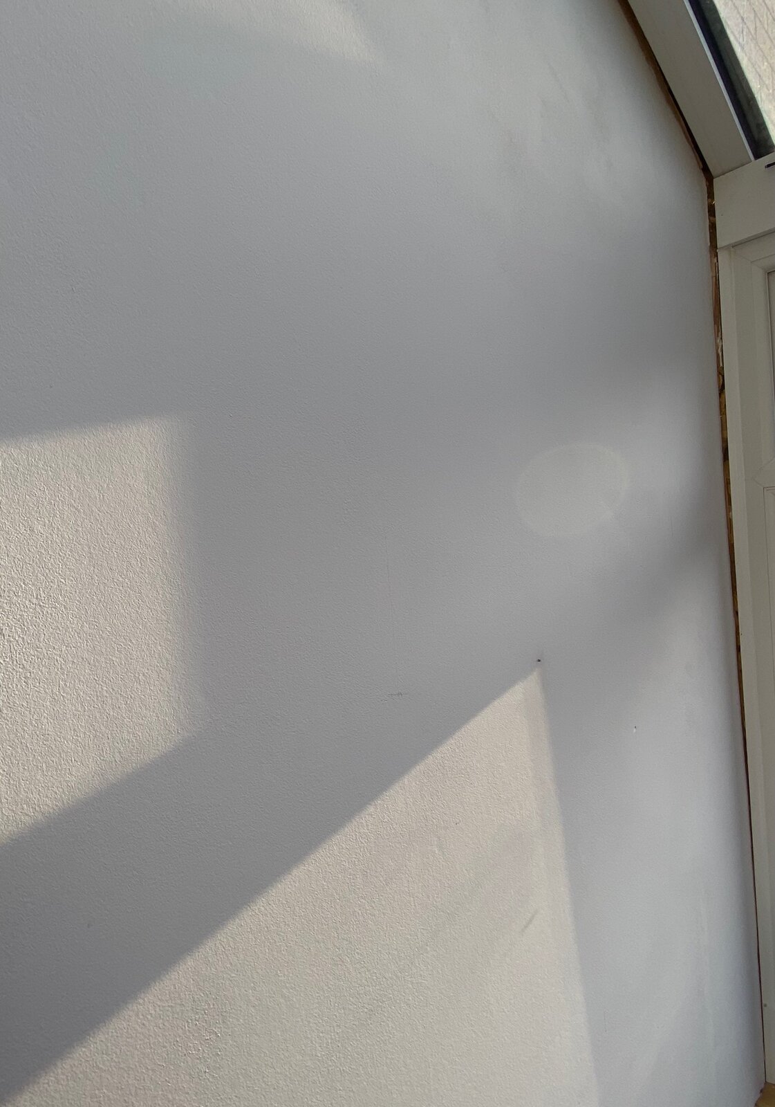

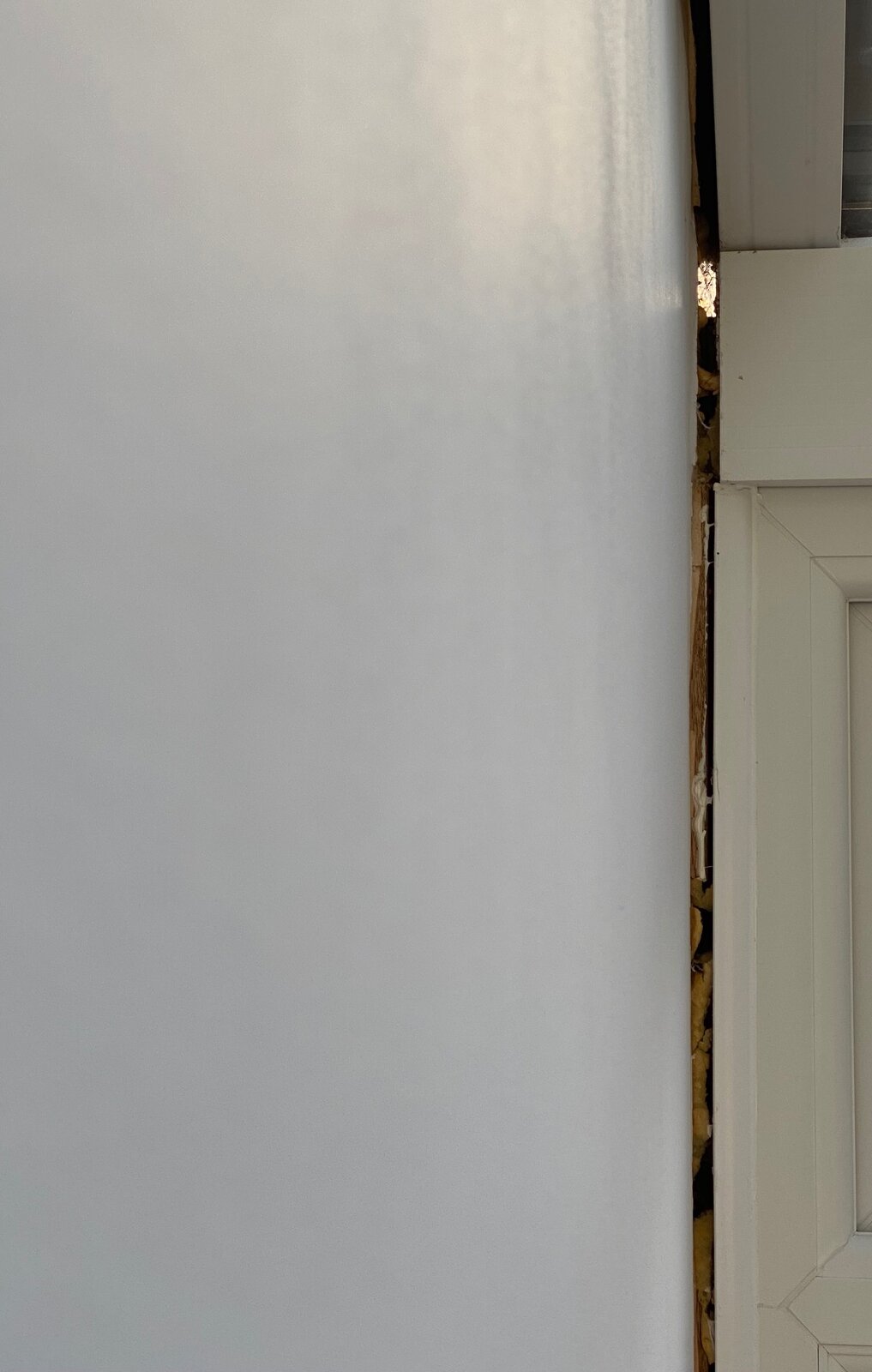

Hi - I have exactly the same issue, it appears. Sorry to resurrect old thread but so many similarities, including the imminent house move.
I have the gap from bottom to top, it's about 1.5cm at the top . Same coming from the roofline down to the corner - no gap at the ridge, up to 1.5cm. Externally brickwork looks fine - not a crack anywhere to be seen. I'm comfortable enough adding silicone and moving the quadrant bead to cover - they're 2cm wide so should be sufficient, question would be what you suggest using at the top where the rectangular plastic board bit (internal soffit board?) is? Just fill gap there with mastic - or procure some additional beading to put here, which might look a bit odd?
Likewise what would you suggest at the top along the join between roof & house?
At the corner you can see daylight from a certain angle, I'd propose putting some colourless waterproof sealant here on the outside?

smiler1357, good evening.
Good old post that??
Looks as if your roof, more especially the ridge, has moved away from the wall of the house?
If you look at the gap at the ridge, compares with the gap at the eaves, there appears [from the images posted] the eaves are still close to the wall but there is an increasing gap as you get nearer the ridge.
Can I ask? what is the state of the mastic [and any gaps] externally and internally down both sides of the structure?
If the problem is confined to the roof and the sides are stable, simply move the existing beading, or remove the existing beading and glue on a new cover bead / plate.

Hi there - it's the opposite actually. The joint you see in the pictures is at the eaves, there is no gap at the ridge, growing to 1.5cm at the eaves.
There is no mastic visible internally. Externally, on one side it's totally normal sealing, along the edge of the external cover plate. On the side with the gap the sealant is ever so slightly out from the edge of the cover plate, but there's no visible gap except that hole at the top in the pictures - no mastic there, I believe it's where there is a join in the lead flashing.
