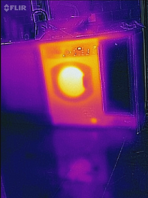

I have a thermal camera, much fun to be had with one. But it would give you a clearer picture of which parts are colder than the rest
