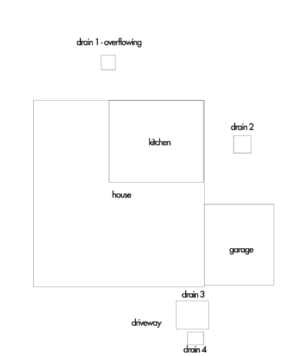

The drain (drain 1) outside the kitchen is overflowing, I've taken a photo to show you what I mean, this is just after washing the dishes -
The layout of the house/drains is like this -

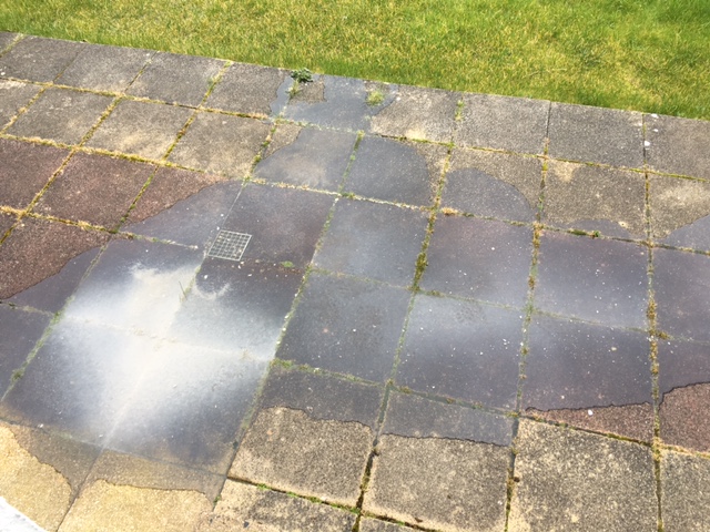

I bought this piece of drain snake kit and tried to plunge drain 1 and 2 with no affect. Drain 1 it goes straight down, just fitting the kit inside perfectly and drain 2 it wouldn't fit down with the plunging end.
Only drain 1 has an issue all other drains seem to be fine.
I'm tempted to open drain 3 on the driveway which is one of those big square drains found on streets but would need to buy the right keys and lift it aside to see.

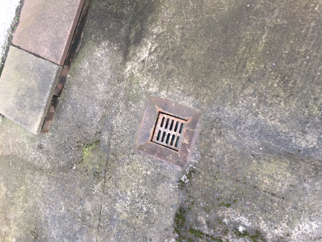

drain 2 -

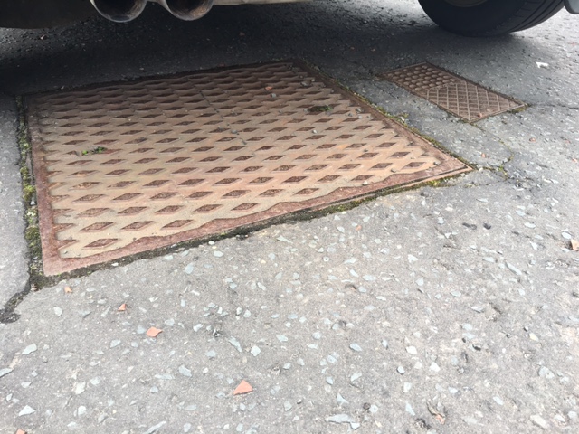

drain 3 -
drain 4 may not be a drain at all, it's the one next to drain 3 as shown in photo above.
Please could anyone advise anything further I can try before I call the professionals in?

Drain grilles in paving will probably lift out with an old screwdriver, and there will be a trap like a sink trap underneath, use a long spoon to lift out any mud and grit.
It will probably be constructed like one of these
http://www.screwfix.com/search?search=gulley
but if old will be made of brown glazed pottery (clay) with an iron grille.

Use a garden spade to prise up the edge of the square manhole cover, (drain 3), then slip a screwdriver or something underneath to support it, whilst you then get (gloved!) fingers under it and it'll lift. See if that's free flowing for starters. I doubt boiling water or chemicals will have much effect as they will be too dilute by the time they reach the problem.
