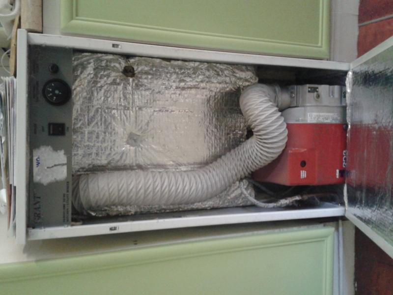

Hello,
I temporarily removed a radiator upstairs to plaster at the back of it. I then refitted the radiator. I did not add any more water into my system to replace the water I removed (I don't know how to do this). I turned the central heating on and all works, BUT, now i get an odd bubbling sound from the pipes/pump (I'm not sure) near the boiler (I did not have this noise before). The noise does not seem to start immediately when I turn the heating on, but after the boiler stops (when its reached the temperature I set on my thermostat) and continues for around 10-15 minutes.
Ay ideas? I'm worried it might blow up or something! It a grant Euroflame 70/90 kitchen/utility oil (kerosine) boiler. Am I meant to add more water into the system? I cannot see a pressure gauge anywhere? Am I meant to bleed/balance - if so, can you tell me what to do?
Help please.
Thanks!

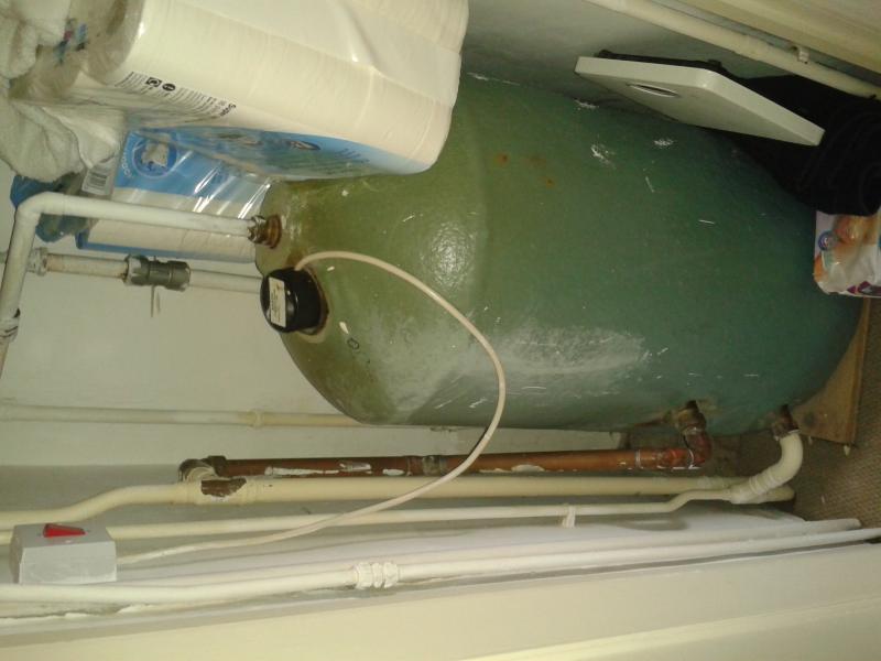

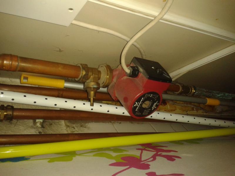

Hiya. Sorry for th delay. Here are 3 photos (took me a while to figure this out). The photos show the boiler, the red 'pump' thing near the boiler and the pipes where the noise comes from, and my hot water cylinder.

Looking at the photo of your hot water cylinder, it's an open vented system you have & the Feed/Expansion tank is in the attic above the cylinder cupboard. Check your tank & ensure it's full & the ballvalve is not jammed.
HTH
