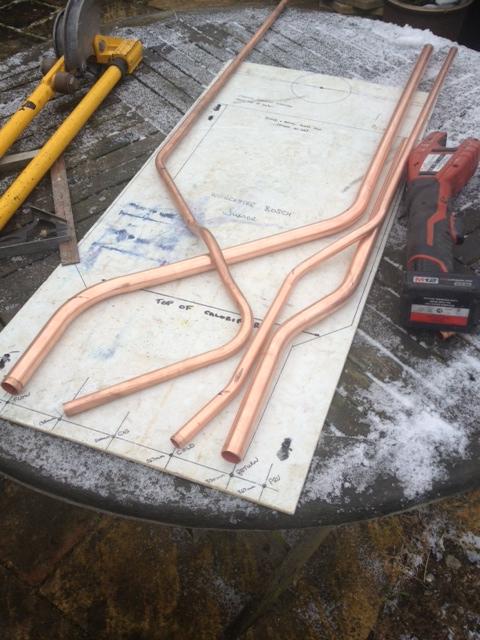

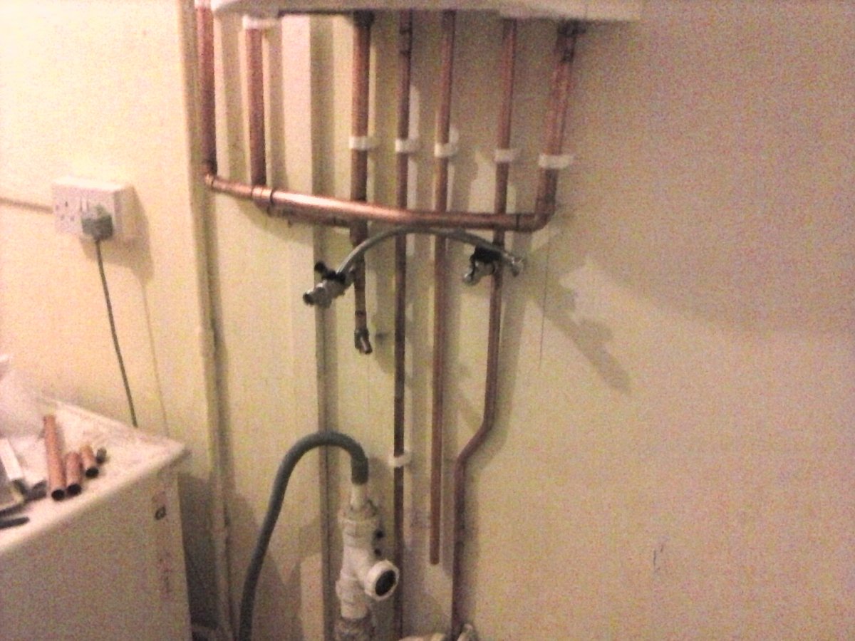

Feck knows why they didn't run the flow and return up through the jig. Would've been dead easy to box in then.
You can get lots of pipes behind if you can bend
Razor, what makes you think the plastic cowboys will know how to use that alien yellow tool in your picture
Might get the 4amp battery for my pipe cutter
Get the installer back and tell him to tidy it all up. You get the impression he threw the boiler in and just didn't care.
I was wondering if it was the first boiler he had ever fitted!

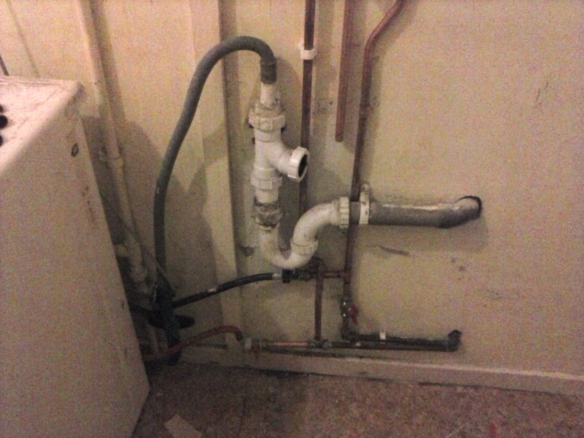

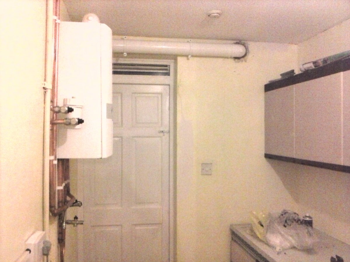

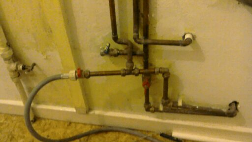

When I replaced WAH at a rented house and replaced by wet CH and new rads, the Heating Engineer's aftermath is self explaining, need I say I was not highly impressed!
This is how the pipes were laid crossing over one another and all over without any systematic approach. Ref to picture above.

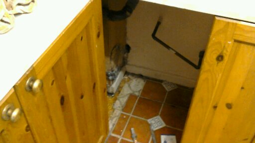

This little cavity is used by tenants for placing kitchen bin, the side panel has been removed, but this is where they tapped into gas connection that was already in the wall previously used for gas oven and cooker, but note how far the gas pipe has been laid which would clash with bin, and possibly get damaged by careless tenants.
the Heating engineer team of 3 did the whole installation and a new boiler in 1.5 days and I parted with £3,500.00 for this mess, For the price I cannot complain. But if I was registered to do the job, I would have done a lot better than this for the same price.

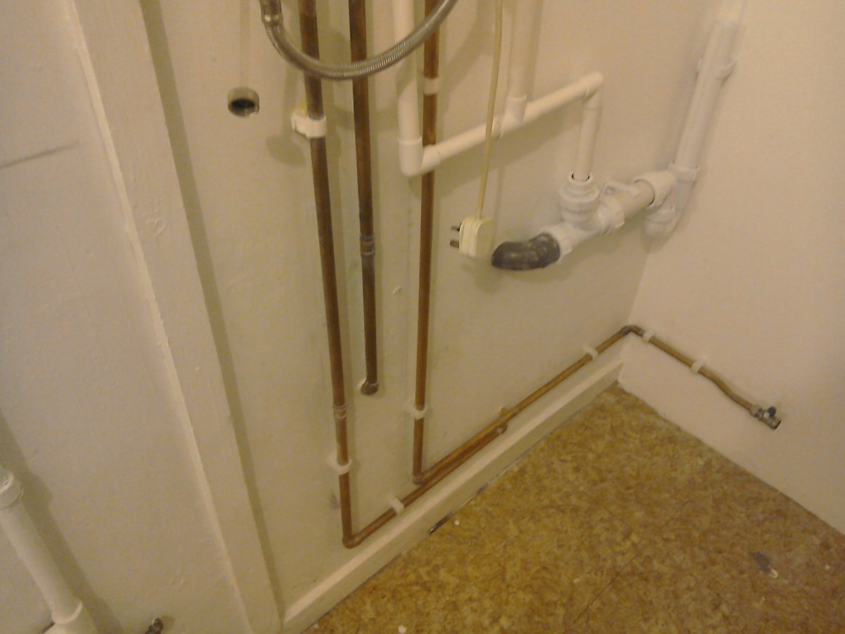

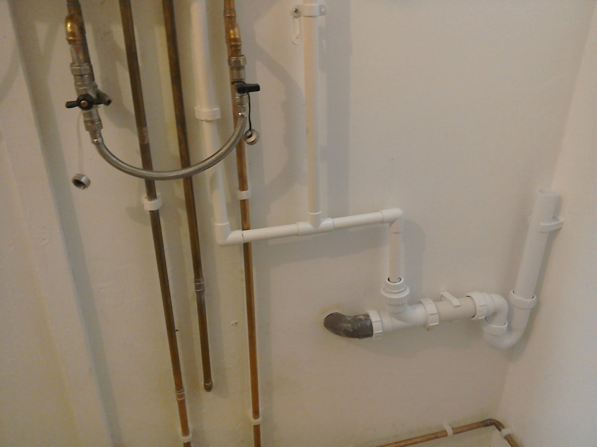

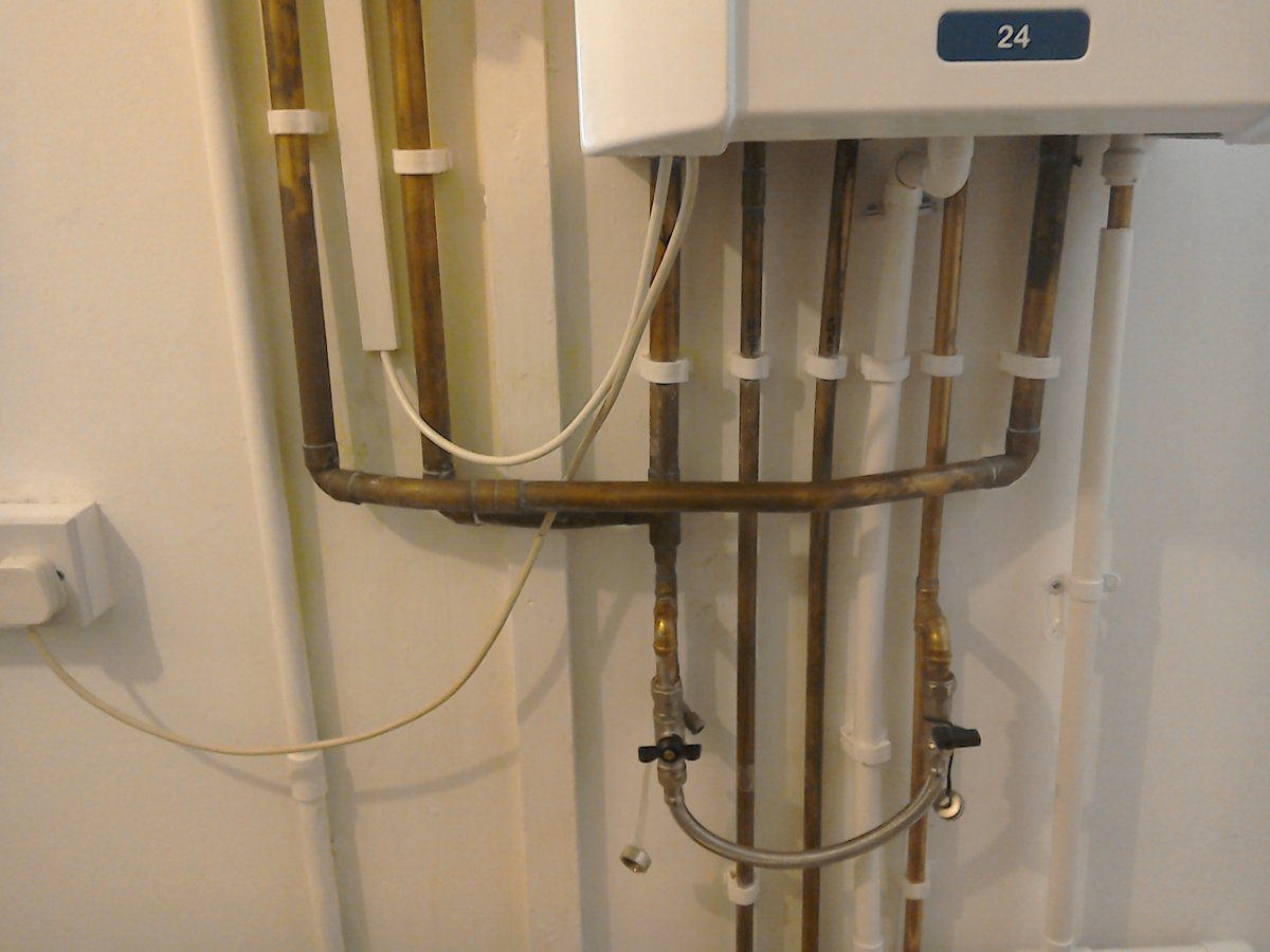

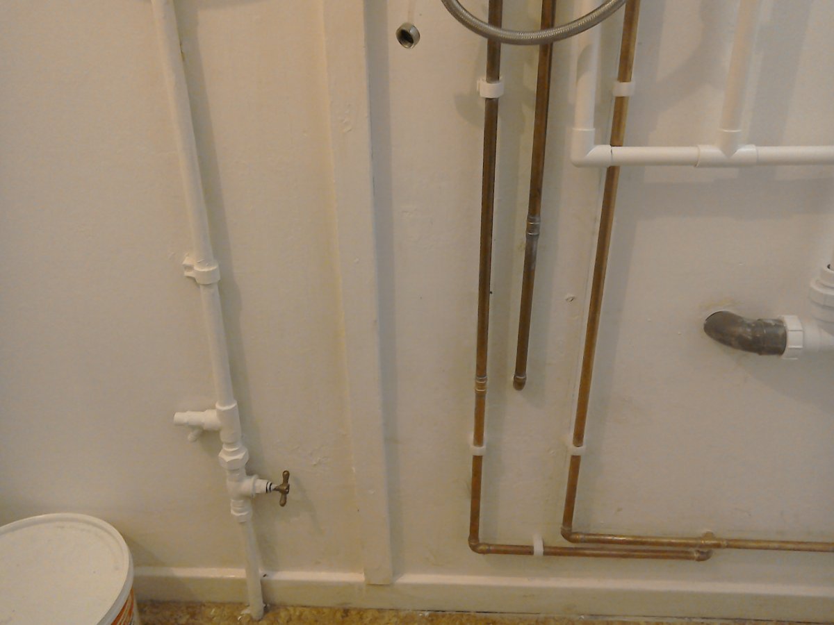

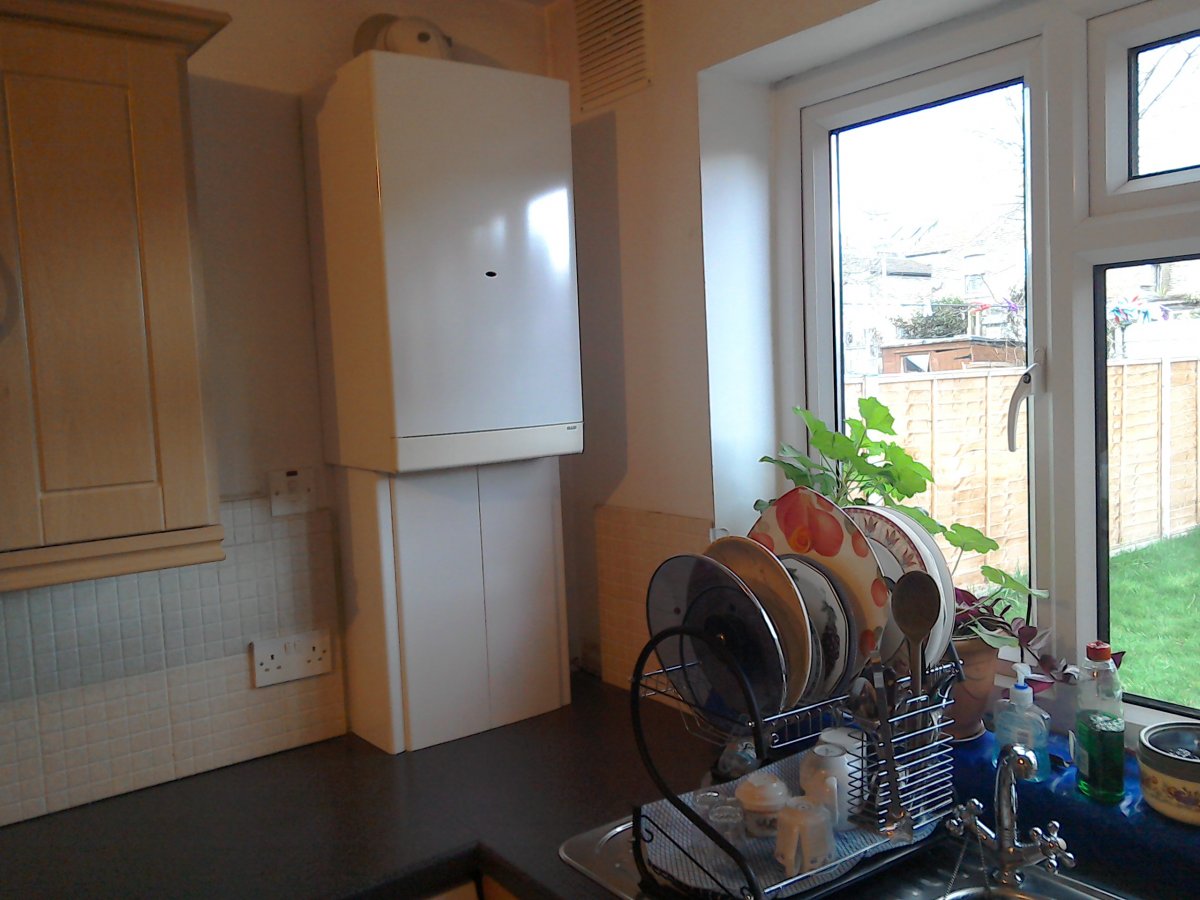

Now Showing tidied up plumbing.

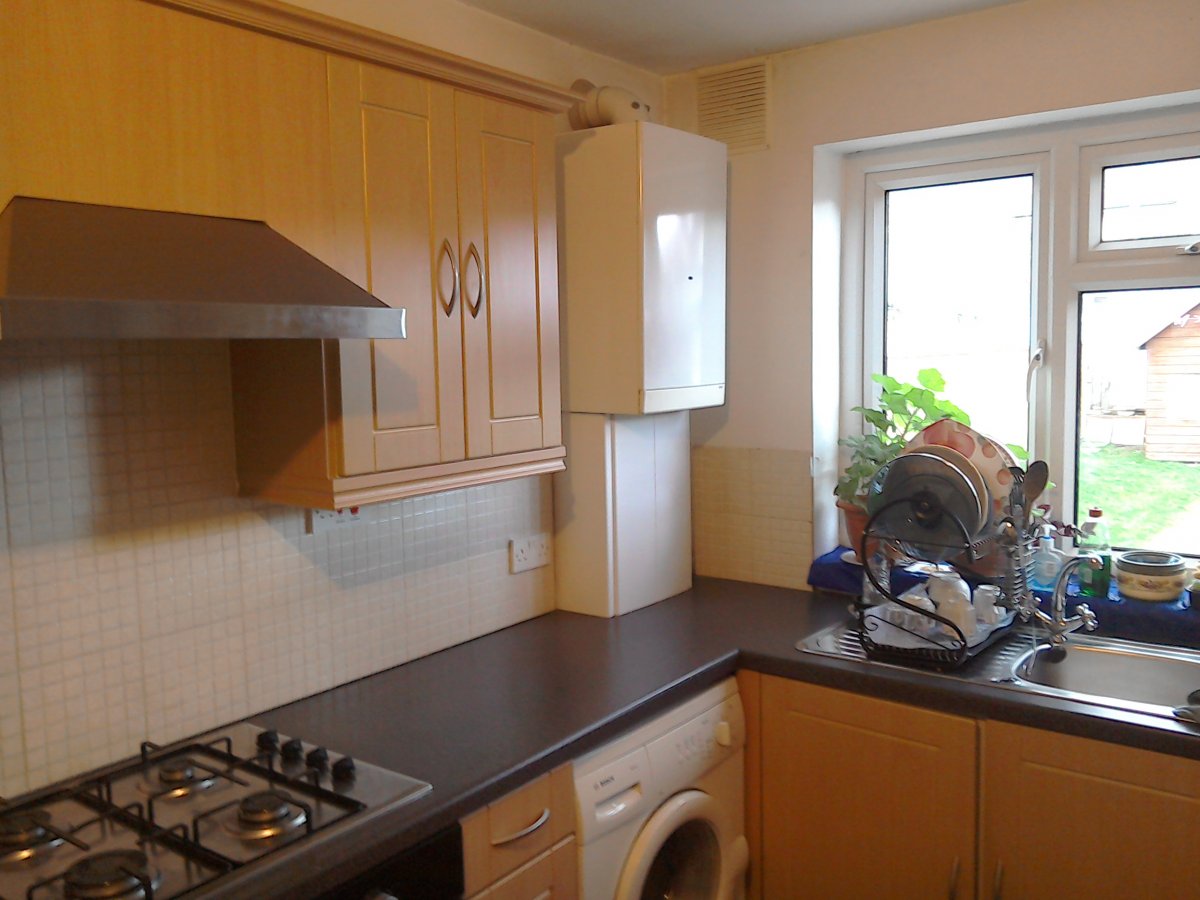

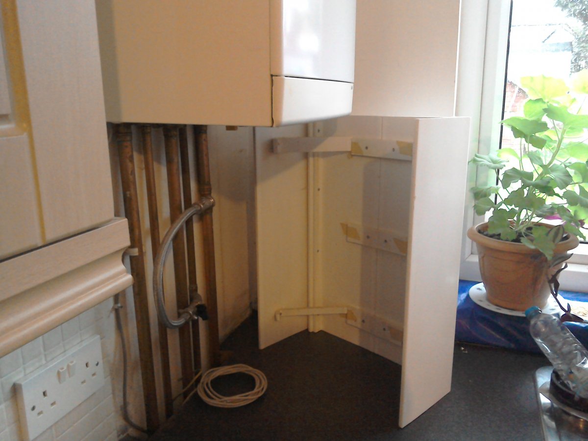

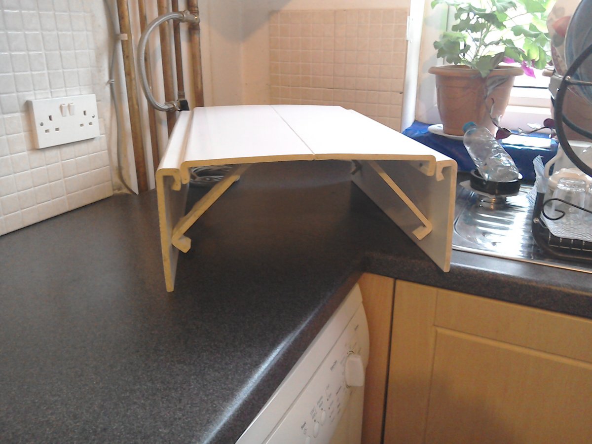

You can use UPVC Window sills to make pipe covers as I did at another property, this material is very versatile, it is widely used in building sector both internally and externally, so i cannot see any issues, most double glazing is now carried out in UPVC,
here I used sections screwed and glued together to form a self supporting cover that can be slid out when boiler needs servicing without having him to spend time to unscrew. and it looks much neater than wooden boxes that need sealants on edges, this does not.

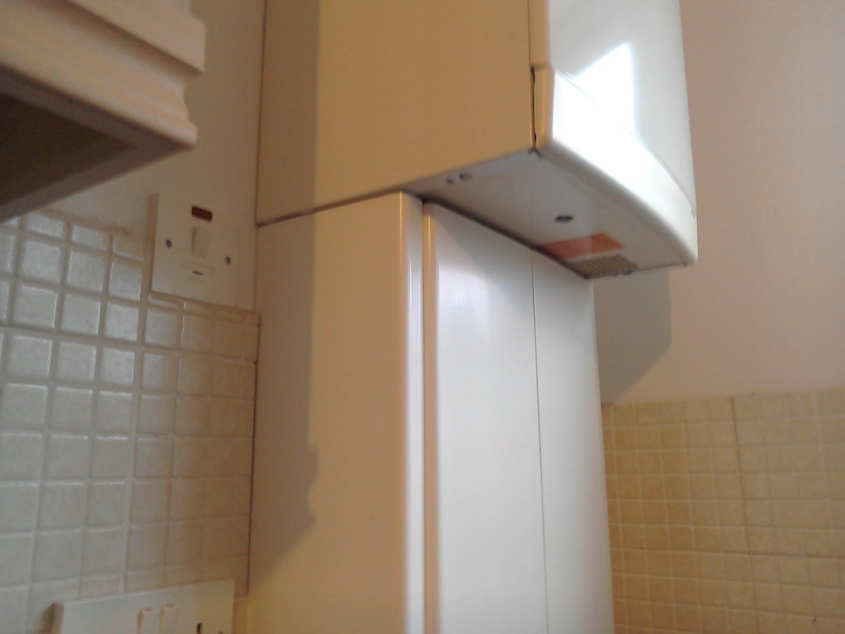

Box in position under the boiler, just resting by itself, no screws needed.
Box slid out, exposing all pipes and underside of boiler.
Showing how simple it is to use small wood screws and a bit of PVC glue to make a rigid body and using side brackets for strength. all from this window sill material or flat boards.
Side view
Being pushed back under.
