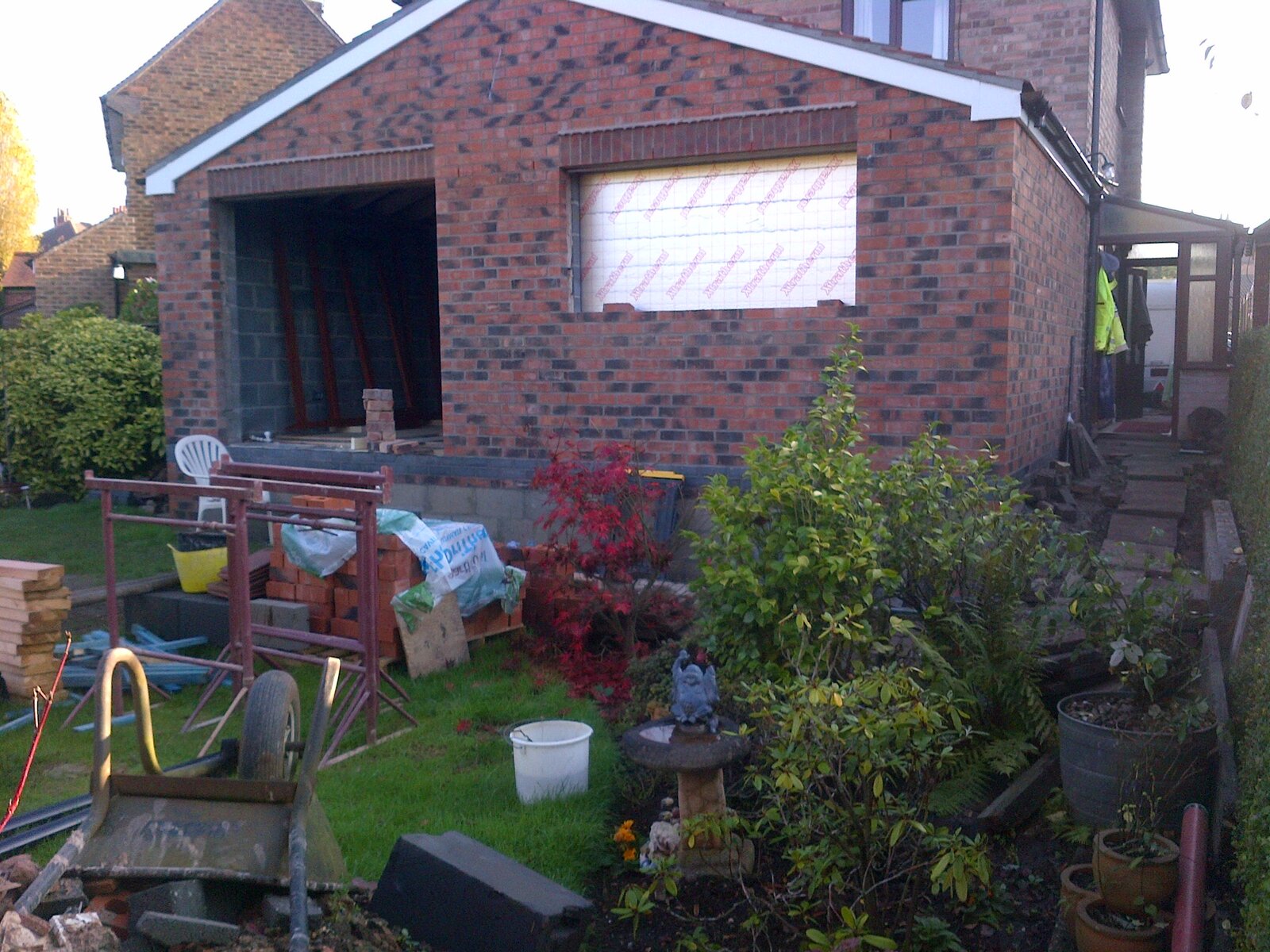

Thats sorted then overhang will stop staining of the wall and since the facia is part and parcel of the overhang threr will not be an issue. Sorry Tagged you will just have to make your own judgement call based on who has helped you the most so far and live with the consequences. Good luck, and as Fletcher would say" dont let the barstewards grind you down" :)( not a clown!!!)
Just to get this right from my end, your saying the fasica is considered part of the overhang and although not ideal will do fine in terms of supplementing for lack of overhang? Hope I've got you right.

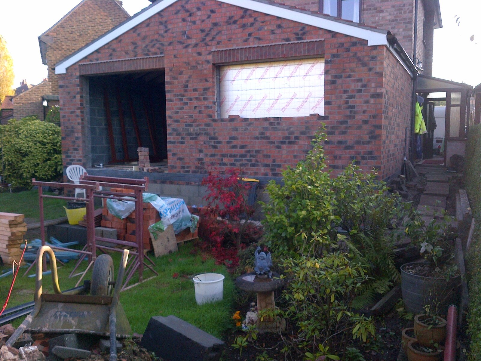

Thats my take on it (as was my builders) as per picture, although others views may differ
Thats my take on it (as was my builders) as per picture, although others views may differView attachment 242948
In the nicest way possible it's nice to see someone else with the same finish on their building lol it doesn't seem to give you any problems? I feel a little better about mine now haha.
