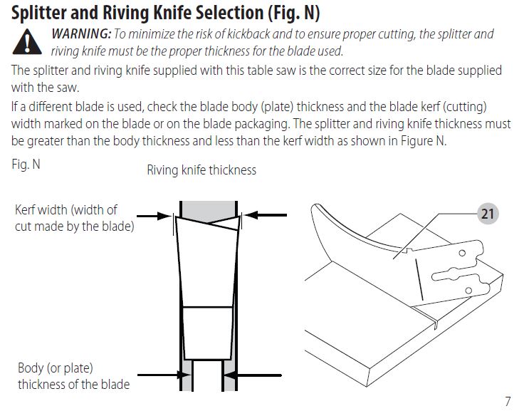

look at the kerf thickness and riving knife on the saw
I am not sure of the riving knife that the dewalt has as I do not have it yet - waiting for a good black friday offer, or it may even have two sizes of riving blade with it.
So am I correct in thinking that the saw blade kerf should be less than the riving blade thickness
Off to ikea now -- with my tape measure - wish me luck and I will see you all later (y)
as far as i'm aware and google search
The riving knife must be thicker than the plate of the saw but less than the kerf (thickness of cut).

Dewalt saw ordered on a black Friday deal and I have just received a set of 2 blades from saxton, a 40 and a 60 tooth. The kerf is stated on the saxton website at 2.4mm but not the blade thickness so I measured it to be1.7 or 1.8 or 1.9 (had trouble as the battery is about dead in my gauge.) is under 2 though.
I also got this from the PDF of the dewalt instructions.
English
8
OPERATION
WARNING: To reduce the risk of serious personal injury, turn unit off and disconnect it from power source before making any adjustments or removing/installing attachments or accessories. An accidental start-up can cause injury.
The riving knife provided with this saw is marked as follows:
.087” (2.2 mm) THICK RIVING KNIFE. ONLY FOR USE WITH 8-1/4” (210 mm) BLADE WITH .094” (2.4 mm) MIN KERF WIDTH AND .079” (2.0 mm) MAX BODY THICKNESS.
Blade body thickness and kerf width dimensions for all DeWALT table saw blades are available at www.dewalt.com
If a different blade is used and the body thickness and kerf width dimensions are not provided, use the following procedure to determine the correct riving knife thickness:
1.
Measure the body thickness of the blade.
2.
Make a shallow cut in scrap material and measure the kerf width.
3.
Select the riving knife 21 .
4.
Slide the riving knife through the shallow cut made in step 2 to confirm the correct riving knife has been selected. The riving knife should not bind or drag through the cut.
WARNING: If any dragging or binding of the material is encountered as it reaches the riving knife, turn unit off and disconnect machine from power source. Repeat steps 1–4 to make the proper riving knife selection before attempting another cut.
