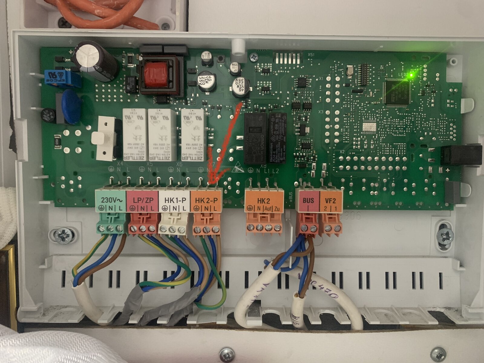

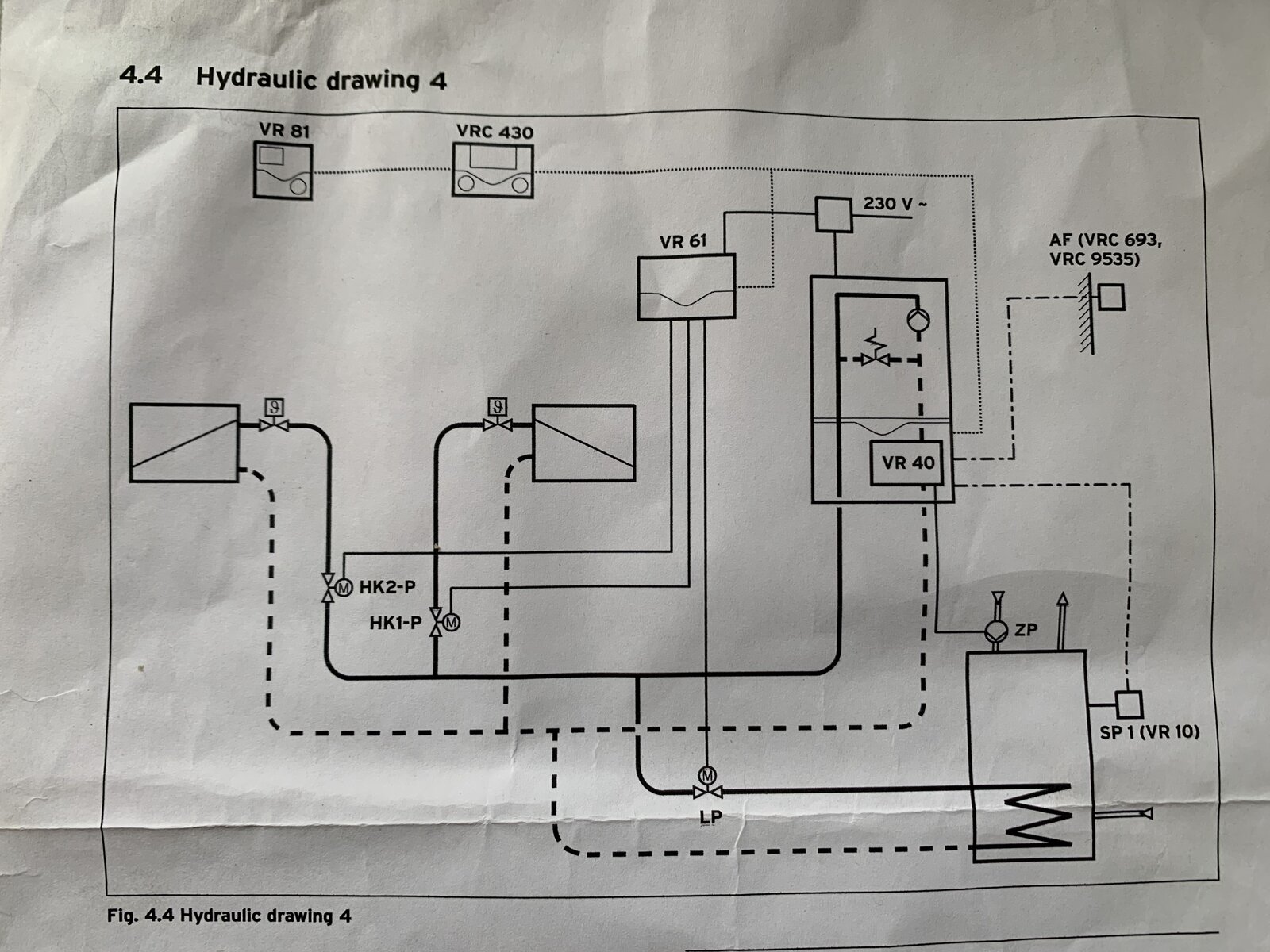

Below is the system diagram. There is no current on HK2-P terminal in the control unit which is connected to the valve and UFH pump.
Could this be a fault developed in the control unit (been faultless for over 8 years, and no one touched it until now) or something wrong with the settings?
DHW and Other heating circuit are working fine.
This is getting weird now - pump and valve suddenly came on today and right now all is working fine, though not sure for how long...
There are many possibilities- relay getting a bit lazy, microswitch likewise. Get yourself a multimeter, next time it plays up you need to be checking for voltage (live to earth and neutral to earth )- either start at controller and work forward or start at boiler and work back.
When its next in fault give those white relays a good thump with the handle of a screwdriver.
Initiate a demand for the UFH and listen for the microswitch to click.
Cancel the demand and listen for the MV to wind back under spring tension.
If there's a click you should then hear/see the pump come on.
You can even take the casing off the MV and manually latch it open and operate the microswitch with an insulated or non conductive tool/probe.
Don't electrocute yourself.
